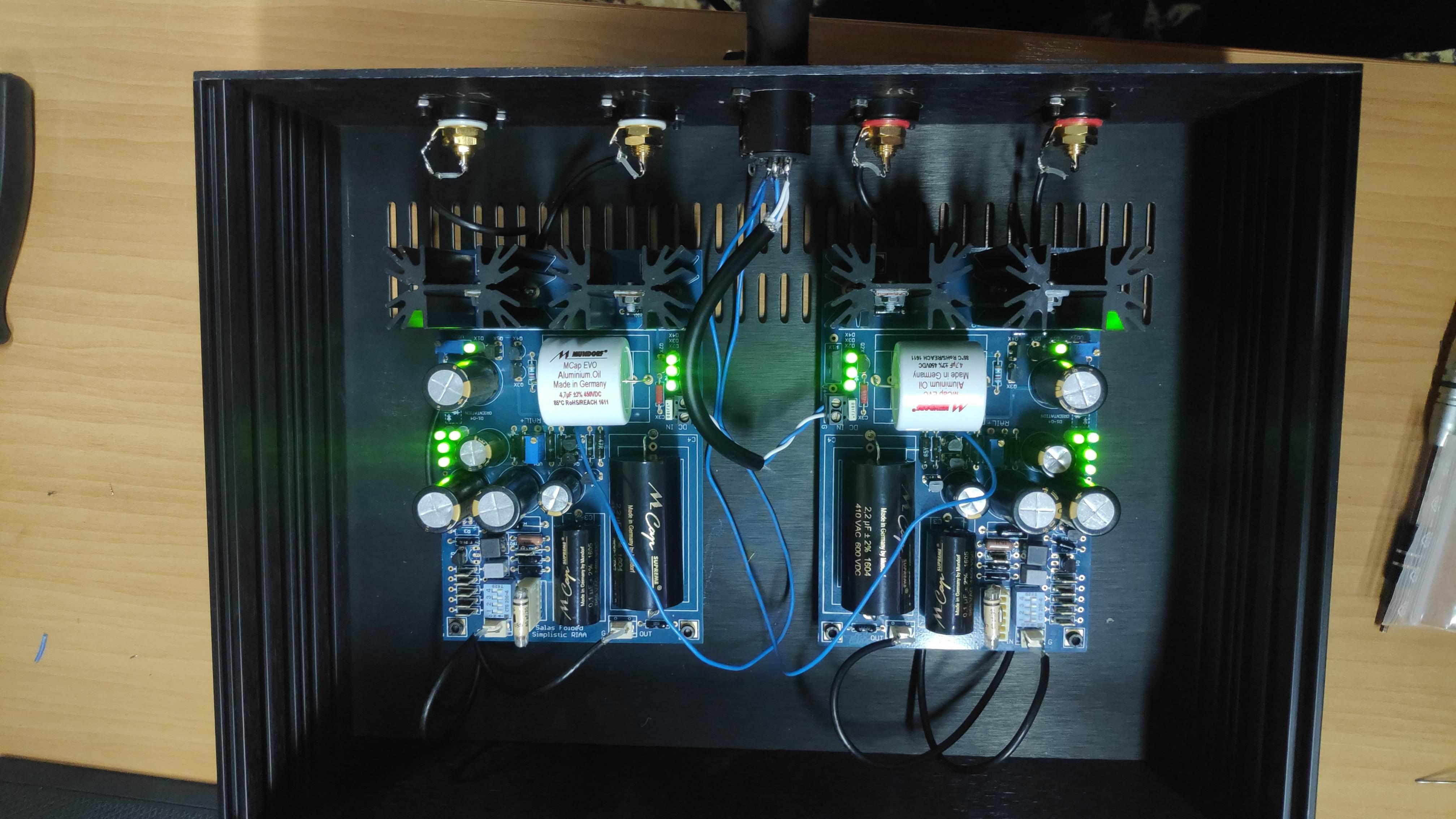

50VA Antek which is very much used by American builders has magnetic shield that their lesser VA models don't have is another reason why usually recommending 50VA
A Polish manufacturer of toroidal transformers offers shielded transformers starting from 20 VA. Which VA rating would be your primary choice for a pair of transformers (230V) for this project?

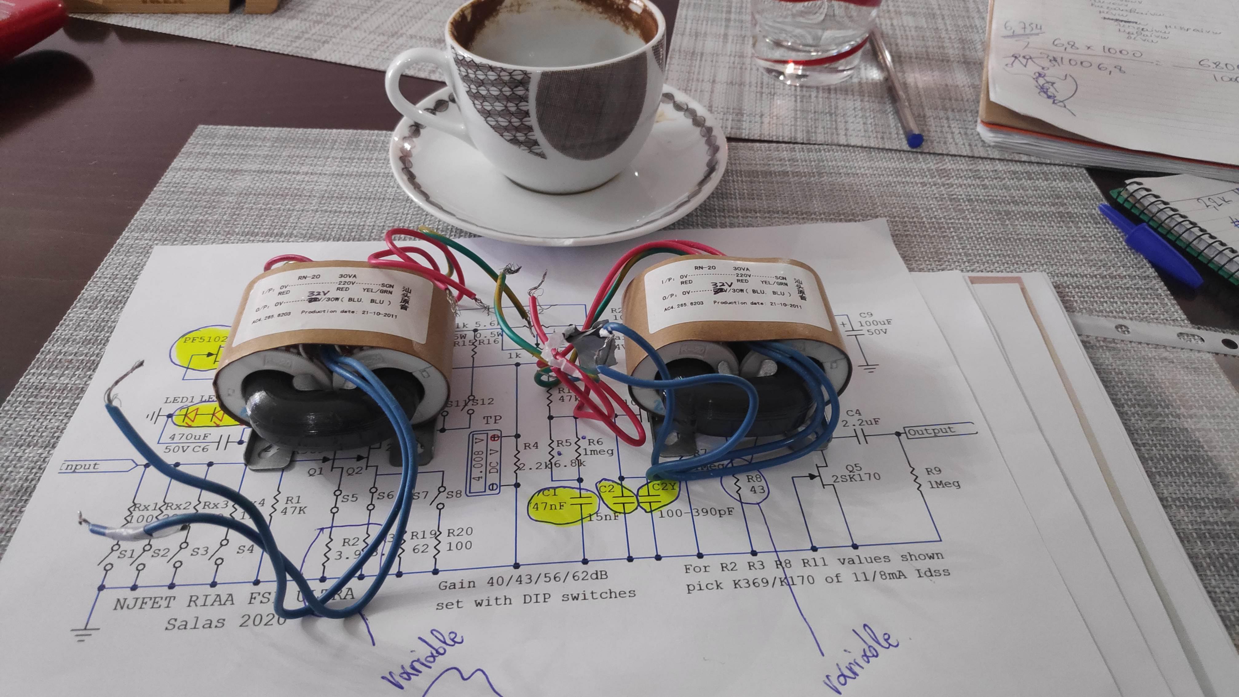

How do I wire the 32 V primaries of the 2 transformers to one IEC (230 V)?
Usually one of the primaries is tagged with a tape at the end (indicating the inner winding?).

32V can't be primaries but secondaries. Primaries should be 115V each. Depends on each brand. Could be connecting two tagged or specifically colored ones together and the side ones to the mains. But better look it up at the manufacturer's website.

The background of my question was if it is necessary to use 2 fuses with 2 transformers as suggested in this thread: Wiring up two trafos to one IEC socket.
Which slow blow fuse(s) should I use (230 V), 1.25 A?

Its not necessary to use individual primary fuses by electrical safety code. In case you want to, you should not skip a central fuse. In other words 2.5A in the IEC socket and 1.25A before each 50VA transformer for USA. Cut those figures to nearest 1/2 available amperage values for Europe and other 230V countries. All such fuses should be time lag (T) type. What we call slow blow.

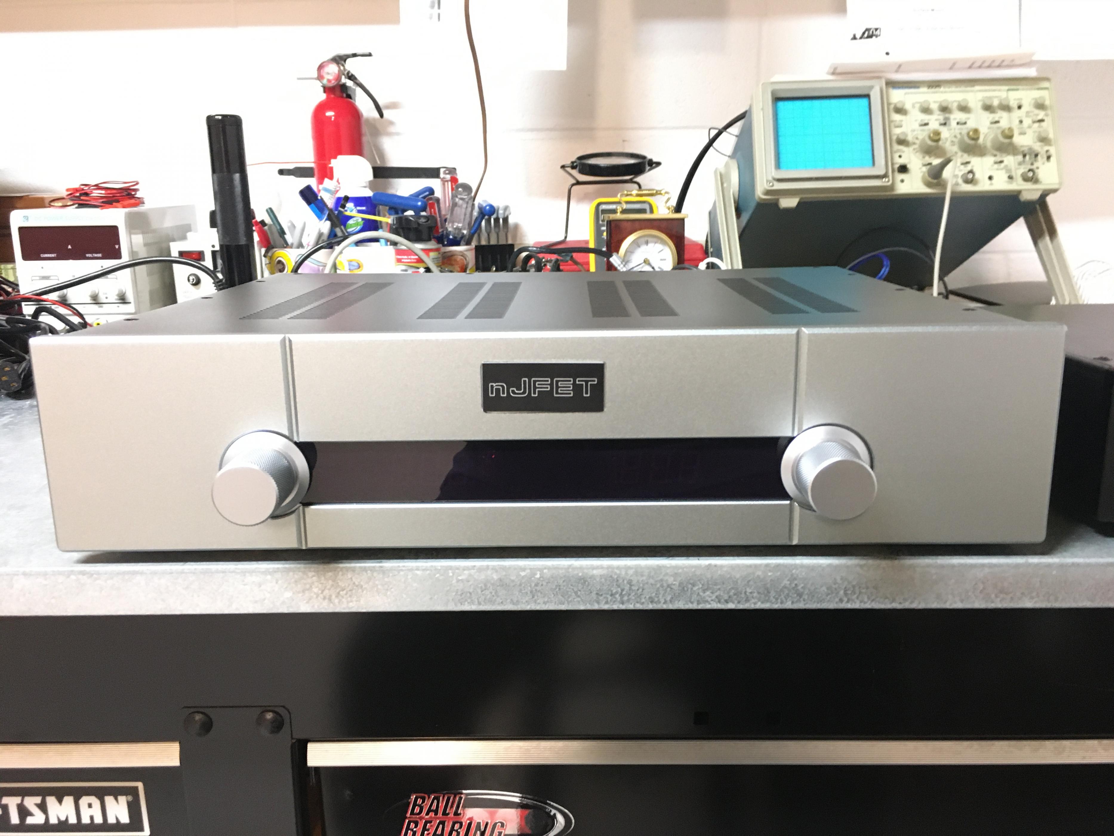

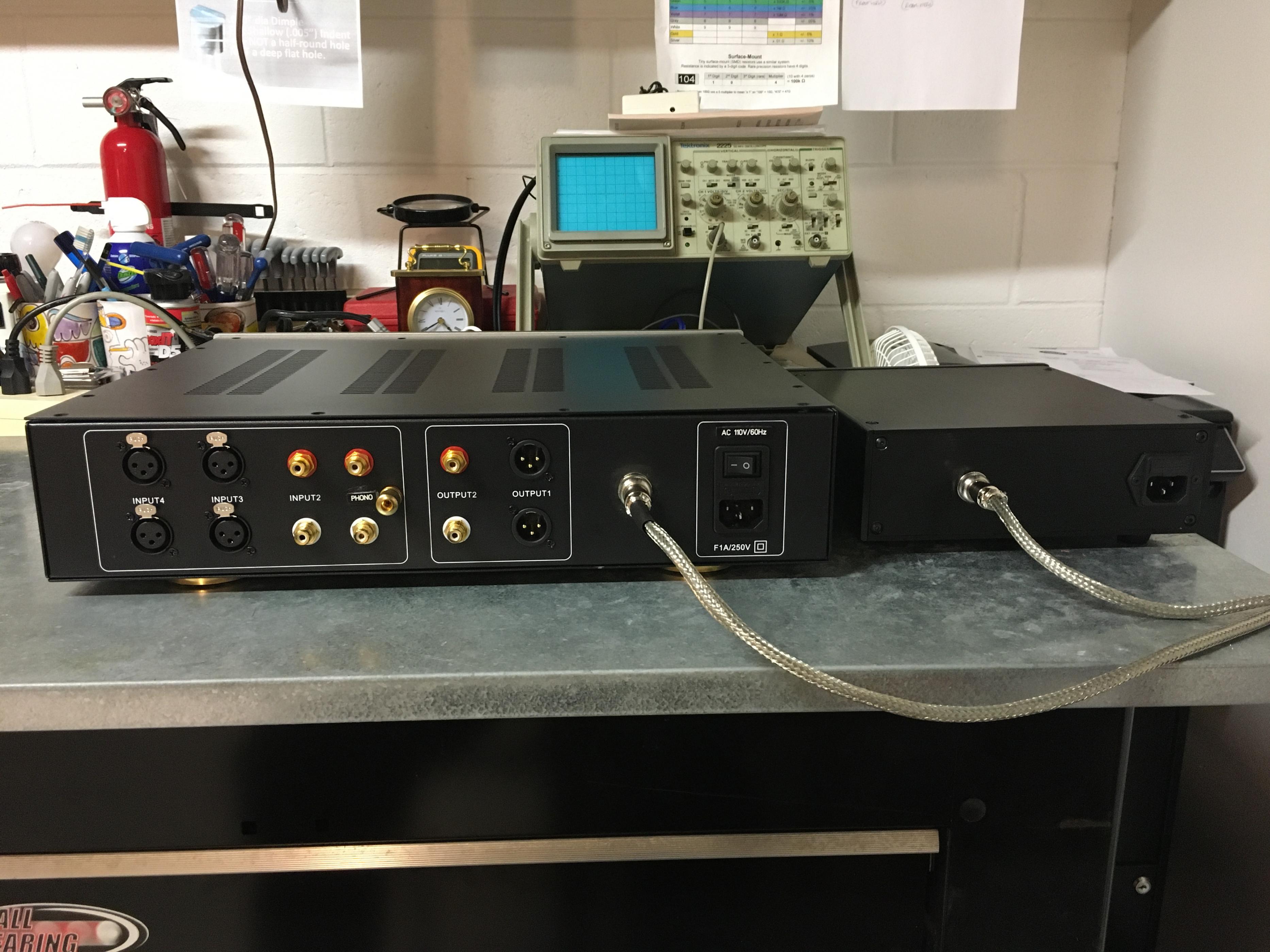

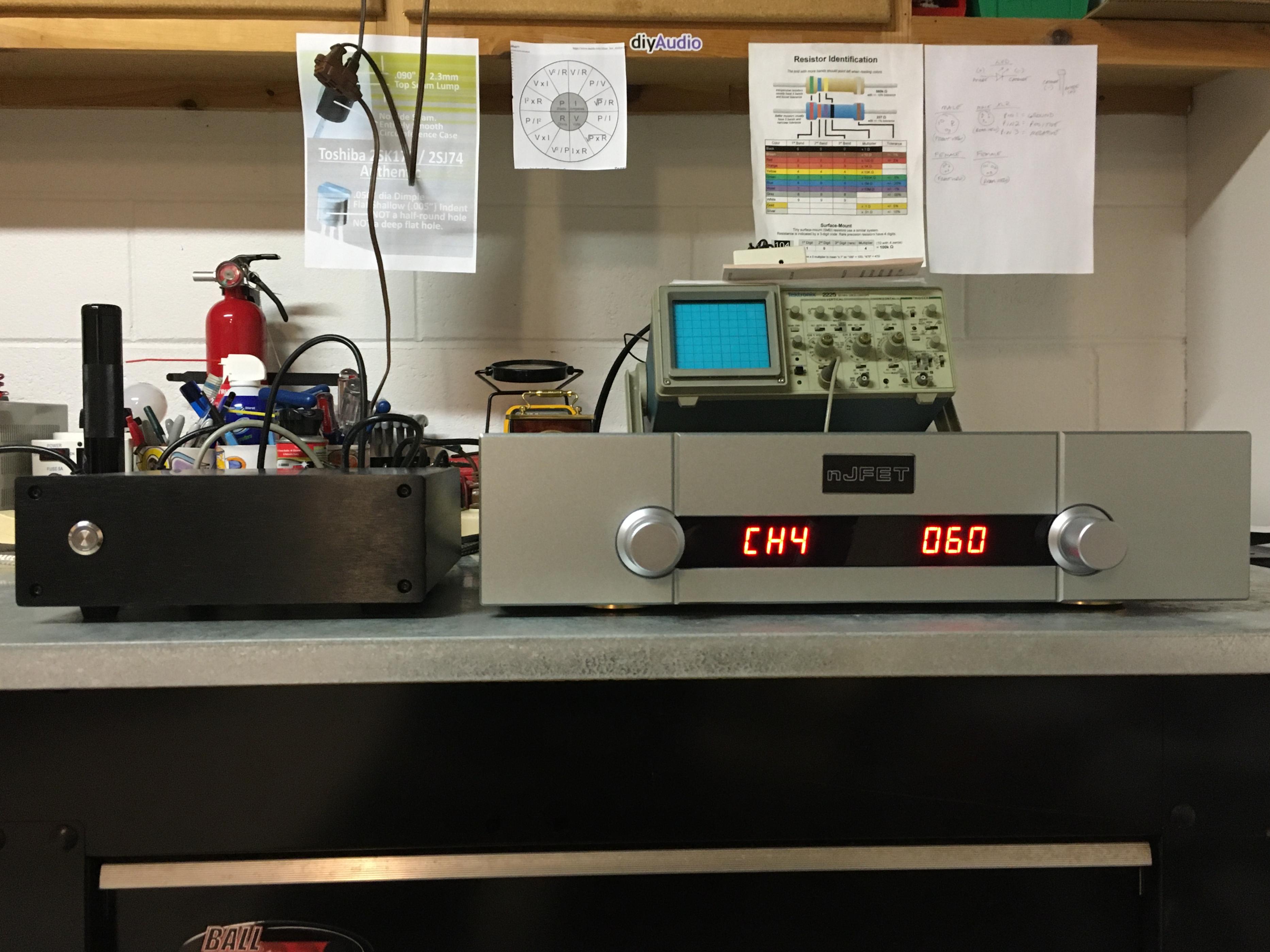

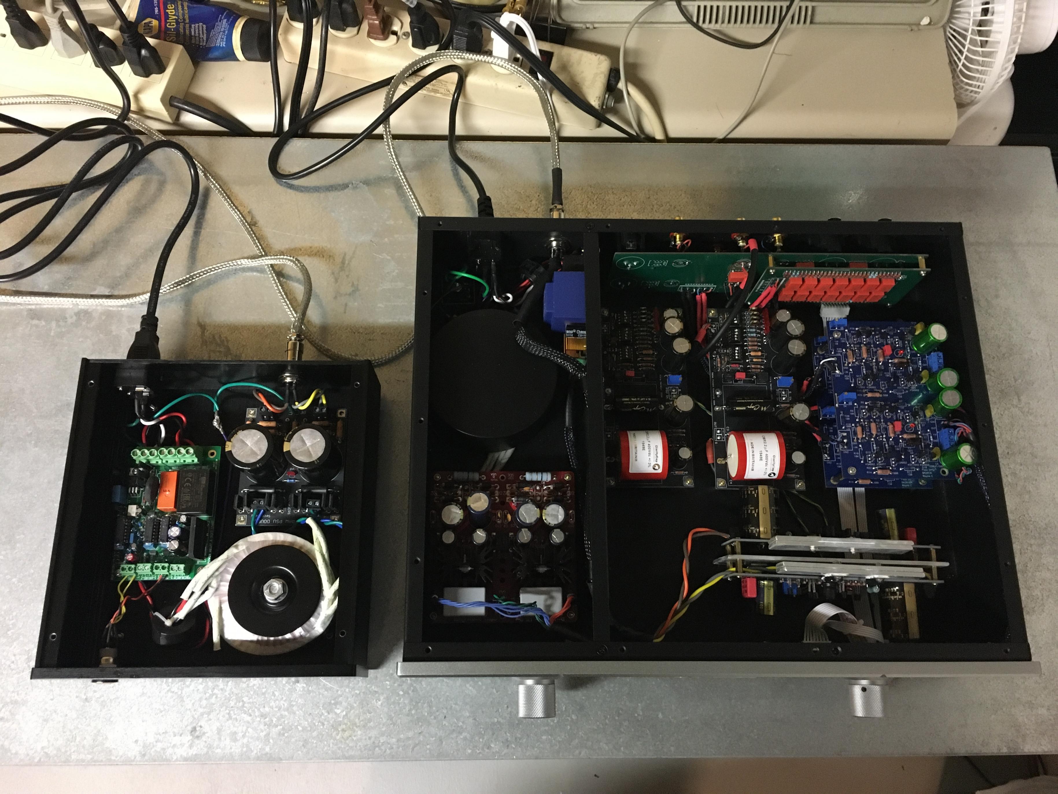

Hello Salas and Tea-Bag, I finished my preamp with BA2018 line stage boards stacked for Balanced operation with the UFSP with shunt regulators in the same chassis. The power supplies for the display/ relay input /volume control/remote, has a 250vac 30A relay to turn on the power supply for the BA2018 line stages.
The UFSP has a remote power supply with umbilical cord, the shunt regulators are mounted vertical with the home made heat sinks 10mm below the vents in the steel chassis. After 3 hours of operation, the inside of the enclosure stayed the same temperature. It is dead quite on all of the inputs, the UFSP I've adjusted and played HO MM, LO MC, HO MC. After a month of playing, time to move it into the main system.

Excellent integrated build. You are welcome & congratulations!
Superb build elwood625!!!!
