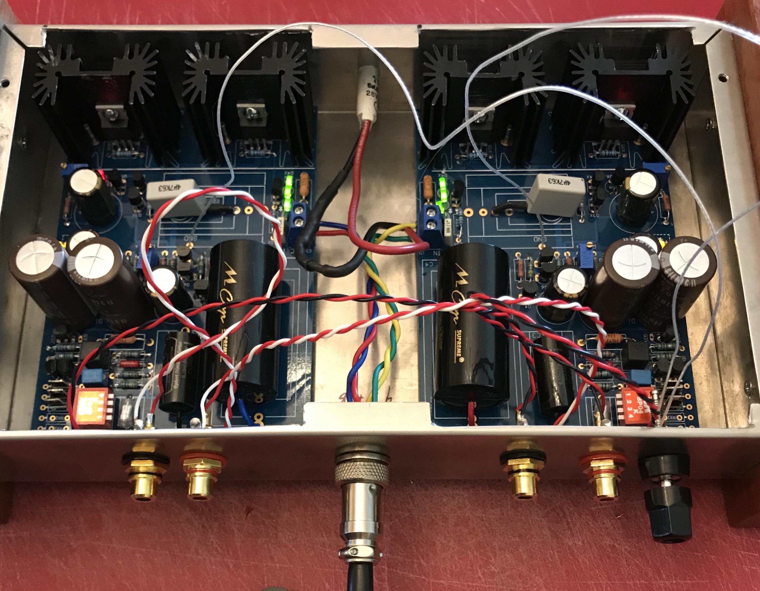

Welllll, it’s not exactly pretty, here in Tennessee, Salas. My input voltage is spot on 50.1V. Both channels right on. I went to check the rail voltage and it was an anemic 25v, but VR2 was set very low . I cranked it up, but only ever reached 31.5V on Board 1 and 32.9 on Board 2. Then the even more puzzling reading occurred. After dumbing Board 2 down to 1’s max level, my TP1-TP2 read B1=6 and B2=7.5!? I must admit I’m feeling a might discouraged. The only real observation I can contribute is that B1’s Q1X is as hot as Q6X. Not sure if that helps.
Don't be disappointed, because things finally started heading in the right direction.
Measure the voltage drops between R1x legs in each board first so we see if they pull expected CCS current levels.
Reset each VR1 to about half turns if they had been previously manipulated.
Add 1.5k in series with each R3x so the rail outputs can reach even higher with VR2x.
Or replace R3x with 11k Vishay MBA02040C1102FRP00 (Mouser no: 594-5063JD11K00FT).
I’m full of new developments and revelations. I had R3X at 6.2K for some reason and R6X is at 27. So when I figured that out and went to replace at 9.1, I could only locate one. So I went ahead and swapped out Board one’s R3X for the 9, and now the rail won’t dip down to 34V and TP1-2 is only going up to 2.2V. So, if I was a betting man, I’d think I should be aiming for an 8R5K or some such like it. Should I also procure a 22R for R6X? For some reason my choices were 27R or 33R. I have a feeling that to hit the 3.6V target I’m going to have to dip below the 34V mark at the rail as it stands now. Thanks
IR drop at R1X on Both boards is 1.54V
R6x's value isn't a consideration for the setting of the regs. Its about how many mA run through Q2x and the three LEDS it drives. To keep that JFET not too cold not too hot. As it is exposed to high voltage drop and samples IDSS differs we use R6x to control Q2x's dissipation for long term reliability. Measure how many mV are dropped across each R6x and I will let you know if to change anything.
If you piggyback a 100k resistor on the 9.1k (R3x) they make 8.34k. Try that. VR1 adjustment could also help reach your T.P. goal when near.
IR drop 1.54V on both R1x is an excellent reading because we are aiming at 100mA in this design. The Q1x MOSFET and the three LEDS have Vgs & Vf sample tolerances so when ending up with +/- 10% current setting results is good. 1.54V across 15 Ohm R1x means 102mA CCS for both regs. Spot on and matched between channels in your case.
I replaced R3X with an 8R5K set the variable resisters to half and gave it power. Had to roll up just a little bit to get to 35v rail on both channels. TP1-TP2 both came in at 2.4ish, further downward adjustments got both channels to 3.6 easily and, well, easily. I’m right now watching it sit for a half hour to give some final tweaks to hit 3.6 for good. Out of curiosity I checked DC at the outputs, and both sides were dead on 3.4mV, so I’m thinking that that’s a good sign. After It idles for a while and gets a final biasing, is it time to hook up?! Thank you for the coaching, Hoss. It’s pretty awesome that you not only designed this amp, but you’re willing to talk amateurs like me through the finer points. It takes patience and a good bit of kindness, and you have my respect. I’ll let you know how it sounds if that’s where we’re at...

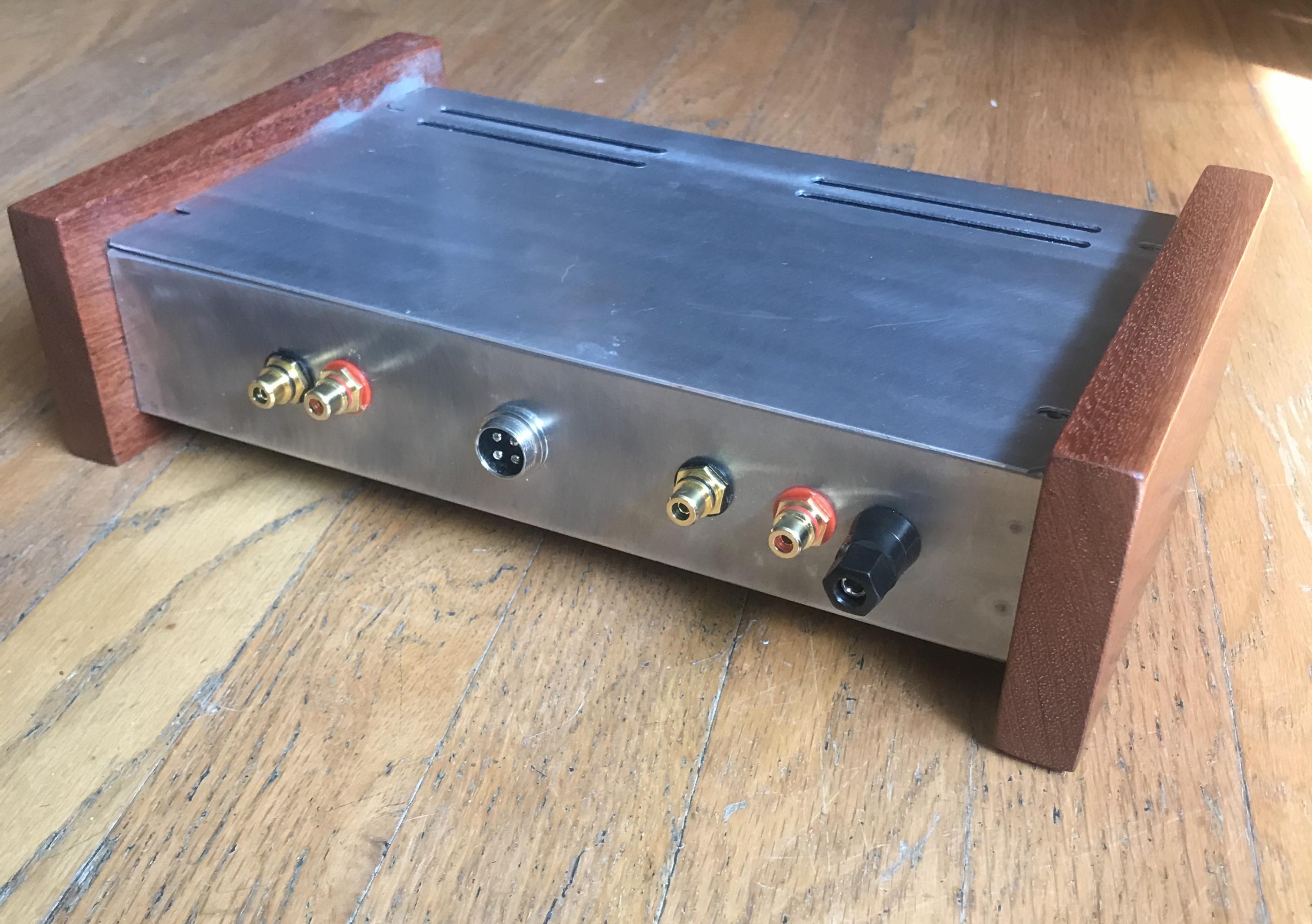

Now's time to hook it up because the good electrical signs suggest so. You could have used shorter and shielded signal cables but you will judge that later regarding some buzz noise presence or not. Are those nice sinks Ohmite brand by the way?
Yessir there may still be mods to do. I wouldn’t have thought there would be buzz with only rectified DC present in the amp unit. Well, at least I’ll know where to start if I get some. As far as the sinks, not sure what brand they are, but thanks, I suppose they are pretty nice. I just noticed the picture cut out all my hard work I did to gussy up my chassis. Here’s one more pick, just for the sake of vanity.

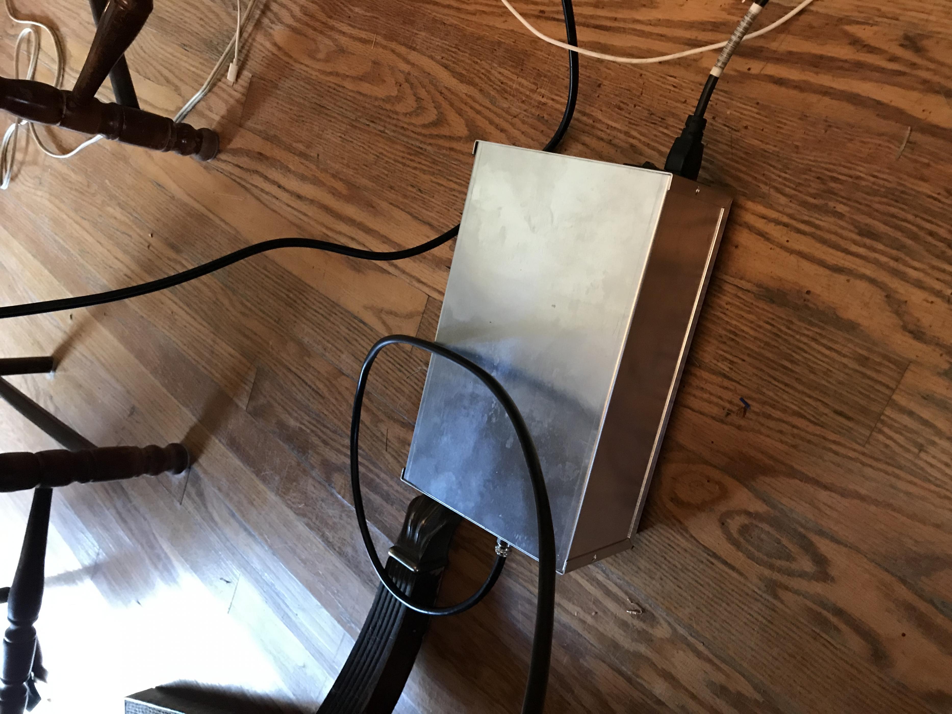

It’s taken a few months, and I’ve traded out some parts, but this amp makes quality music. First off, no noise at all until I’m a notch past ridiculous, unlistenable levels; I thought I had pretty good components, now I know what the noisy link was. Right away the stereo imaging is wider and especially deeper, and there’s a ton of detail. I’m keeping in mind that it’s only in it’s first hour of operation, and there’s a whole device worth of components that have to burn in for fifty or so hours, but at this starting point it sounds better than the Parasound Z-Phono I was using. Started with the Flaming Lips, Transmissions... and that was a lot to throw at a new amp, it was a might bit muddy, but that should clear up real good soon. Now it’s Gillian and David’s album The Harrow And The Harvest, and it’s clear that we have a winner. If you can convey the tone of the clawhammer banjo, something or two is working in favor.
