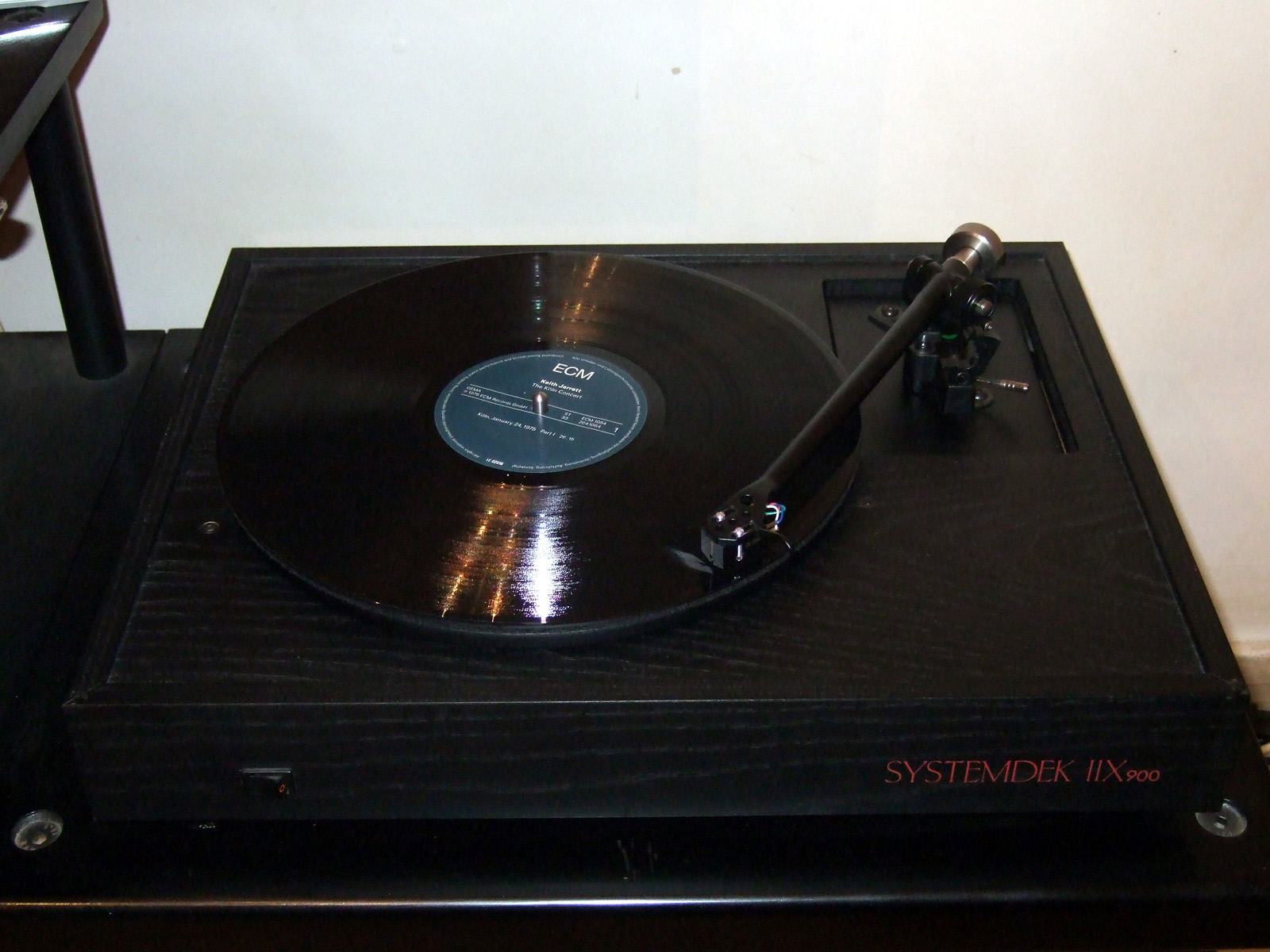

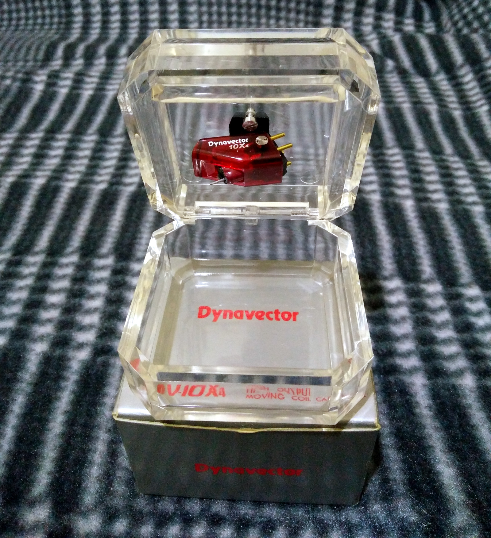

Hi
I have an older Dyna 10X4 mk.II model that I tried on a Systemdek IIX 900 with a Rega arm and it played very nicely. Certainly different but not a let down when switching from the DL-103R. The ZYX Bloom was above both though. I suggest that you should follow the 43dB gain configuration values for HOMC as described in the guide.

Hi Salas,
I too had a 10x4 a few years ago which I traded in for the 10x5 and I recall that the 10x4 sounded better to me. The 10x5 always sounded a little softer as though it had a slightly rolled off treble.
Anyways I am just curious how it would sound using your pre-pre between it and a mm phono stage (nad). Maybe it would open up the sound a bit more.

Roy, better use 47K Z-Foil R1 and no other Rx load options so the 10x5 will sound at its most open in the highs. Use Z-Foil for R14 too if the budget permits.Hi Salas,
