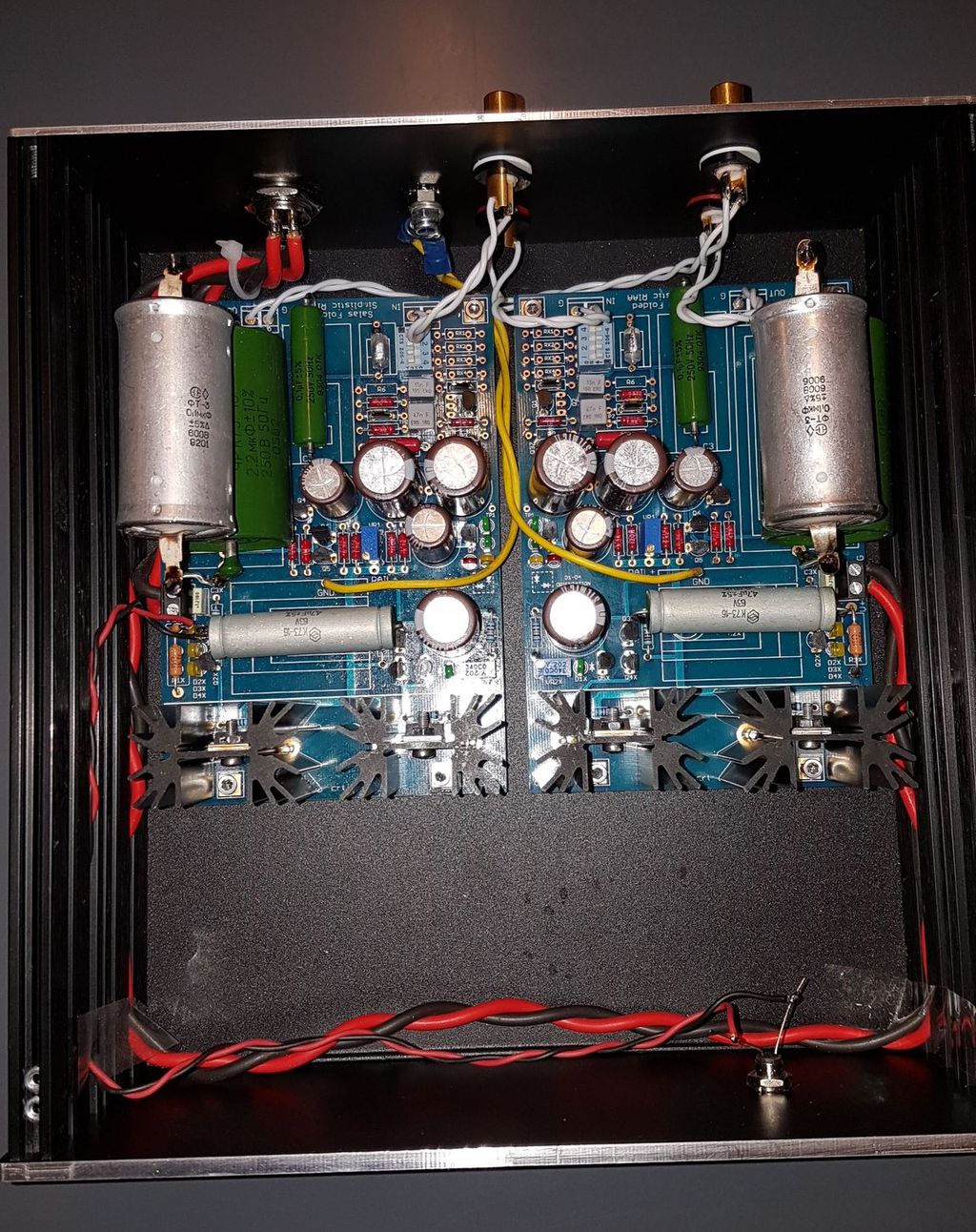

I have resolved my problem in post #16498 by changing Q3z.I get :
Vp1-Vp2: 3,57/3,57 V. I can't obtain 3,6V with one channel but i am very near.
Vrail: 33,67/33,93
V+: 43,46/44,48
I have only one Q6x hot. Is it normal ?

Hi, your build looks very nice. Congratulations. Regarding heat evenness, in this way pcbs are arranged in the box, the two middle ones must feel alike between them and the two outer ones must feel alike between them. If not, measure Vgs (gate to source voltage) and compare between same numbered Mosfets per channel. Let us know those results.
