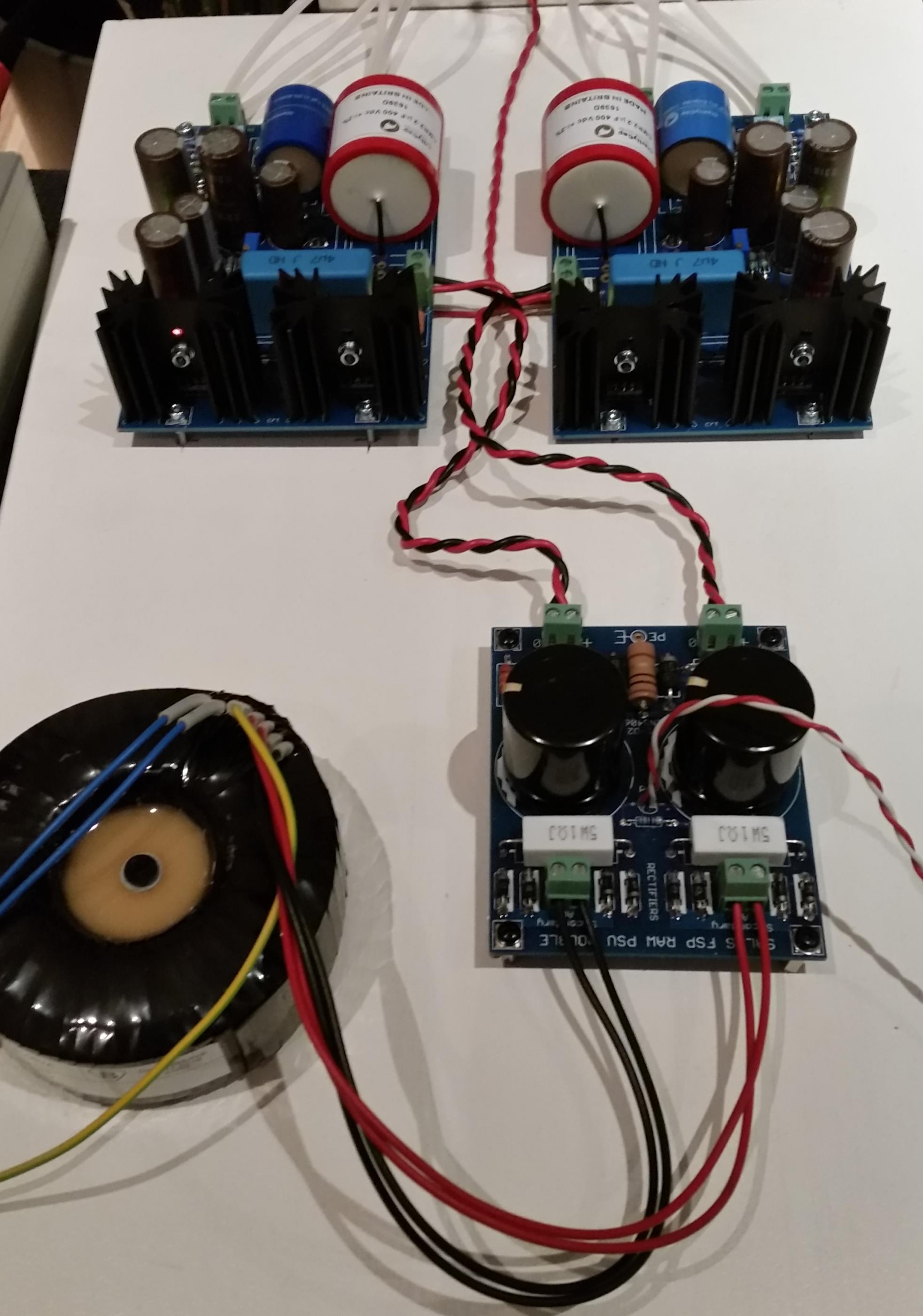

Here´s another MM riaa that delivers sweet music🙂 Soon i will place it in a nice chassis. Thank´s Salas and Teabag:up:
I have one more kit. Maybe i will make one for MC!?
