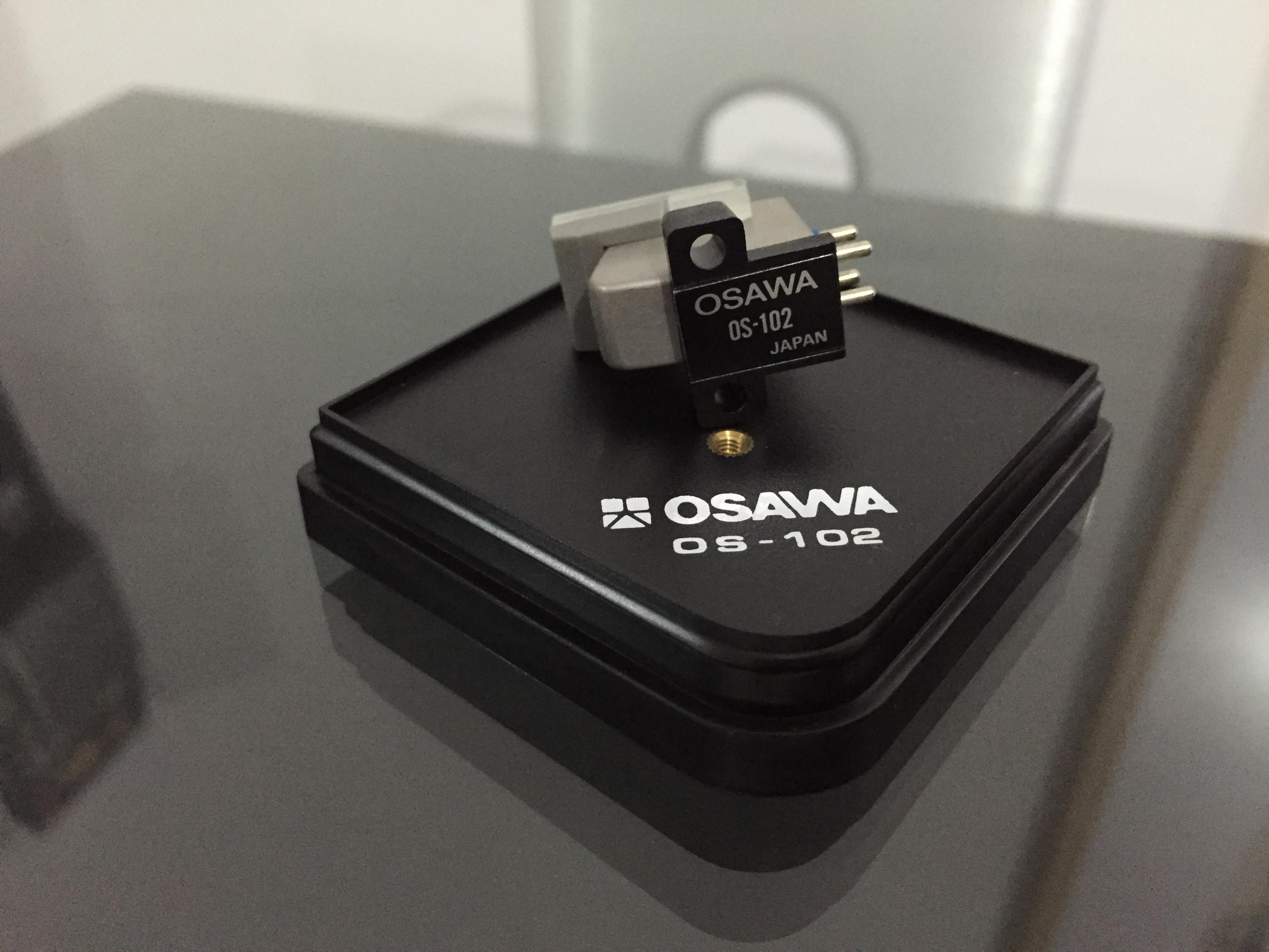

I have also an MC cart with 2mV output, If i fit this one do I need to change the Gain set-up again i.e. add transistors, change resistor values etc. or is it simply flipping those dip switches?
Optimal would be the 43dB high MC mode build but in the 40dB MM now the 2mV is still playable especially if there is some gain in the line level preamp
