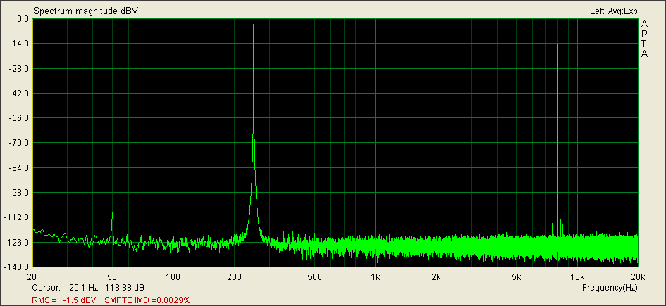

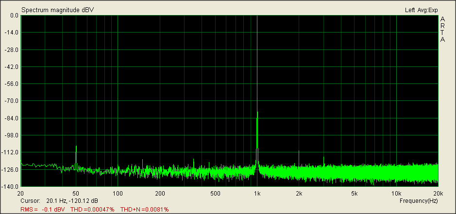

Talking about measurements here are samples from the non solicited and initially oscillating general purpose matrix board quick layout of my friend that I left him do what he may on purpose so to check how it stands in the building hands of others when having no learned info about how it works and no CAD boards. It took me only an hour to debug it for him.
Are the 250Hz and 8kHz a pair of intermodulation test signals and the grass is the distortions plus a bit of mains.
Those are the normal operating 1kHz 2.83V pk-pk output THD % and 250Hz 8kHz IMD SMPTE % charts of that build. IMD SMPTE is kind of acid test on how clean an amp will be in complex music replay. When a big low frequency signal exists along a high frequency signal and those small spikes around the base of the high frequency signal show how much the bass one it can modulate it. If a drum or bass guitar plays along with a flute how much the drum will make the flute waver for instance. A bit of 50Hz mains spike possibly from those many unshielded EI transformers or it could have had better wiring. But the small spikes around 8k are the 250Hz modulation and its harmonic. The oscillations were typical wiring and compensation matters that got easily fixed using the scope before the FFTs were done.
P.S. In #16139 you could also see how an IMD SMPTE test looks on the scope. The low frequency sinewave has the high frequency zig zag riding on it.
