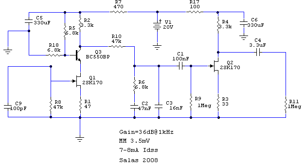

With MM the tip mass is higher, and the compliance higher normally, so other things usually mask it from prominence. Since your cartridge is MM with 200-400pF recommended load, I would urge you to avoid the above versions that produce 300-400pF Miller. Think that your cable may be 100-150 or 200pF additionally. Make the MM cascode version that I attach, with suitable gain, suitable overload margin, and very low Cinput. You may not attach at all the 100pF typically shown and start listening with just your cable capacitance, adding some Siver Mica for comparison. I have concluded that is the best sequence with MM. Or simulate what its inductance does with 47k and measure your cable pF to add. Then you know what you will need. You will not want to drive anything less than 30K line input or add a JFET buffer (better avoid if over 30k).

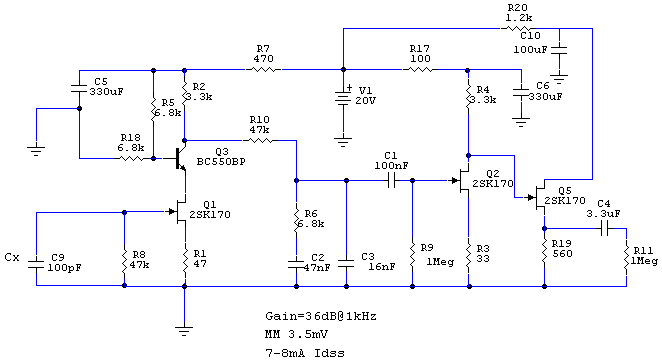

OK then. Here is your buffered version. From MM cartridge to line in. Can deliver up to 10mA to load. Lowest recommended is 20k with Cout 3.3uF. Make it 6.8uF for 10k load.
P.S. Don't drive an MM stage with 200-300mV that my 36dB stage and your cartridge will do. Sounds terrific for the little effort. A no brainer.😉

You will need 61dB for 0.2mV MC, 55db for 0.5mV MC, 40dB for 2-2.5mV high output MC like Denon 110-160 or Benz Micro MC Silver or Benz Ace Blue, 36dB cascode for 3.5mV MM.
All the versions are covered in the thread, and all are capable of driving a line stage. I recommend to avoid the extra buffer stage if the line input load has impedance (Z) over 10X the 2nd JFET's Drain resistor. Keep it simple.
Of course if it is made for a 3rd party, then the buffer is adequate since you will not always know with what is going to be connected, or future changes. The 2 stages sound great if the output is under 300mV and the load right. The added buffer will cloud it just a wee bit, but it will save the day by keeping the distortion very low and the drive strong in any adverse situation.

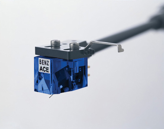

Hi Salas
I followed this link http://www.diyaudio.com/forums/showthread.php?postid=1628754#post1628754
and found your wonderfull work.
I will implement this with a PSU using superregs instead of batteries !
What should be the minimun voltage to feed your design ?
I am using a Benz ACE Medium output (Clear body)... should I make some adjustments or your design is good for this cart?
Please be pacient with me (I am no electronics wizz)... but in time I will surelly build this RIAA stage.
Best regards
Ricardo
