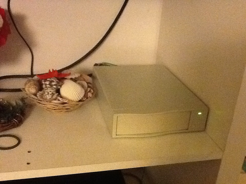

and something on thread, simplistic riaa. simply said - the best sounding solution i ever had. sound is rich, forgiving low quality records, good ones sounding fabulous. tomorrow i will give it to a friend with extremely good setup for few days listenig tests.
anyway, lots of thanks to mr. Salas for his research and all of other participants for their output.
my preamp recieved housing from old usb cd-recorder, annoying colour, but as soon as weather gets warmer it will receive some black clothes
