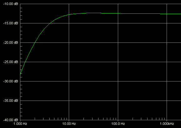

Hi Salas
I believe I do not need the 101b internal Riaa circuit.
So my idea is to replace the 101b internal head amp + riaa eq modules by a modded board based on a meridianMC module I bought in the net (Worst riaa amp module I ever heard) that I itend to use as a signal bypass wire.
I will remove all the components of the MC board , and use shunts between the in/out golden sockets.
This will enable me to use the CDP in the (TAPE) in and the new Riaa in the phono input as actually they share the same input😀
My main issue is the salas riaa impedance matching... what should be the minimum ohm value in the 101b input ?

RCruz said:Hi Salas
Ricardo
Yours has a buffer, but I would not stress it if I had a choice. Say not lower than 22k. Of course it can do much lower (I have a friend he uses it with 15uF output capacitors after the buffer stage on a 4K7 pot preamp). But I don't think that it helps the sound to go that low anyway.
The TAPE in has a series 10k resistor before a 10k vol pot, followed by a 10k balance pot, before the opamp and sounds very good.
If I choose the phono (modded), I do not have the 10k resistor in series but I have an (impossible to remove) 470k to GND.
As I already have one 470k to GND in the Riaa, what can I expect from the additional value inside the 101 ?
Ricardo
Ricardo
From what I see on this Meridian 101 schematic, you get 20K total through tape ''play'' input. The Meridian module sees a 470k so to refer its output capacitor to ground locally, as we do in our Riaa with 1M. That gives 9.79k load to the Meridian module when ''phono'' is selected and goes directly to its volume pot (10k). If you use your new Riaa with 470k on its output // 470k on the Meridian to its vol pot, then 9.59k it will see. Can drive. I don't know if your output caps on the new Riaa will lose some bass or not. What is their value? 2u2 if I remember correctly?

Just did it.
While burning, I can report that it plays a little lowder and with some added bass.... Later I will post some pics.
Ricardo

I am wondering if the space left from removing the MM Riaa will enable me to place a Burson V2 discrete opamp there... I know these do not need any output cap.
I did not give up my preamp project but I already spent a lot in building two pedja buffers with dedicated high spec +-15v psu that I did not finish
I must study the case intensely before moving on.
Actually I am amazed with the quality sound I am hearing in this new setup. (Maybe the 10k serial resistor was closing the sound a bit)
