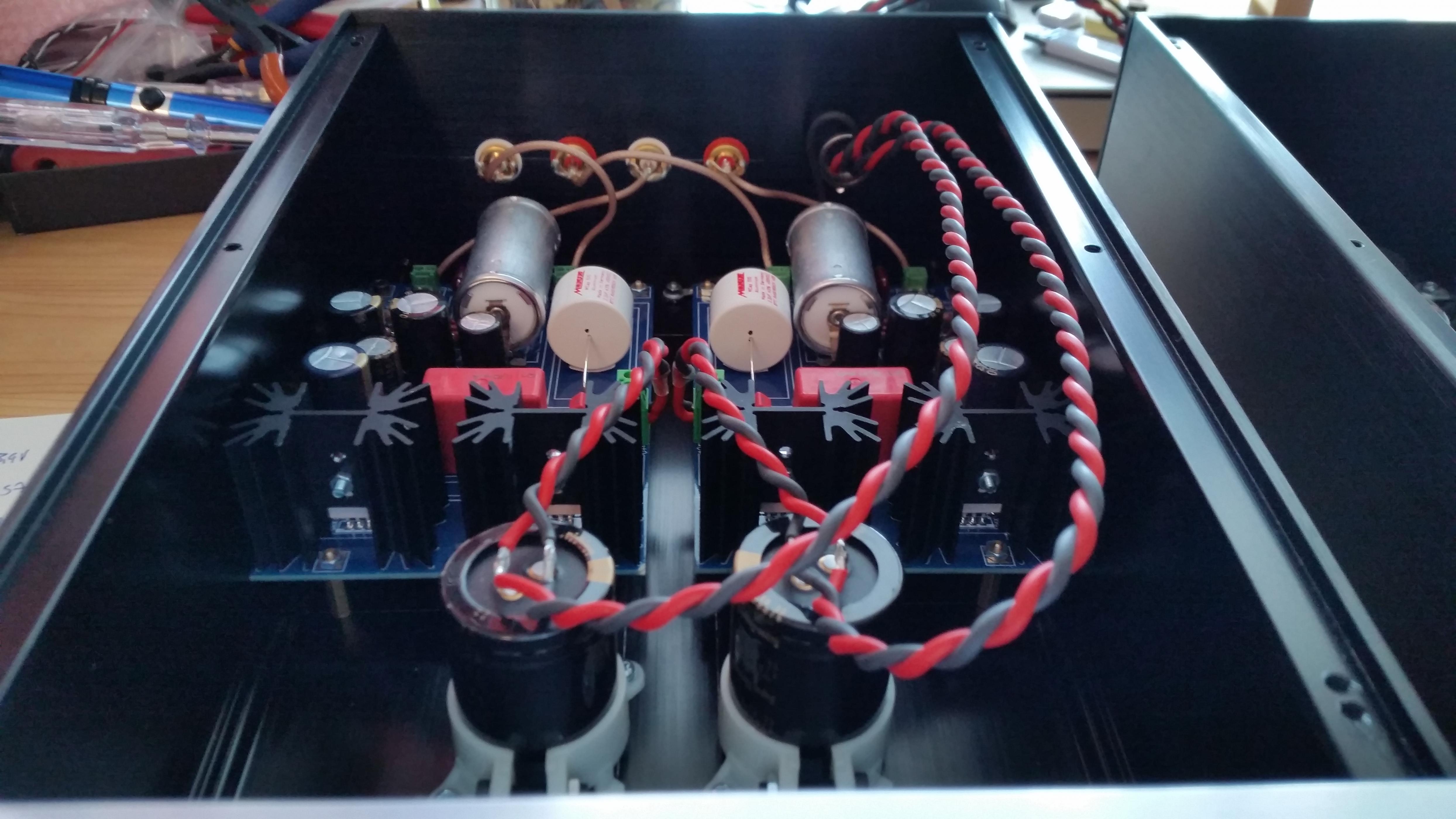

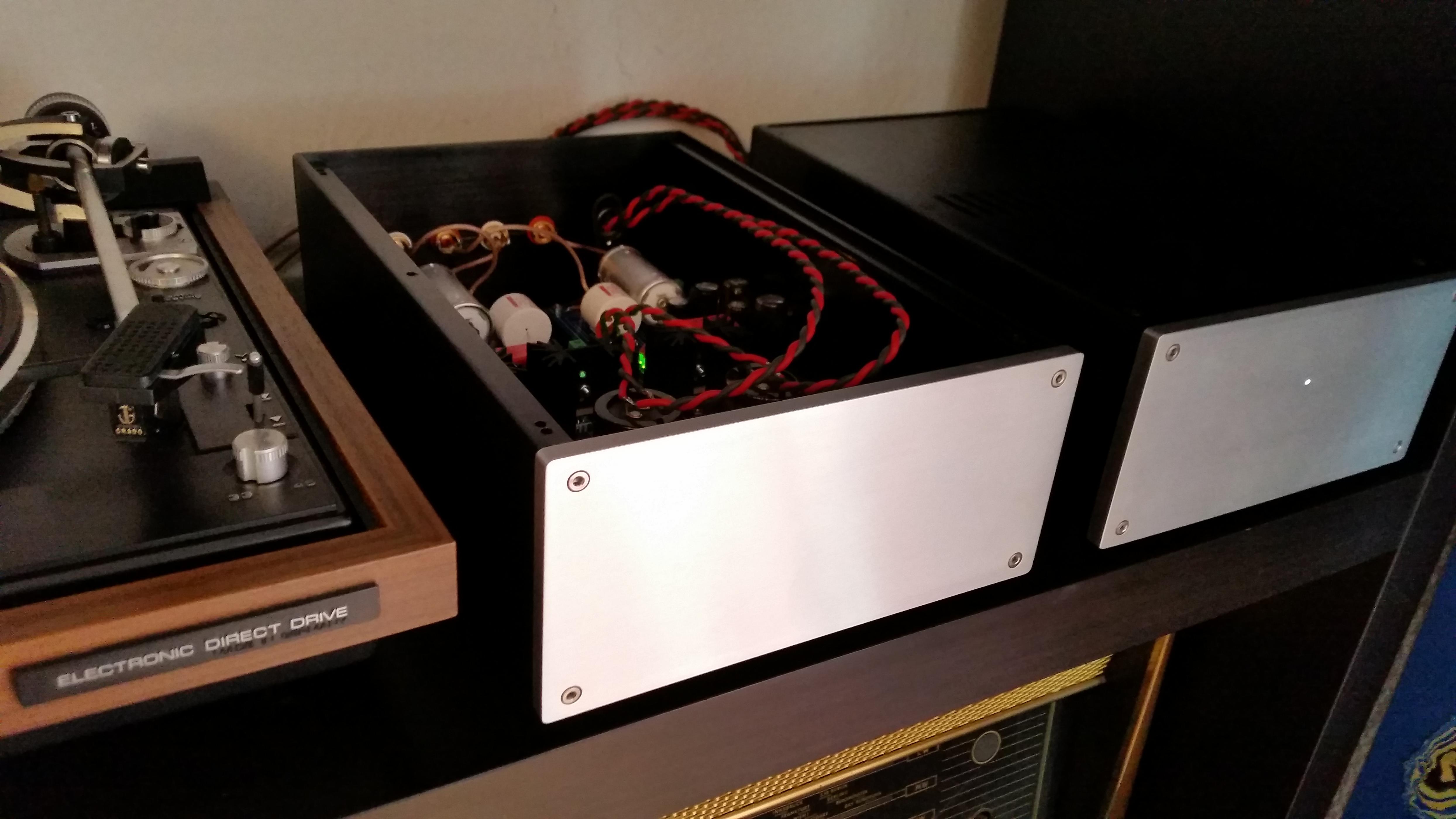

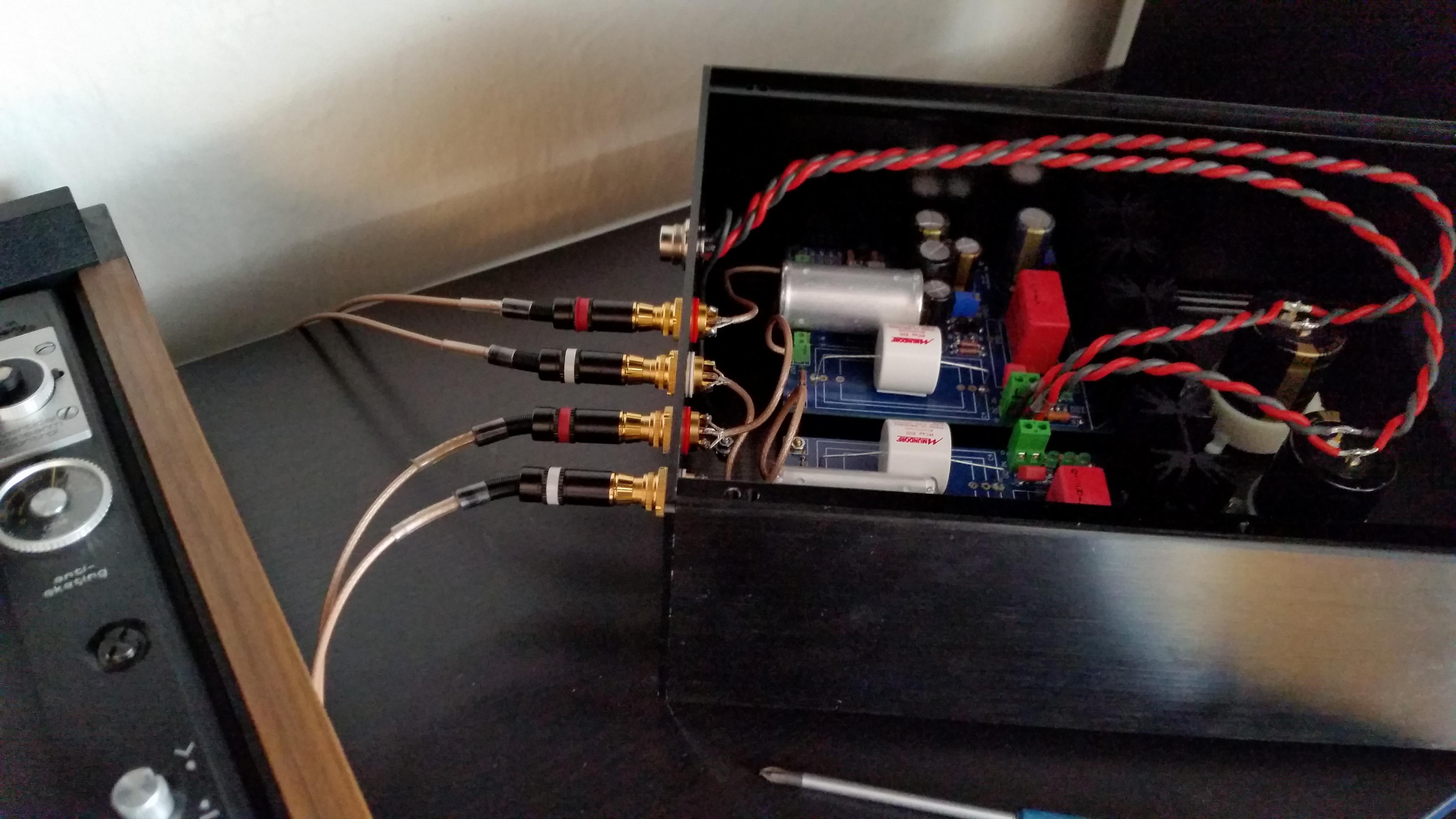

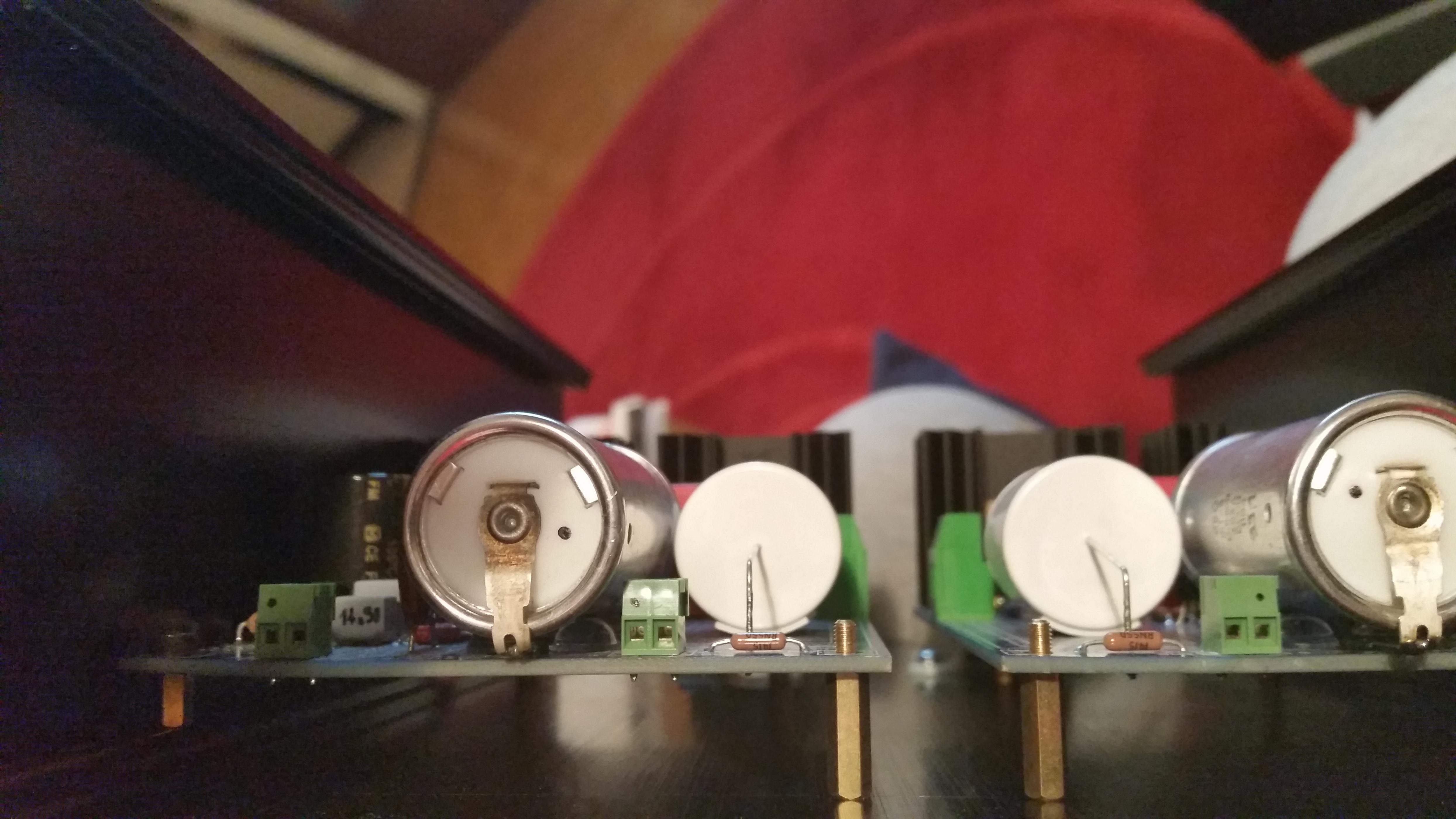

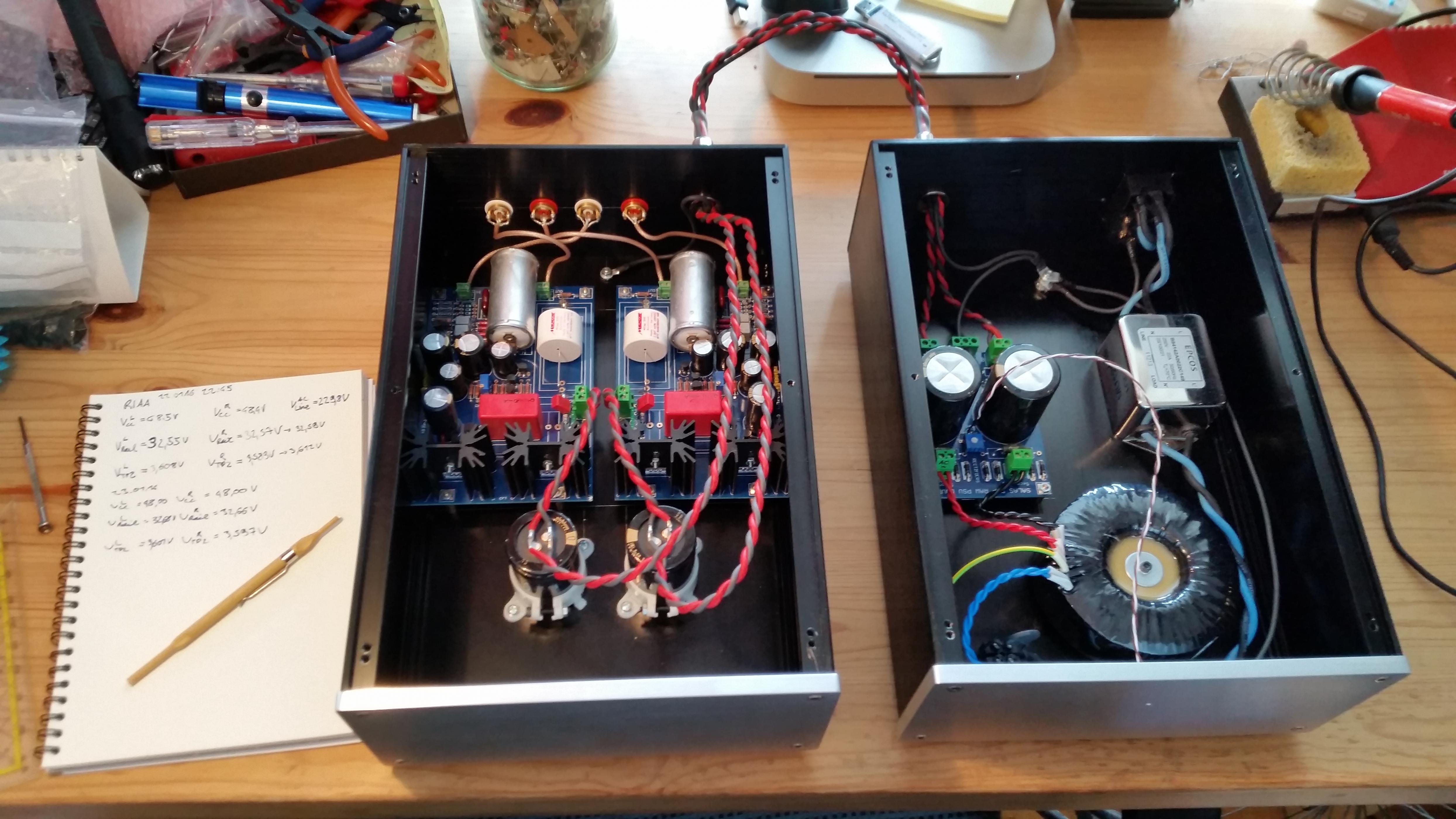

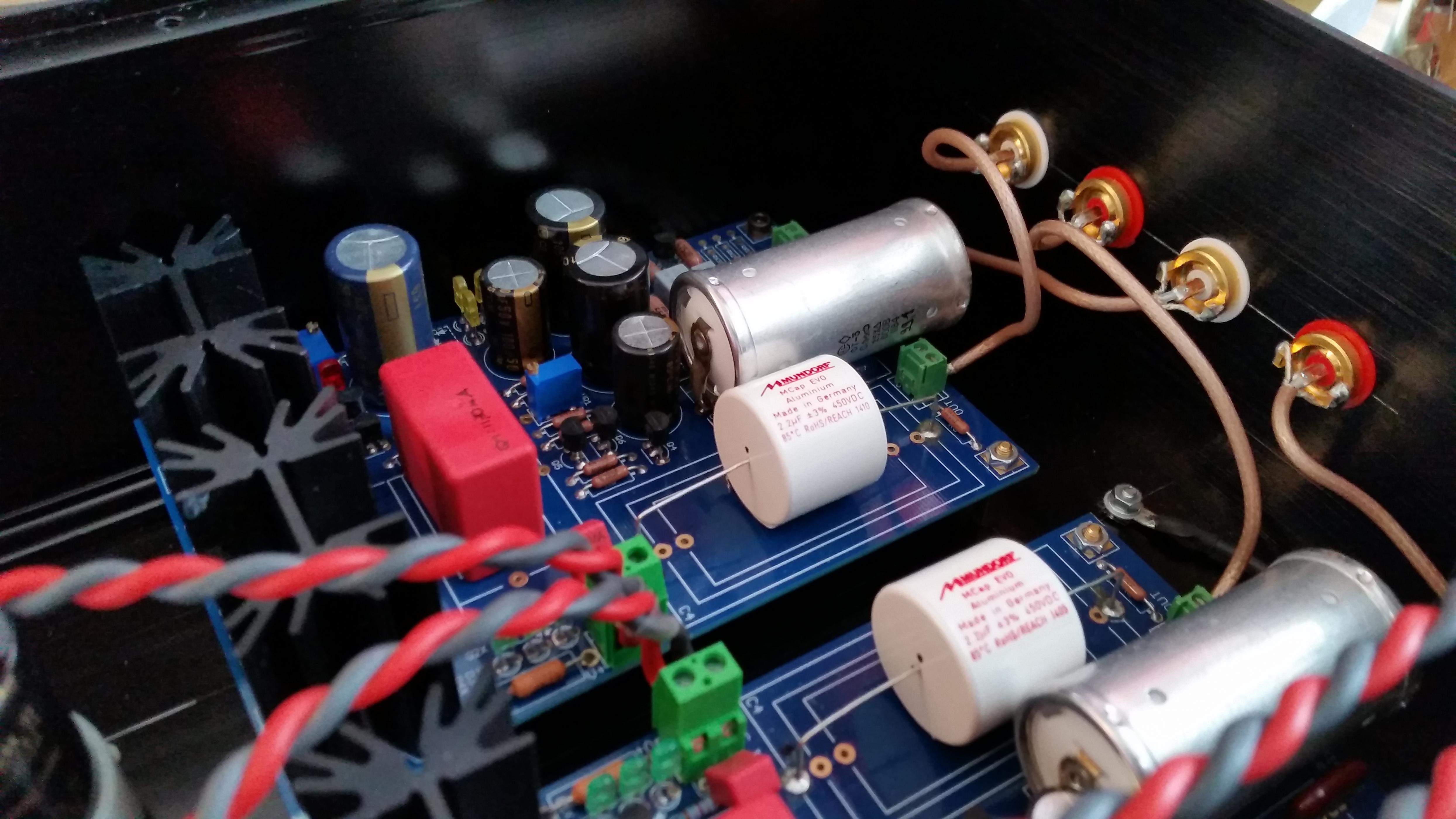

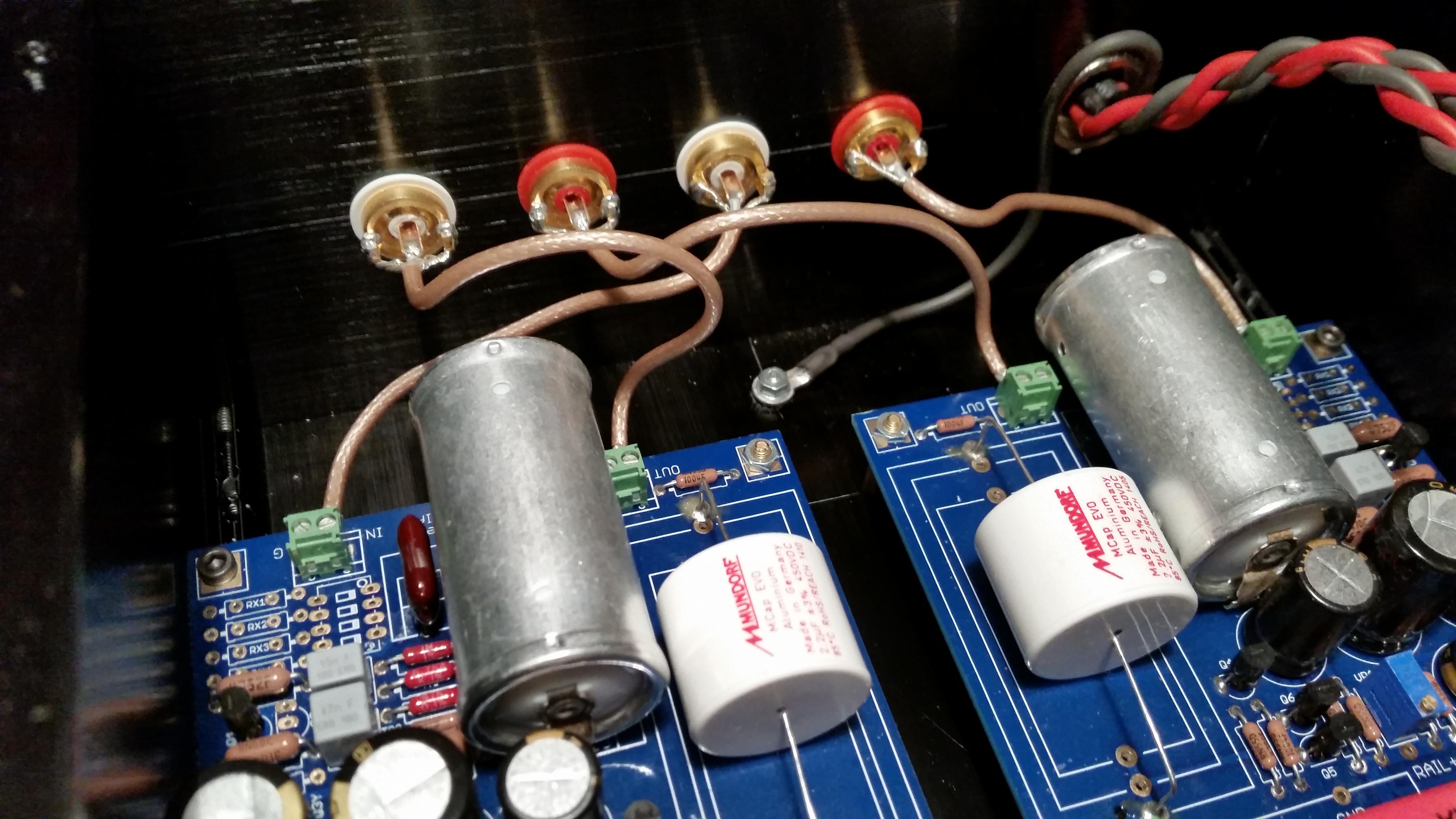

I finally finished putting my FSP build with pcbs from the Group Buy into an enclosure (two actually), only took about ten times as long as putting together the circuit itself 😛 The build turned out quite alright, no noise, no hum, couldn't be happier.
I've used Vishay Dale RN and PRP resistors, Panasonic FM and Nichicon Muse electrolytic caps, Mundorf MCap EVO (output) and Russian FT-3 (interstage) coupling caps in the circuit, and Nichicon KG Super Through caps in the PSU. Per channel, the power supply has 4700uF in the PSU enclosure and 4700uF in the amplifier enclosure, for a total of about 10000uF per channel.
When I last measured, the supply voltage of the raw supply was 48.00V/48.00V L/R (with ripple voltage in the 20mV region, checked with a scope), the rail voltage settled at 32.55V/32.57V and the TP2-voltage was at 3.601V/3.597V. I set the voltages with VR2x alone, while VR1 remained in the middle position. Looks alright, I think.

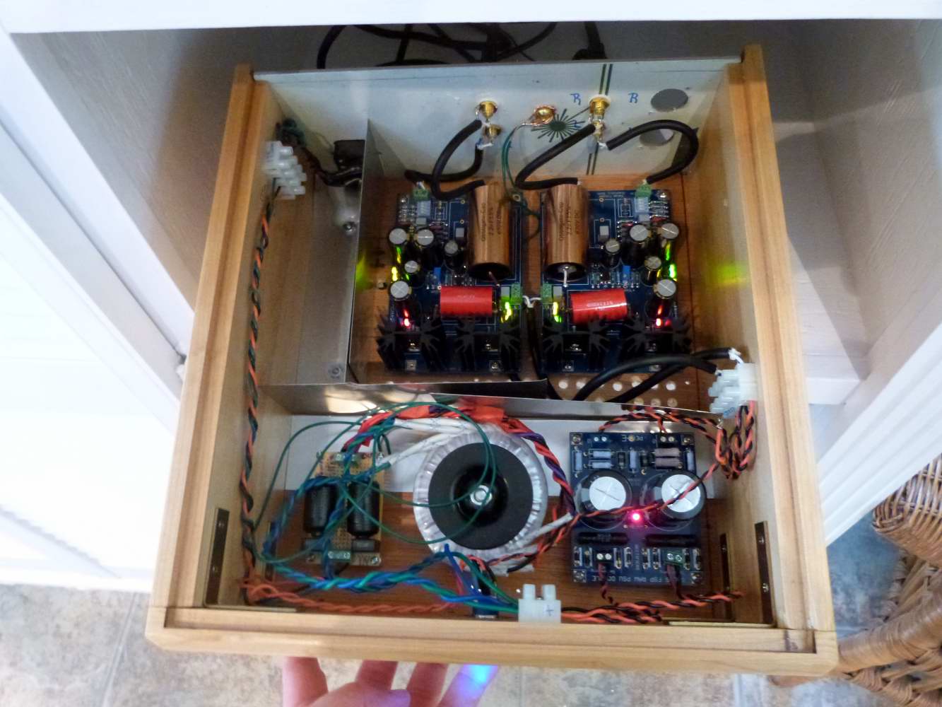

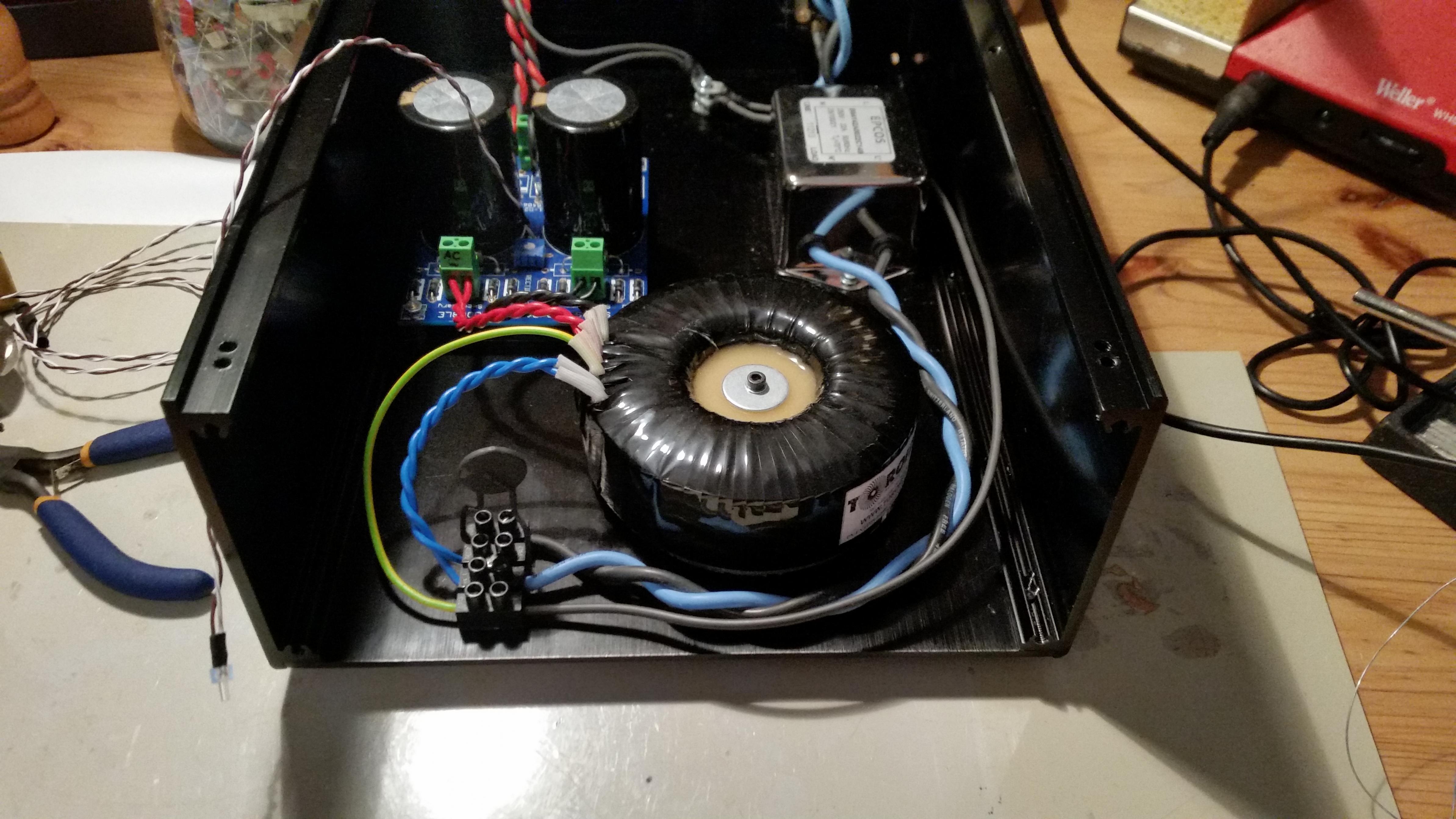

Nice use of the dual ground lug input sockets. Anti-phase loops for interference cancellation.
Lot's of twisted pairs for low interference.
Use of small loop areas.
Very well done.
Only one adverse comment:
The very long screen connection must have a high inductance. That inductance defeats the RF screening ability of the screen.
In my non expert view that screen connection must be VERY SHORT and bolted to the chassis right next to where the lead comes out through the transformer insulation.
Turn the transformer upside down to make that connection even shorter.
Well, that confirms my doubts. I was actually thinking about going directly to the chassis with the electromagnetic screen wire. I'll keep it in mind and maybe drill the required hole some day. Thanks for your constructive criticism, always welcome.

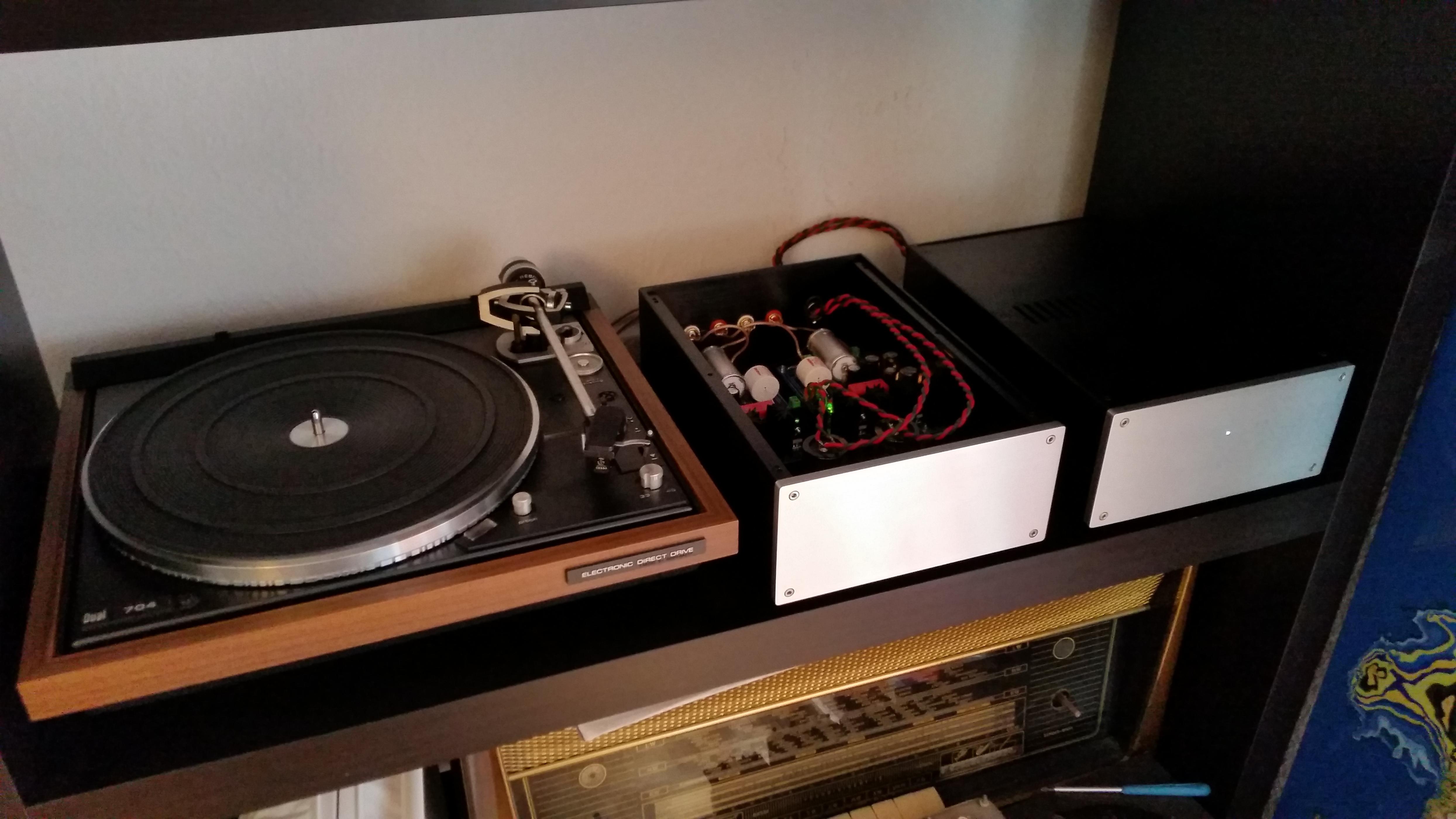

Excellent build details. Congratulations & enjoy. Is that a vintage Dual TT you got there?
Thanks 🙂 It's a Dual CS 704 found at a nearby thrift store. It was 15€ iirc. It came with a Pickering XLZ/3500E cartridge, no usable stylus though, also no dust cover. I redid the internal signal wiring, re-capped the motor drive board and put a Grado Prestige Silver moving iron cart on it. Lovely table.
Where did you get the cases?
From aliexpress China, but it's also on ebay. The type number is JC2210. But it's a very tight fit for the boards, check the first pic of my post above, I had to drill into the rail of the side panel (and cut a thread) to mount a post there.

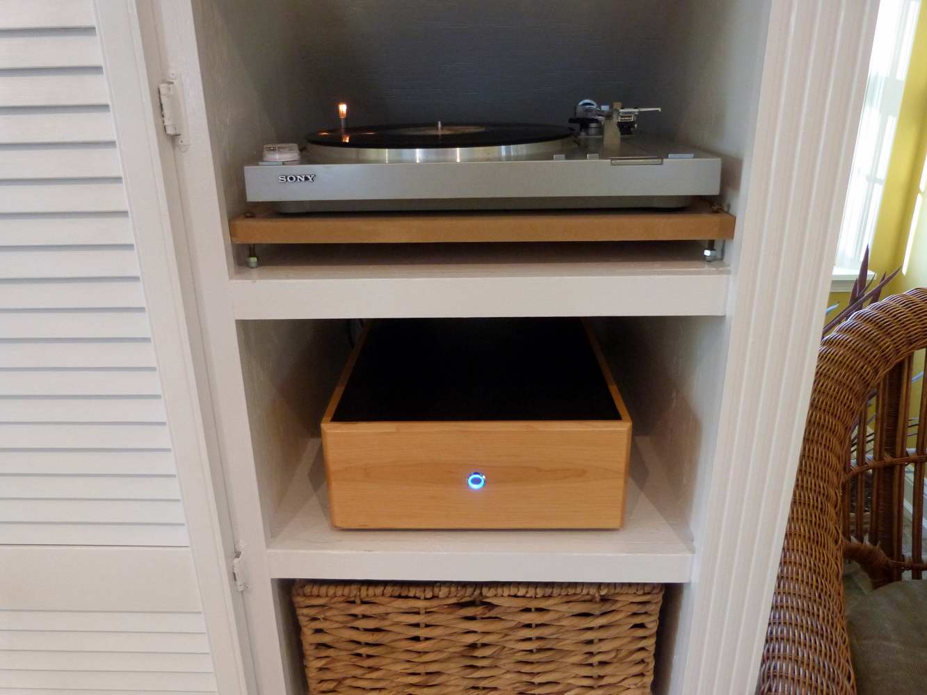

Finally finished my build today, massive snow storm in NE US, so a good time to wrap things up. Luckily I had some spare 9K resistors in my parts bin to sub in for R3X and they gave me the adjustment I needed to get the bias set dead on 3.6 v. Hooked everything up and played a few albums, Wow sounds as good as CD's ! Just kidding. I never has really nice gear back in the 70's when I was listening to albums on my Kenwood consumer goods, so this came as a big surprise to me how nice vinyl sounded. Listening through my old Shure V15 type IV ---> Aikido tube pre ---> Pass F6 sounds fantastic. Many thanks Salas for a great project.

Very nice wooden box. What is the small brown matrix board? A mains filter?

You are correct, it is a mains filter, I had it left over from a previous project, so what the heck, I threw it in on this one, it can't hurt. The speakers are diy back loaded horns that I made some years ago using Martin Kings great mathcad software. The drivers are Jordan JX92S full range, the tweeter was added, but not in use, sounds better without, and I never could get it to integrate to my liking. They are a great match for the F6 amp and are truely full range. For filters I'm using a zobel, and bsc bypassed by a cap to lift the high upper end.

Also the metal sections (Mu?) and a magnetically shielded toroid type kept the mains hum out from the single box build. Well done.

Very good woodworking both in your speakers and phono box. Excellent overall interior style blending. Not even speaker cables to be seen.
