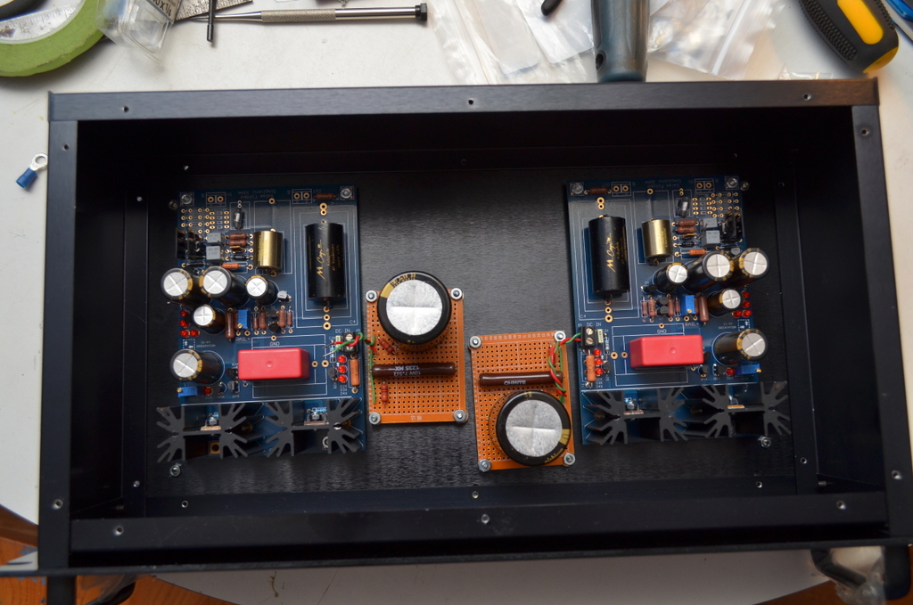

When placing the raw psu in a separate case with 1-1,5 metre (3-5 foot) umbilical, is it a good idea to place a second set of 4700f capacitors at the PSU input of the phono pcb?
Could someone point me to a good quality coaxial cable for the signal wiring in the phono box?
I used a second set of filter caps next to the phono boards, also with a bit of extra R partly because I needed to knock the raw voltage down a bit.
For signal cabling I use the single-core shielded stuff from Apex Junior (Wire), I don't remember what gauge, either 22 or 24, it's silver-plated copper with PTFE insulation. For the umbilical and to carry DC from the jack to the cap boards I used the "Mil-Spec M27500-22SD2T23" from the same page. It's shielded twisted pair, very high quality, and very nice to work with. For the very short hop from the cap boards to the phono boards I just used twisted pairs of hookup wire.

For umbillical cord I just used shielded 4 x 1mm ölflex cable.
Hooked up my scope and did not see any change versus directly on the PSU. So I would love to learn why an extra capacitor would be beneficial?
Marginally beneficial in low MC gain maybe if there is something rail related suspected to iron out. More in the heavy local decoupling sense.
In your much lower gain MM configuration, with custom mystical grounding of black background, no benefit 😀
