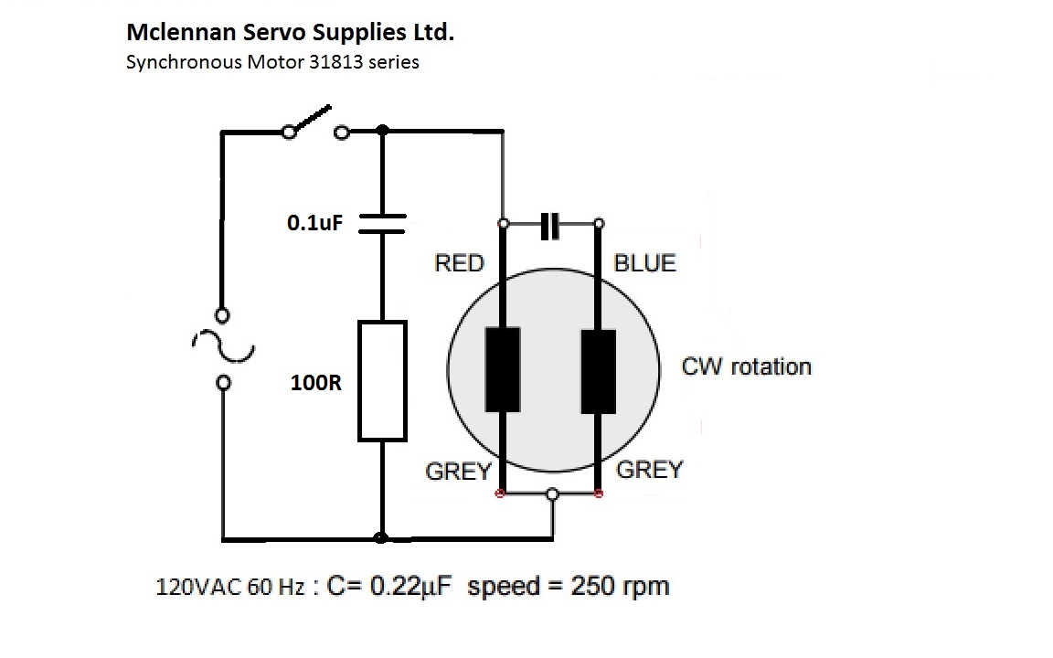

Please see what I did. I see no impact to anything beside my Turn OFF "boom" is disappeared. I can't connect MOVs close to the motor itself. My motor is in shell and quite hided behind MDF panel. In other words, MOV connection will require significant disassembly and might be ugly at the end.
