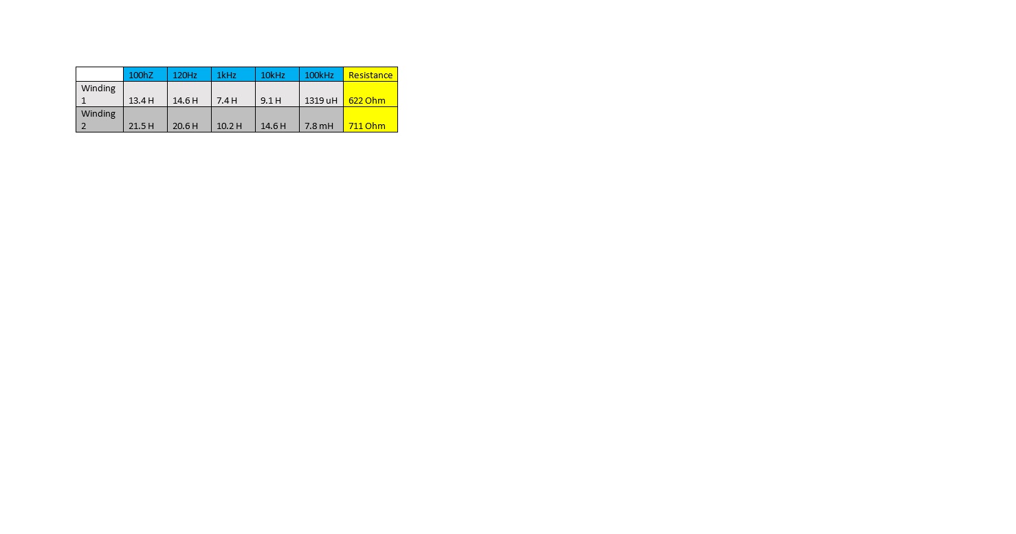

Hi all, thank you for all your advises. I have single ended configuration (unbalanced RCA), so Pin 1 is irrelevant.
LL7904 is also not good -> $$$. So, I'll try from simple setup with resistors, then I'll go for Hammond 140QEX (also not cheap, but less than LL).
Now about NTE1 from Neutrik? $9.
NTE1 - Neutrik
Found some small audio transformer in local surplus store ($0.50 price paid). Tested it and already installed it. Works fine! Can’t hear any alterations. Whole system is quite now and GND loop hum free.
