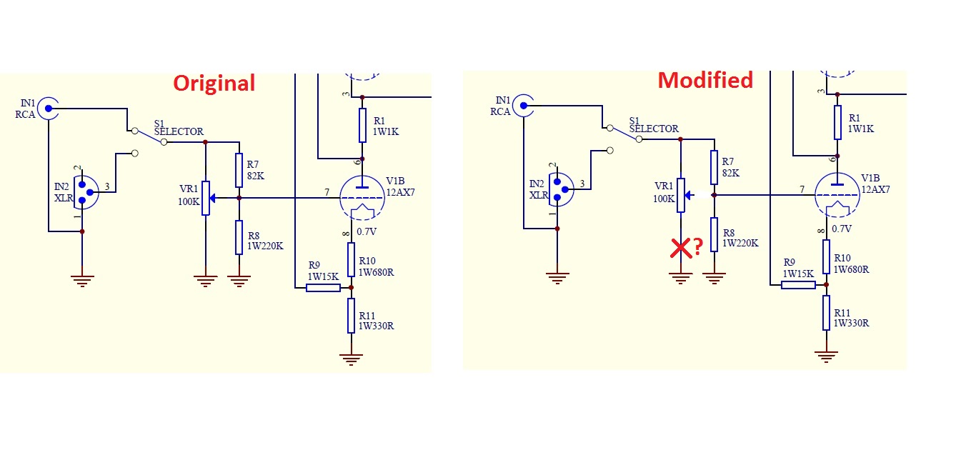

a. Most expected, its not an electrical oscillation
b. L pad in line input used for the phono input or general Lpad (resistor to pot), there are many Lpad calcs on line. Look for 25% attenuation to test first.
c. Acoustic feedback in the low bass. Smaller value Cout or lower input impedace in the line pre with 10K input Z Lpad or general Lpad with the pot for all inputs
Very probable is that you need start from setting up the TT better for the essentially new cart. Its smelling strongly like a positive vibrational feedback problem from sub to TT. Matter of rigid support even.

a. 🙂
b. I made some alteration. Hope it is the right one. It is too late to test it loudly now.
I'll run it tomorrow. Please see attached picture. Did not cut potentiometer from GND (red marks on picture) since it might change my Input impedance. It is 100k per manual. Please advise.
Original 82k and 220k voltage divider gives me about ¾ of input V.
c. I do not what to modify preamp output. I rather to mod Sub RCA cables. Please advise for Cout. It seems easy to install into RCA plugs.
d. TT is set perfectly now. Cart load is 3K now. VTA is 9-10 mm up from the original Ply and VTF is 1.86 gms. With no subwoofer actions, the sound is perfect.

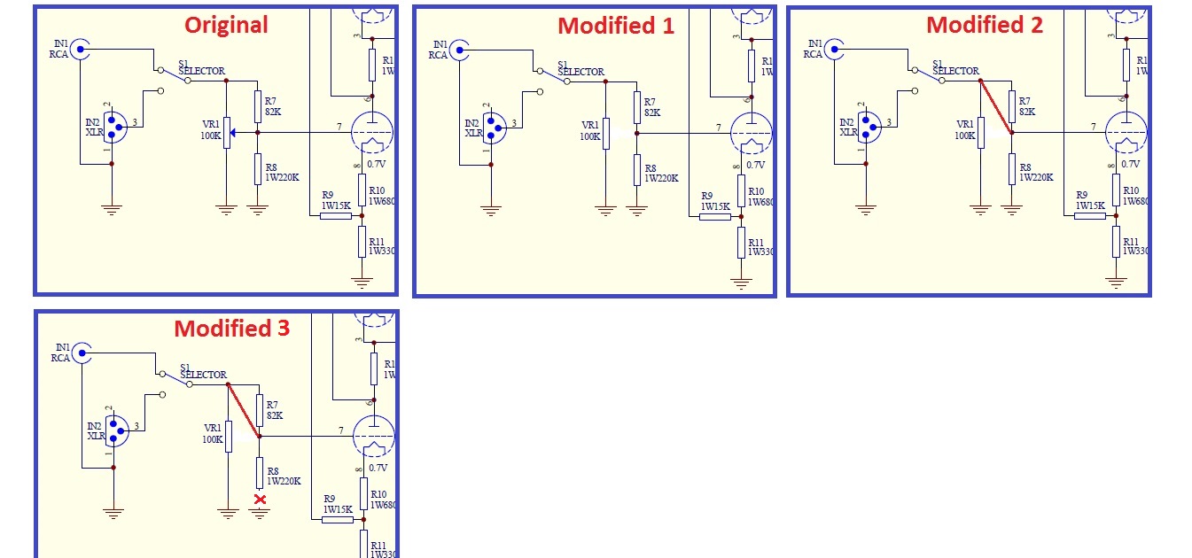

Hi Alex, so it already had R7 & R8 resistors there. The ground on VR1 must stay. Where the VR1 wiper now goes? Is it tied like a rheostat on one VR1 leg, changing the R7+R8 value as it is in parallel? As it was before it was changing the R7 value of the divider. http://en.wikipedia.org/wiki/Voltage_divider
P.S. With Cout I meant the one in the phono so to create more roll off. But it can be addressed with driving lower impedance in the line preamp easier and cheaper.

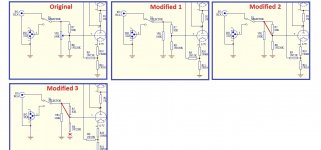

Hi Nick, I know that is not the right forom. But any way, that bypass is little messy since all resistors are installed into small PCB and potentiometer soldered too.
Please see attached picture. It will be clear what I tried.
What I did first (Modified 1) , I disconnected wiper.
Second (Modified 2) bypassed R7. At that case, R7 is irrelevant since it is shored and straight signal is going in. But, VR1 is 100K behave as load resistor and interacts with R8 installed parallel. So, the total load will be 68.75k.
Third step (Modified 3), I disconnected R8. So, my total load will remain 100k from Alps where 1 (GND) -3 (IN) on VR1.
I plan to disconnect VR1 #1 (GND) and to install “nice” 100k Vishay and the RCA input instead.
What do you think?
I can reduce C2Y if this what you caledl Cout. I’m using about 250pF now since my C2 is 14.950nF. Is this what you meant?
