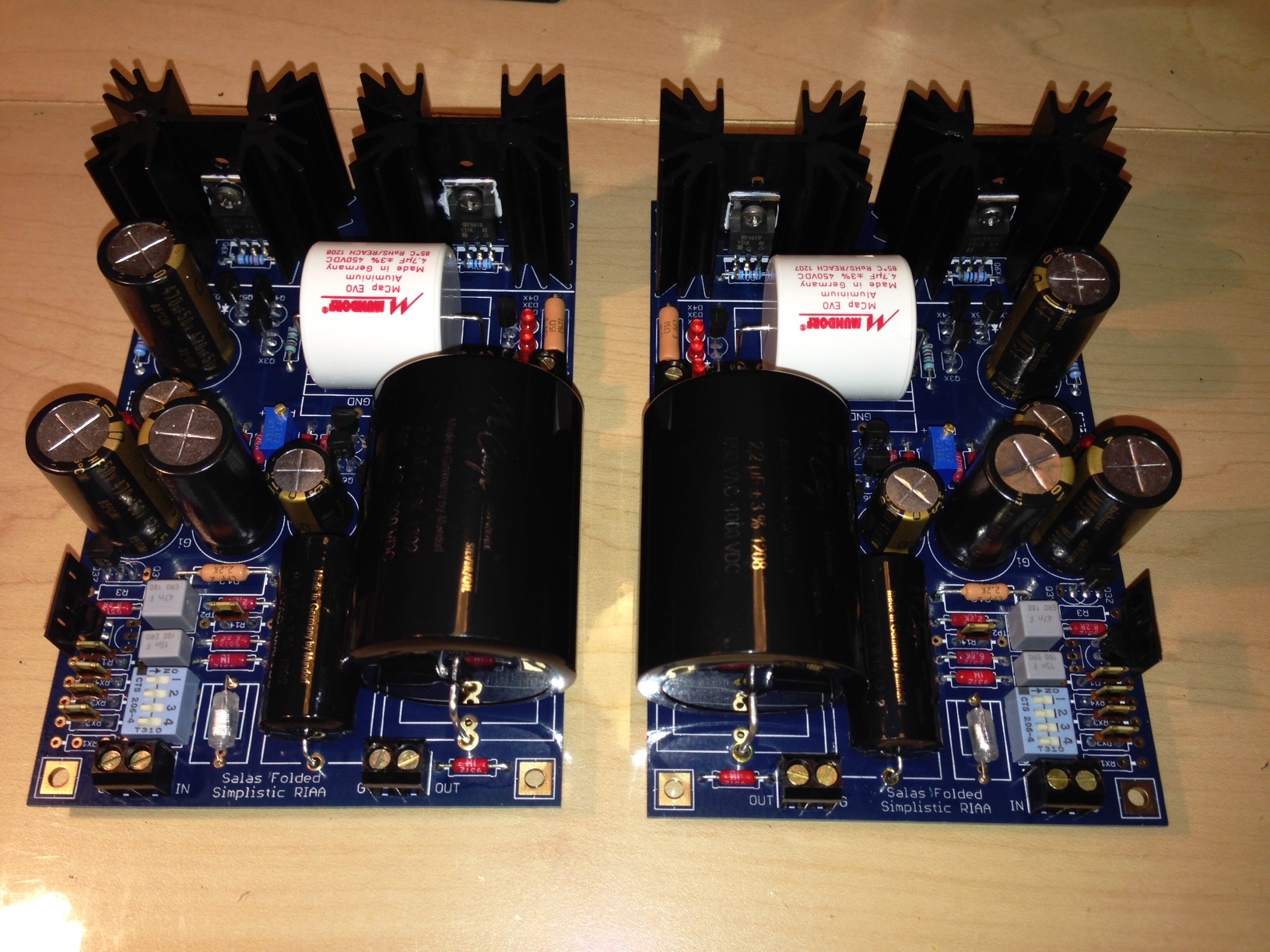

Hi Nick,
I need your advice….
I just received my Wilson Benesch Ply cartridge from re-tipping service (BTW for guys in US, the guy is in Seattle OR, Phono Cartridge Repair).
I got new boron stylus and they also replaced my coil. Now my Output is lower than the original one was. How low?, I do not know, but just for reminder, we assumed that I had about 1mV and I approached to the relevant set of parts: R13 was set to 2.2K, Q1 was 13.52/13.51 and R2 was set per table to 8.2R. Now, it’s the tricky point… You also advised me then to change value of some resistor and I actually don’t remember which one.
Do you recall that? Please let me know.
Now, I assume I need to go for 62-63dB version, so…
I have one matched pair of Q2 with 13.45/13.45. Assume that R3 should be the same as R2 = 8.2R.
R13 need to change to 1.2K 2W.
Did I missed anything?
Please let me know.
