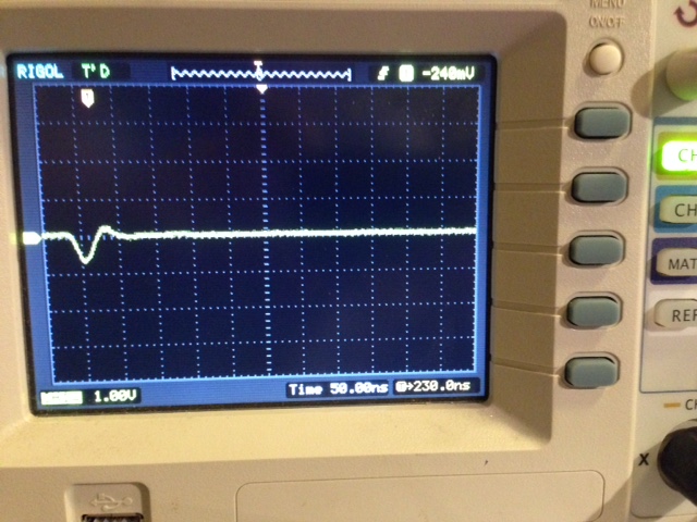

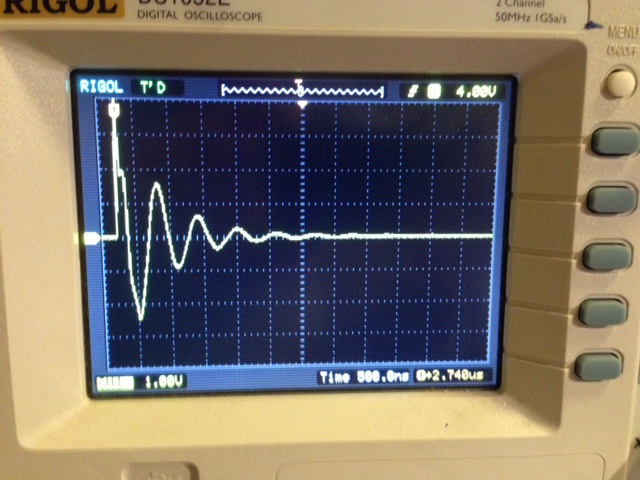

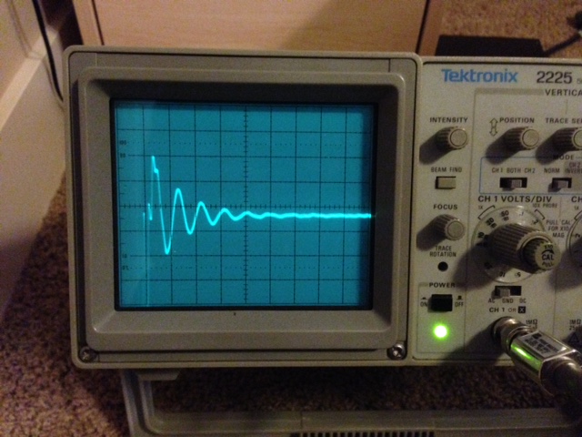

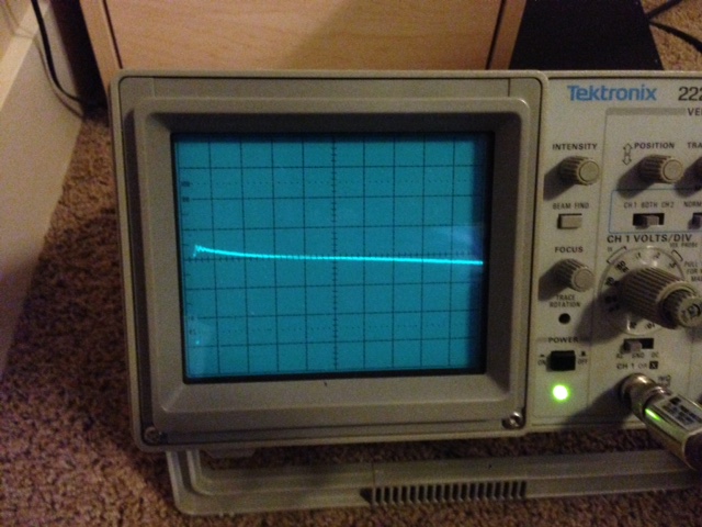

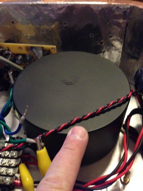

I posted the target snubber pic, if you use 500R the tx will be over damped and scope will show a large tail wave, if you use 220R you possibly see in the scope more than one wave or at least the second inversed wave.

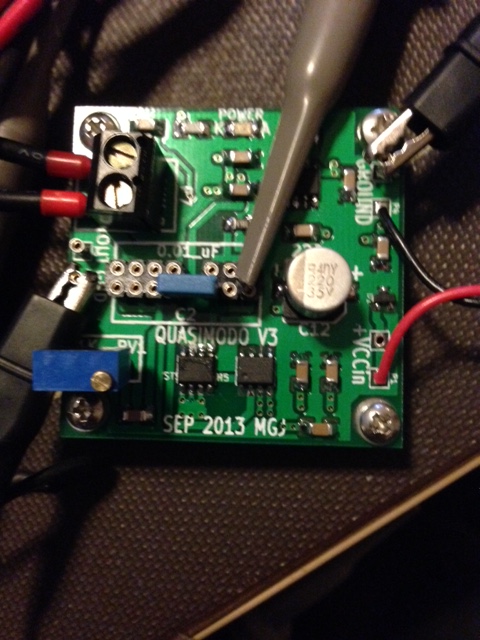

I glad I have that jig. Requested data is coming soon.

You are asking subjective opinions, overdamped sounds bad and at this point I prefer without snubber, I can tell you the sounds improve more when more near is well damped the transformer without overdamp, I had a lot of fun playing with the jig.

I also can do measurements with Quasimodo for all US located guys who use Antek toroids, the same tranys that I have in my builds:
AS-0515 - 50VA - 15V
AS-1236 - 100VA - 36V
AN-8412 - 800VA - 4x12V
For all friends who use Antek "AS-1236 - 100VA - 36V" for FSP.

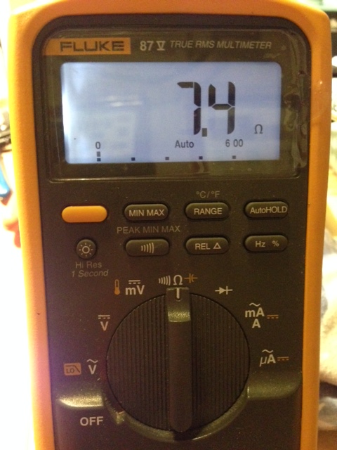

Cx=10nF, Cs=150nF and Rs=7.4R
