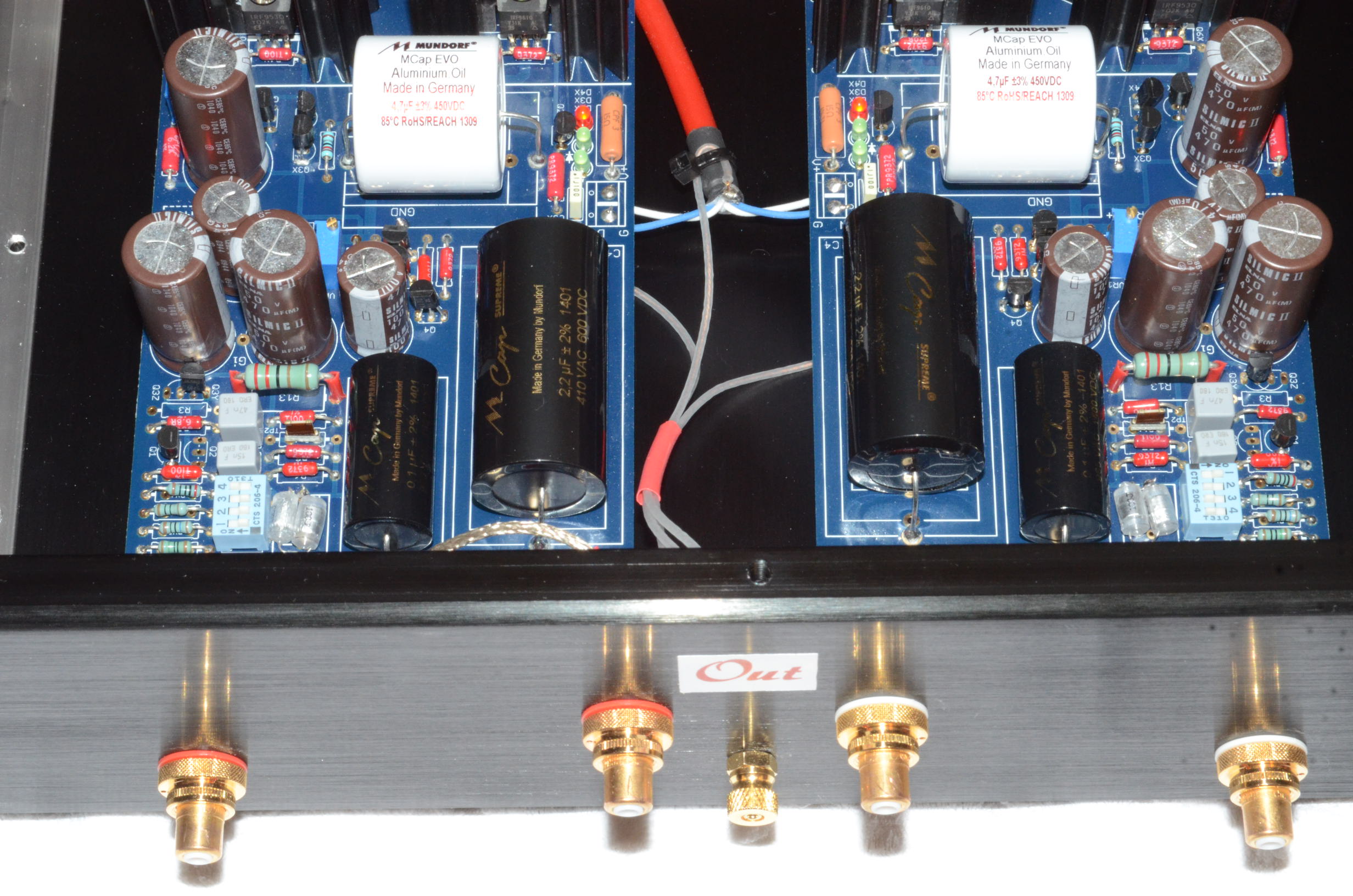

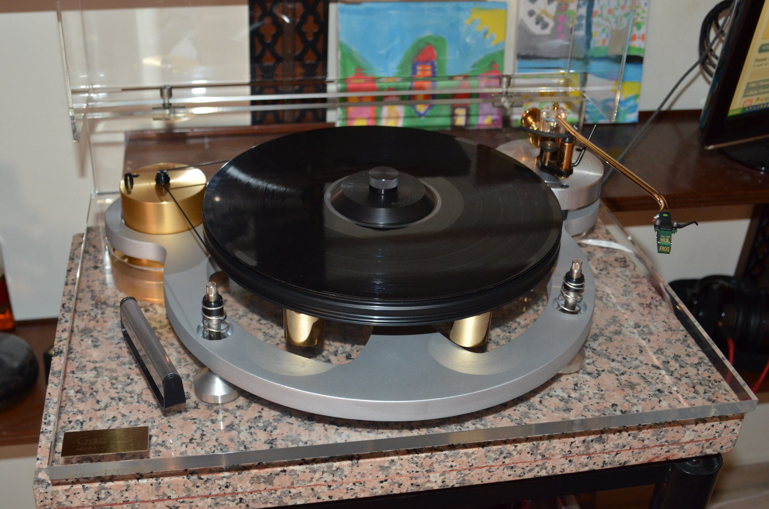

Better late than never!
My FSP proved the best project yet for my Michel Gyro / Morch UP-4 / VDH Frog rig!
Everything worked perfectly from the start and adjustment was as easy as it gets thanks to Salas detailed instructions.
As expected, sound was very good and now I feel as a proud owner of a rare diy device...

Very very nice setup... I agree, the best so far regarding phono amplification.
