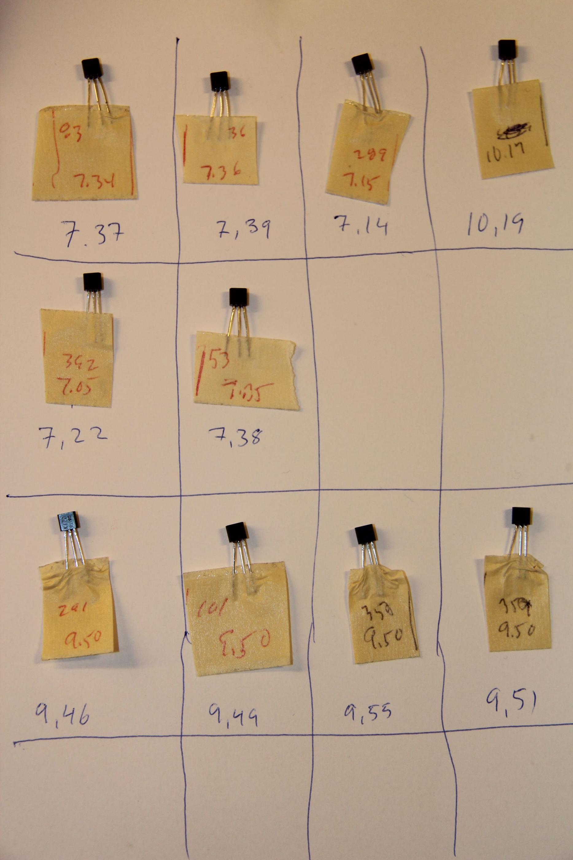

8,27 and 8,72 on Q6 then. They were tighter on Mikes measures (texted on tape and bags), but not when I control measure. If Mike is there, what method did you use?
I measure at 10V with HP power supply, through a Fluke 87V.
I make sure that room temp is 72 degrees (heat pump can do well here)
For the 2sk170's I don't measure for too long, under 5 seconds.

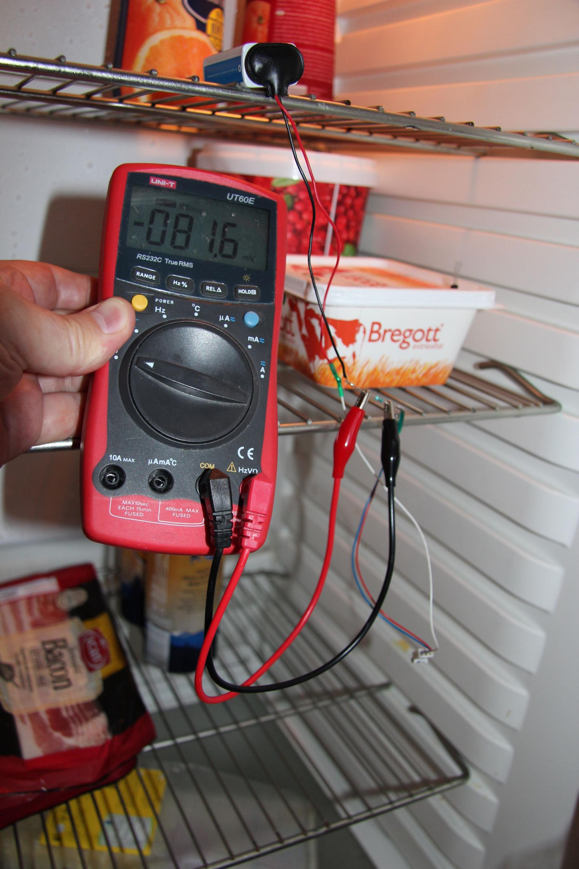

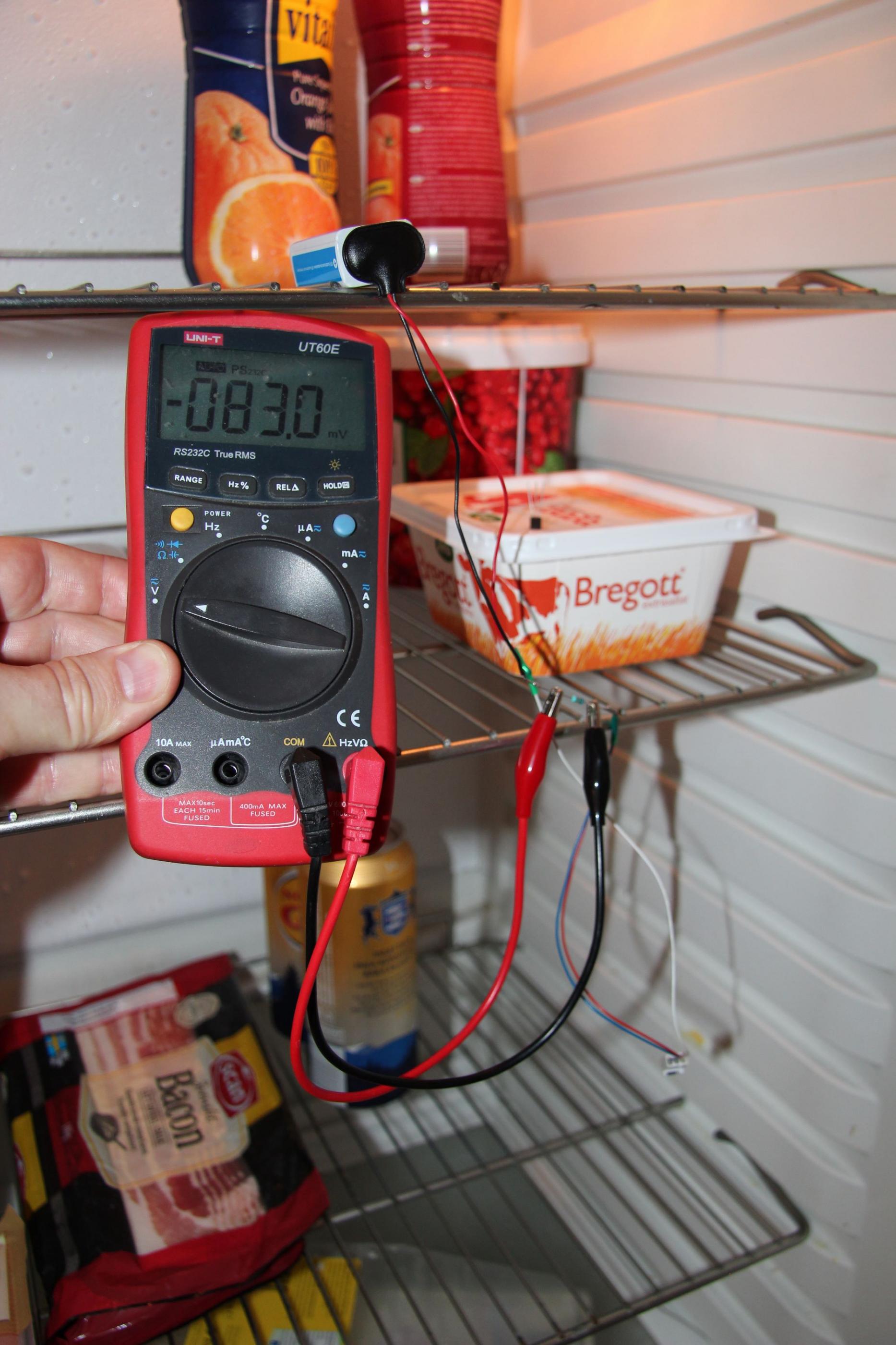

Strange. My values follow yours (Q4,5,6) but have much larger deviations between the pairs. I do have 28 degrees C inside, som 82 F but I wonder if this can do it.
Remeasured once again with 9 V 100R and got about the same. Changed the resistor to 10R and writed them values in (x).
Well, maybe my Uni-T UT60E is bugging me and the values arent far out anyway.
PS. In my measures Idss rises some 100 microA the first 30-60 seconds.

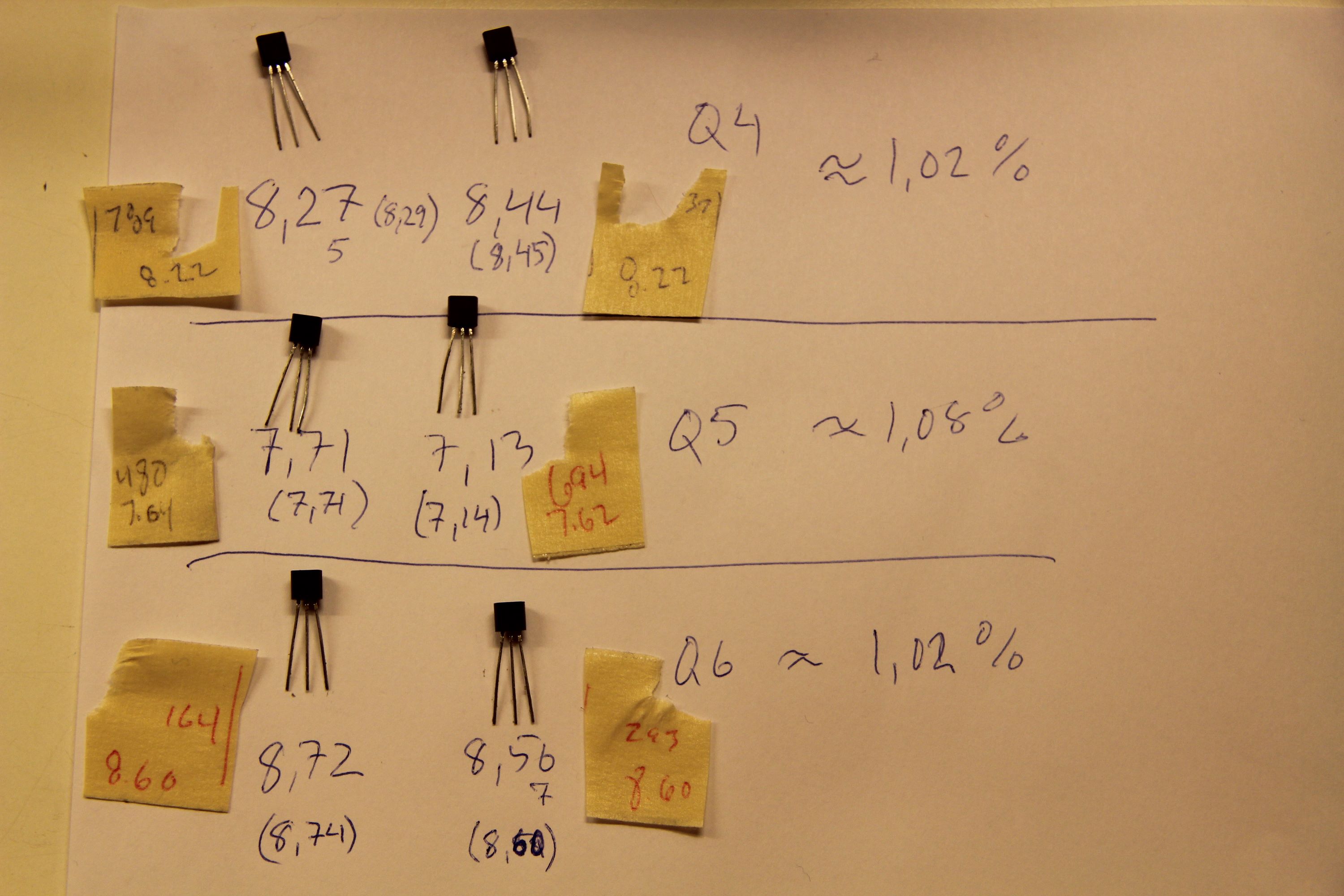

Ok, I'll arrange it like this:
Ch1 Q4 8,44 Q5 7,14, Q6 8,27
Ch2 Q4 8,56 Q5 7,71, Q6 8,72
tomorrow:)

Just found out that I had ordered some extra K170 from Mike. Those had better coherence to my measuring method. Unfortunately none in the Q4 region.
So if I arrange it:
Ch1 Q4 8,44 Q5 7,71, Q6 8,72
Ch2 Q4 8,56 Q5 7,14, Q6 8,27
Is there any reason for me to change for example Ch 1 Q4 from 7,71 to a 7,14?
The 9ers is ordered as a quad. I dont remember what project I had in mind but maybe I should keep that as a quad and not use it as Q6es.

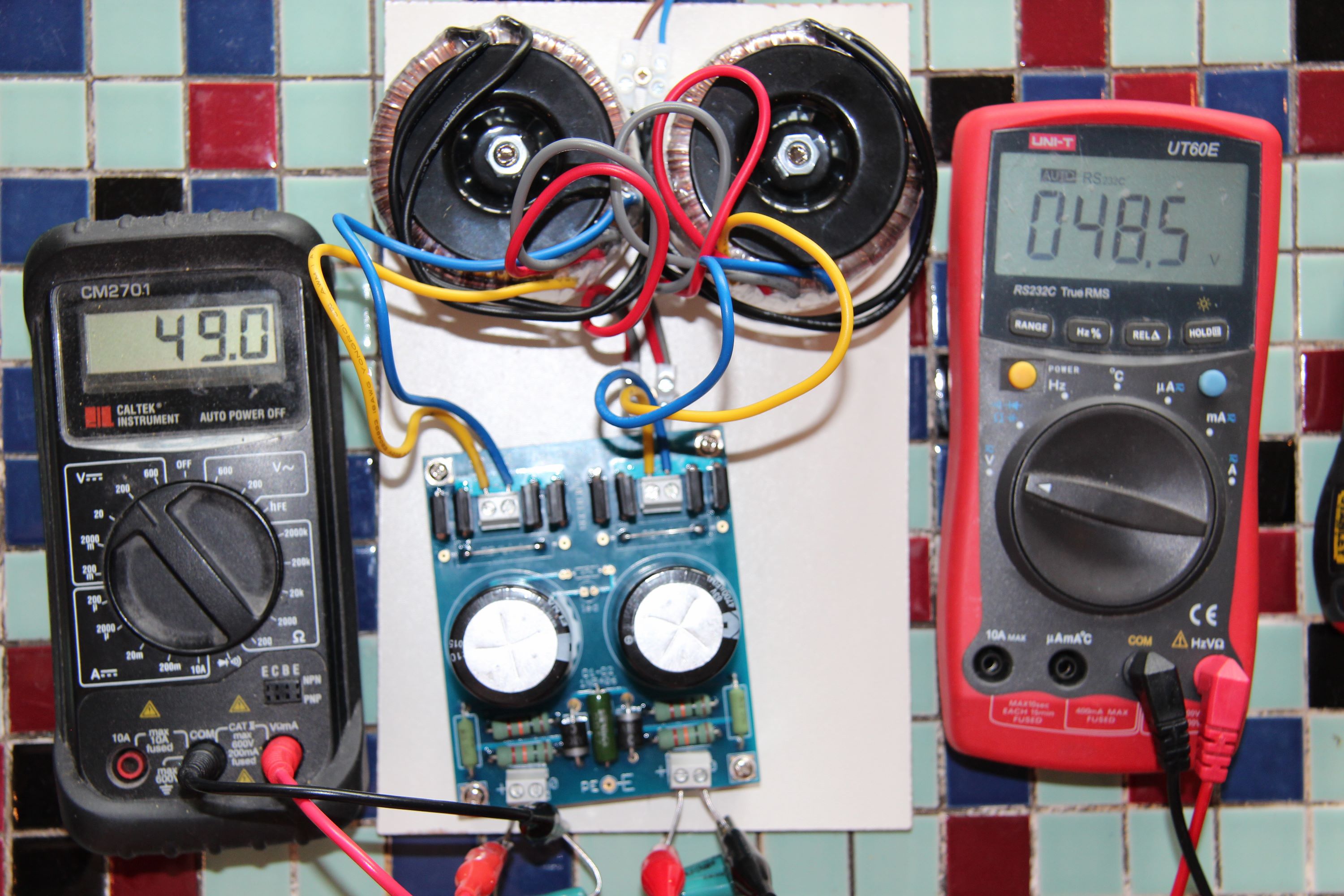

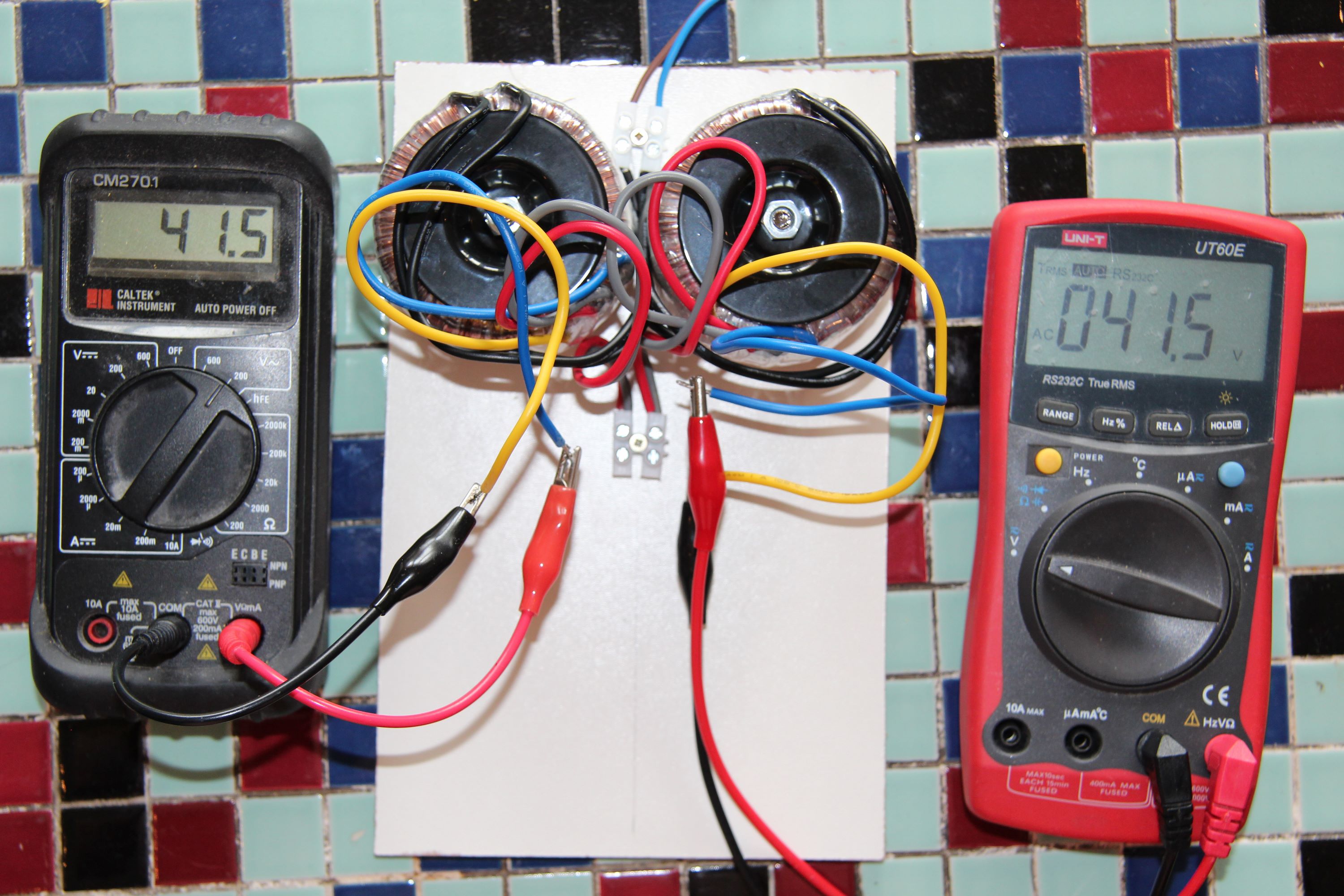

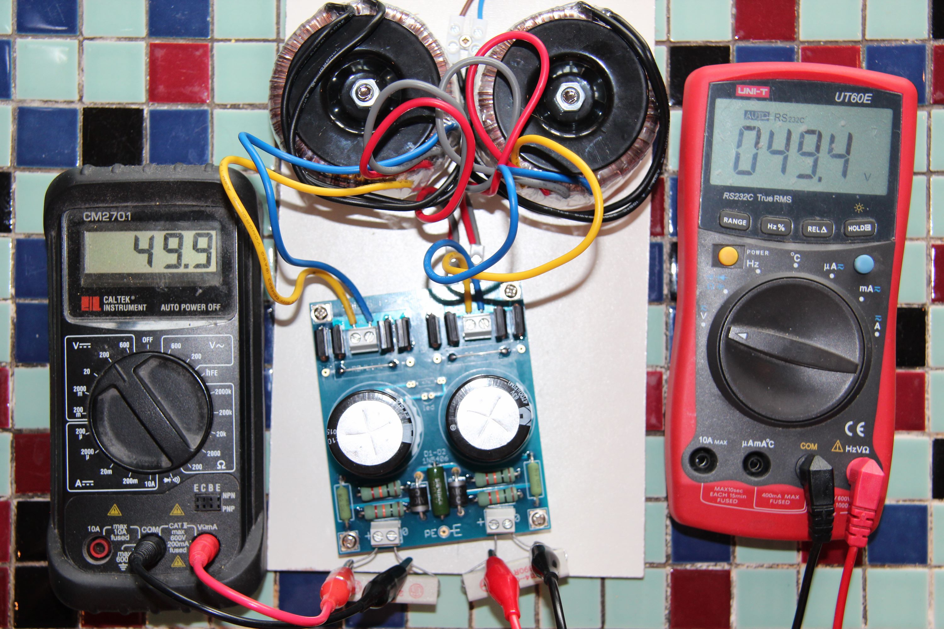

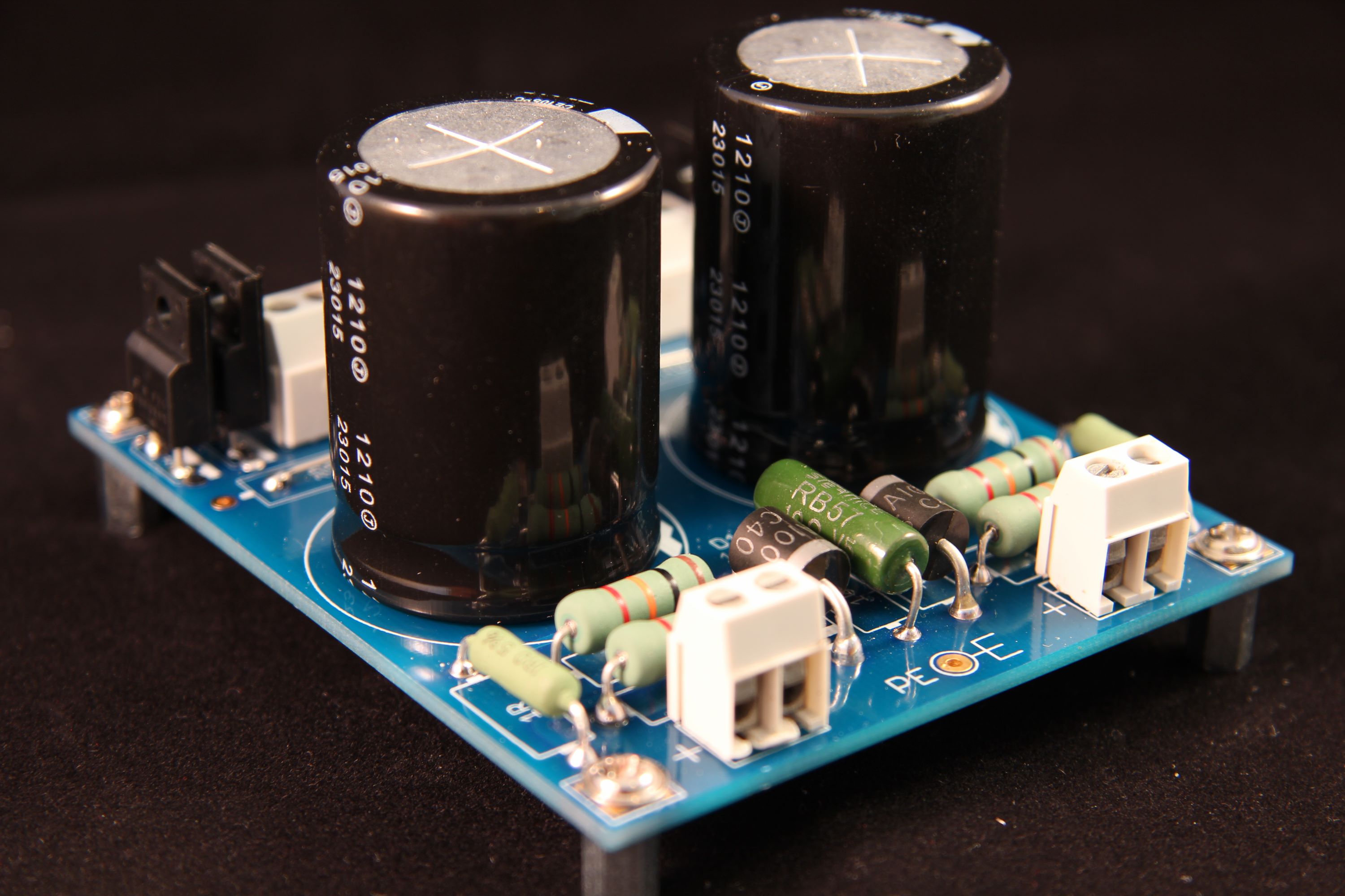

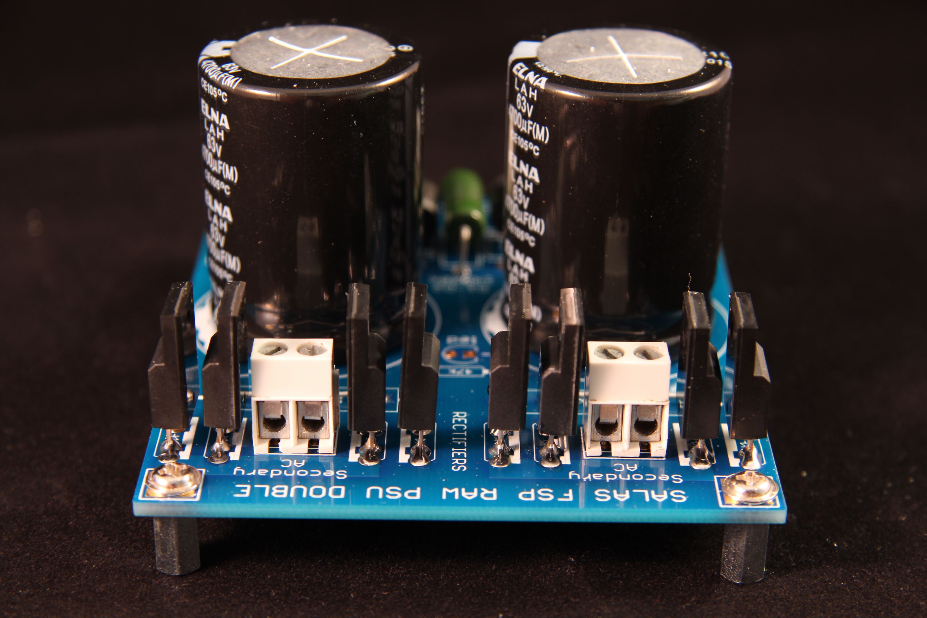

Soldered up and tested the PSU meanwhile. 41,5 AC sec unloaded, about 49,5 VDC@127 mA (390R dummy) and 48,5@145mA (335R). Might eventually sneak up to the 50 depending on the final setting. Am I clear with that or do I need to us the RD/Link?
