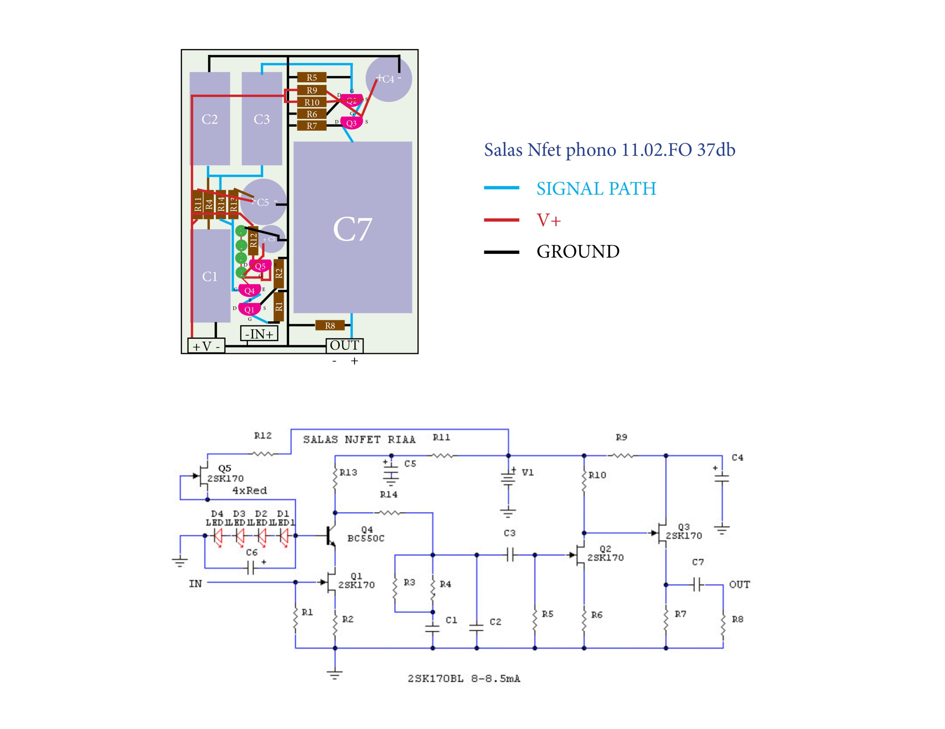

Actually, I am about to do a Salas based on 11.02.FO version. 37db to use w/my Ortofon 2M bronze (5mv).
Since no pcb is available now, I plan on using 7cm x 9cm protoboard. Although I've built stuff before (F5, Ba-3, boozehound phono, etc.) this would be a pretty complicated layout on protoboard for me.
How does the attached visual look? Anybody have any advice or tips?

It looks generally alright for a p2p configuration. I would vote for 3 weeks sign up time for about 5 weeks round time since this GB is belated already if Mike can manage.
Thanks Salas. And thanks for the design and always answering questions.
I think I will do it point to point...i like the challenge and I find doing the point to point stuff more rewarding and better for learning about circuits, etc.

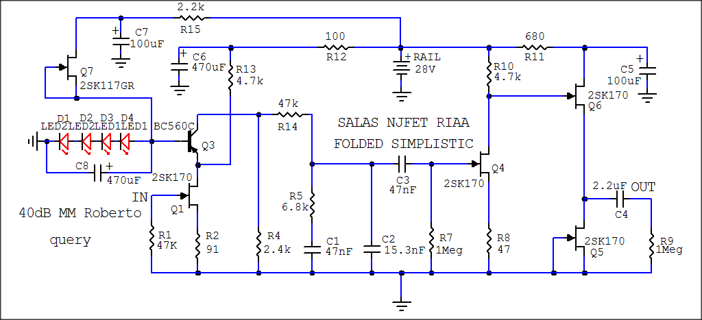

Is there a big difference in this version and the current version the Pcb is being manufactured for? I see different jfet on input but I assume this is for MC. If we are talking about the low gain version for MM will I notice any sonic differences?
The sonic differences will be smaller for high output cartridges between the telescopic and folded cascode versions since the SNR is naturally stronger, but the FSP is still the better choice. Especially on its pcb that proved a success for absence of noises and good resolution. Not forgetting the positive contribution of its smack on integrated regs. The weaker resolving power of budget MM vs. expensive MC or MM will set a limit anyway. There is MM configuration in the FSP guide. If 2SK369BL are difficult for you, there is a 2SK170BL variation that I have suggested to member Roberto not too long ago and he had made on own boards. Here is it again. Should be kinda middle of the road compromise. It was for circa 8mA IDSS JFETs.
Thanks Salas. I didn't know, but now I do.
I might still do the telescopic version. I don't see myself going to MC soon (I really like the 2M bronze and will probably upgrade to the black when the time comes), and, while I have a good supply of 2sk170, the 2sk117GR is going to be a problem. Can we use a 2sk170BL (8ma-ish) in it's place?
Use the smallest IDSS 170BL you got in place of the K117GR or better use BF245A if you got any. See to have about 10V between R15 and D4 (across Q7) and adjust the R15 value for that. (Or R12, D1, Q5, in your #12842).
P.S. Match your FETS to a fair degree, and use your best matches in the second stage.

Very cool, I look forward to photos!
Thanks Salas. I've got 6 sets of 2sk170 between 8-8.5ma. Hopefully one of those will work in place of 2sk117GR. I'll adjust R15 to get around 10V between R15 and the LED.
I'll post a new protoboard layout soon for the folded w/2sk170 (Roberto's 40db version) soon. I appreciate the help.
P.S. R12 can alternatively be a 200R trimmer in rheostat mode. Helps to match input stage biasing between channels sometimes vs the IDSS tolerances.
