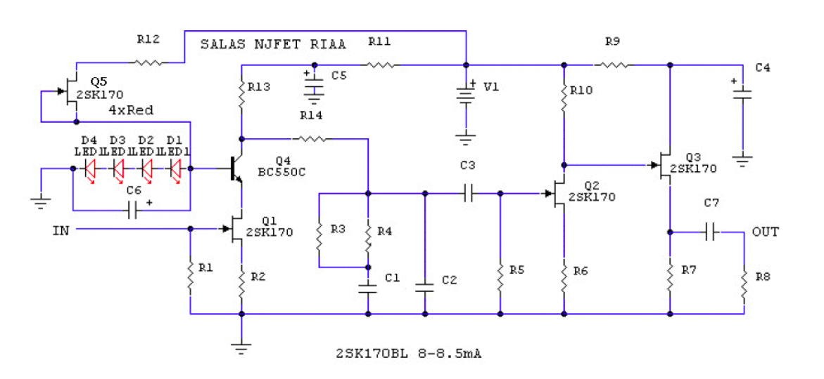

Replaced Q3 - made no change with TP1/TP2 or anything else.
Measured the current across Rs 1&2 - comes out to just under 9mV - using 4R resistors.
Any suggestions?
Thanks and take care,
9mV there across 4 Ohm means 2.25mA current through each 369. Problem. It needs reach 9-10mA. Make sure R13 is 1K2 indeed. If R13 is correct value then you need troubleshoot further. You could have a problem with the main CCS in the reg not providing enough current if you actually had created a problem when you accidentally tweaked there or the 369s could be shot.
Moves:
Check that the Q1x IRF9610s work. Are their sinks getting hot (that is a good thing), do they develop 3-4V between G&S pins? What is the voltage across each R1x and is it 15R indeed?
What are the DCV to ground readings at: Q1, Q4, Q6 drain pins?
Are photos of each board channel possible, maybe we can spot something?
Are R2 & R3 4 Ohm indeed?
If you remove a 369 and remeasure its IDSS, is it healthy and as expected?

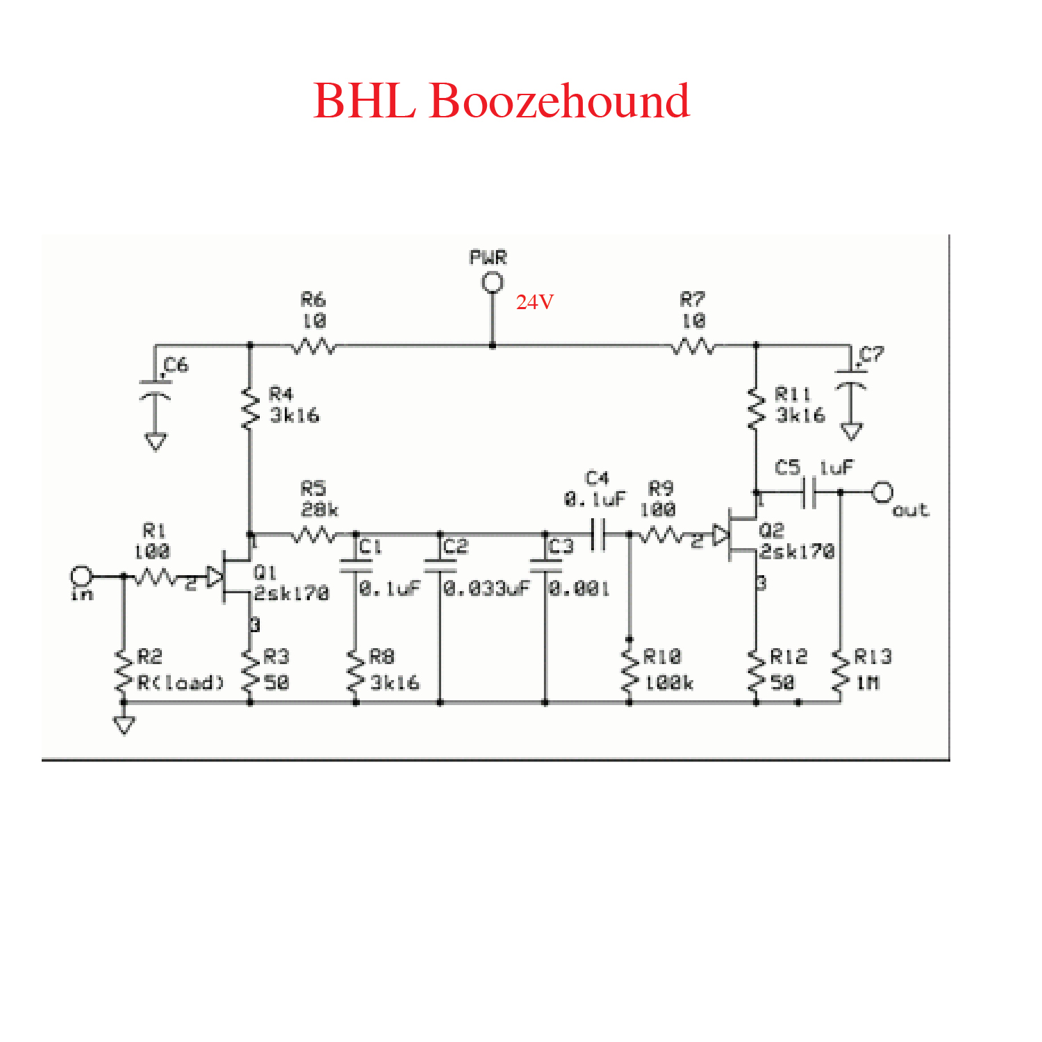

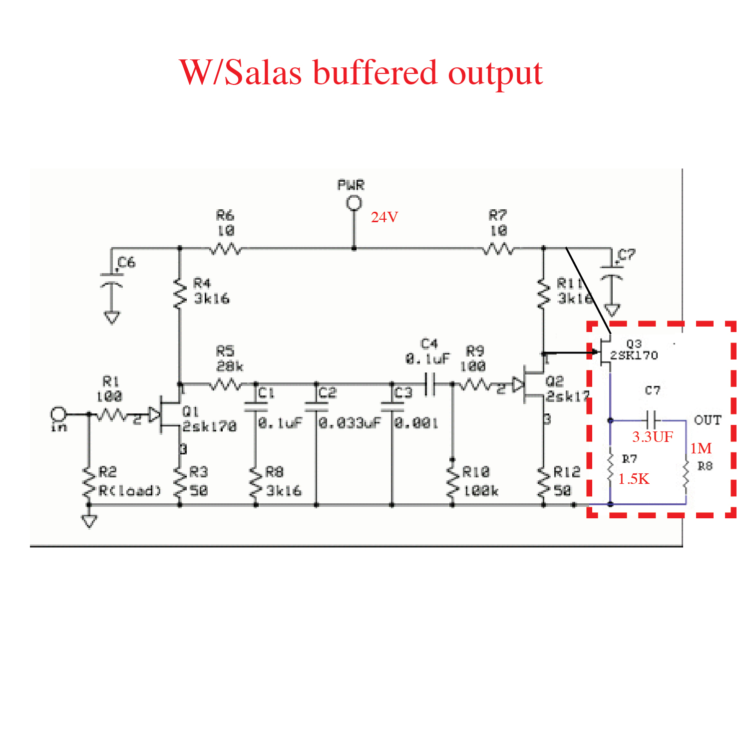

I am currently using a BHL/Boozehound Jfet pre based on the "La Pacific" preamp which is really kind of a similar design to the Salas Nfet, although not as refined.
I've been longingly eyeing the Salas NFET schematic...I am thinking about incorporating the output buffer into my Boozhound preamp. Schematic attached.
Would this work? Good idea or bad idea? Is this worthwhile even without all the first stage improvement Salas has developed in his pre?
That last schema is not FSP arrangement but previous with telescopic cascode. Alexkosha had one like yours or similar but he had invested further with upgraded components and SSLV1.1 BIB regs and filters alright. Then he made the FSP (folded simplistic) on its dedicated board so he is the best experienced man to tell you if it is worthwhile upgrading bits in general and how close you can reach.
Meanwhile to incorporate that source follower right technically you should test for an R7 value that with the voltage drop across itself it does not compute more mA than your Q3 IDSS.
Disclaimer is that I am not the Boozhound author, I don't know if tweaks are even encouraged, and you better ask his opinion and guide directly. He is a member of DIYA also.

Well, I measured the voltage across Q1x and Q6x - Q1x right around 4 Q6x around 3.5.
When I make these measurement I have the power off while I attach the leads and then I turn it back on.
After making those measurements, power off, remove leads, turn the power back on and now the LED quartet is dim and Rail/Gnd measures around 7 volts. Turning VR2x makes no difference.
Could a trimmer really go bad? Not as if I have been using it that much! I will check it as per your instructions.
No need to make any more measurements on that board!
