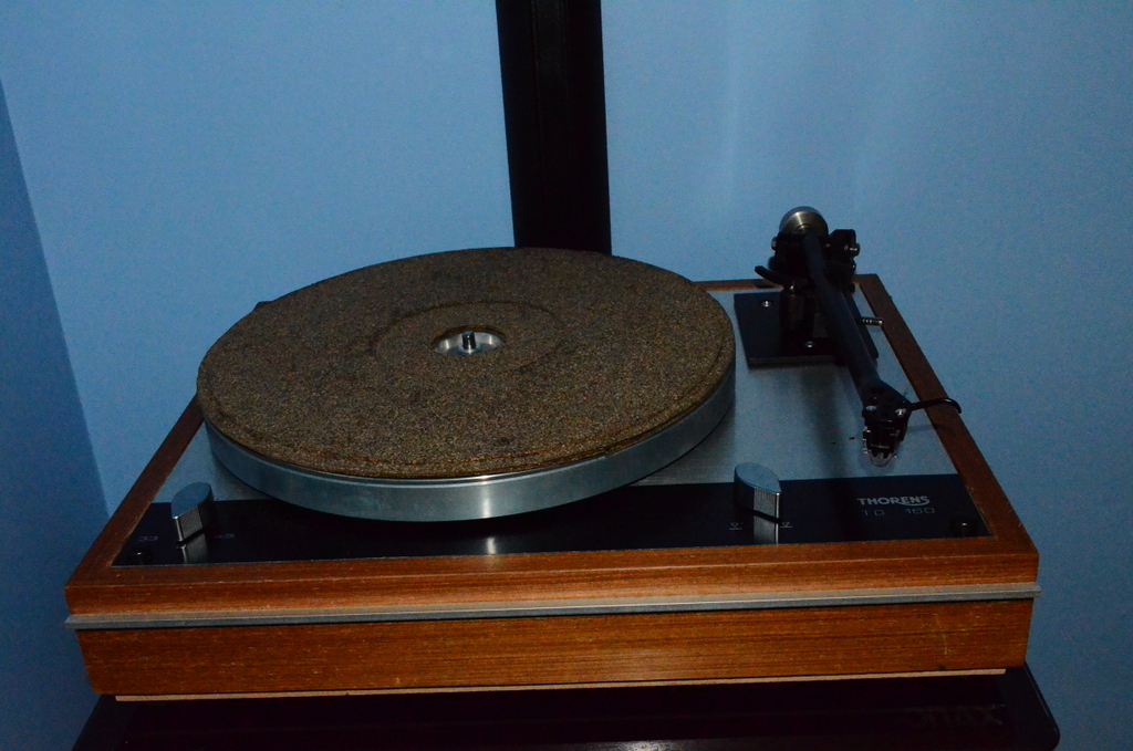

Since i couldnt find a proper size screwdriver to adjust the VTA, i thought about nezbleu's idea (thanks!) for a thicker cork mat and bought a 5mm thick cork sheet. Actually i figured i would need 4mm for proper VTA but 5mm was the nearest i could find.
The tonearm appears to be perfectly parallel to the vinyl surface, and the sound is more "relaxed". Drawback is that the tonearm in playing position is higher than the tonearm lift mechanism, so the needle always touches the vinyl surface.
I finally got around to making a cork mat. I used cork/neoprene gasket material, but the only thickness I could find locally was 1/16", which was too thin, so I built it up in layers. I made a top layer about 29cm diameter with a cut-out for the label area, and fixed that to a full-size layer with flexible silicone adhesive. I added another layer on the bottom, so 3/16" (about 4.8mm) but it wasn't quite high enough (the original Thorens mat is about 4mm thick), so I added a 4th layer on the bottom.
The result, in terms of VTA, was perfect, and it really cleaned up the high frequencies. However, I need to adjust the arm lift as well, as it won't quite lift the stylus clear (depending on record thickness and flatness), and the mat almost covers the spindle! So I think I will revert to no more than 3 layers, maybe just 2, and bite the bullet and modify the arm board to lower the back of the arm. That is slightly complicated because the arm board overlaps the top plate, so if I remove material from the bottom it will limit downward travel of the suspension. So definitely a weekend project, since I'll have to remove the tonearm. Sounded very nice though!

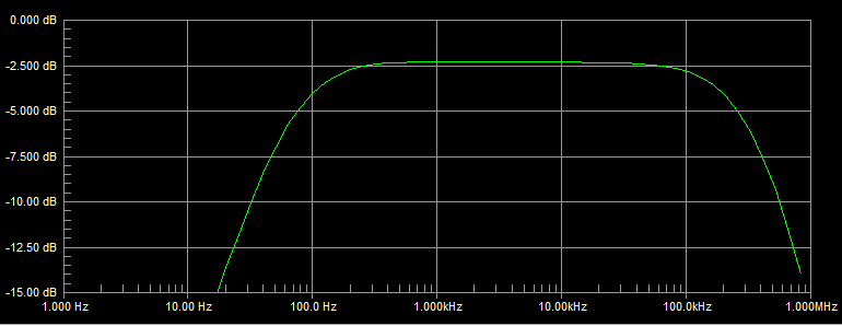

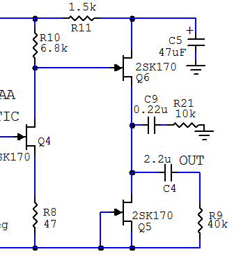

Output cap for my phono amp/application
Since I do not really understand how the two devices I want my FOLDED to drive (40K line stage for below 500, 10K power amp above in parallel) affect the effective input impedance - I am wondering if the 10K of the power amp affects the amount of capacitance I should use?
AND THEN I started wondering about having two output paths - a 0.22 uF cap (since I have a VCap of that value on hand) loaded by a 1M resistor which will be connected to the above 500 hz amplifier and a 2 to 3 uF cap loaded, also, with a 1M resistor connected to the below 500 line stage. Is there something I need to know that says I should not try this?

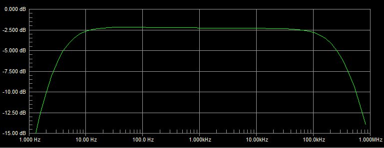

Here are the simulated frequency response effects if I got your query right. I only show the amps as output loads for simplicity since the extra 1M local terminations don't change the situation. High Out is from the 0.22uF & Low Out from the 2.2uF. High Out will affect your out of band low side crossover slope and phase. Has to be compensated in the scheme of things.Since I do not really understand how the two devices I want my FOLDED to drive (40K line stage for below 500, 10K power amp above in parallel) affect the effective input impedance - I am wondering if the 10K of the power amp affects the amount of capacitance I should use?

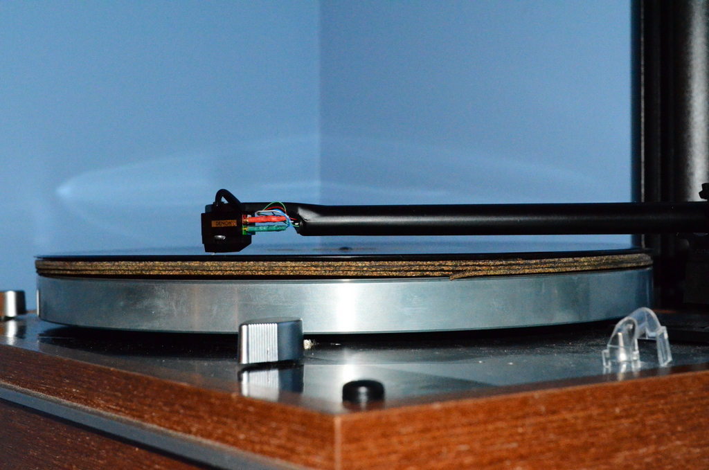

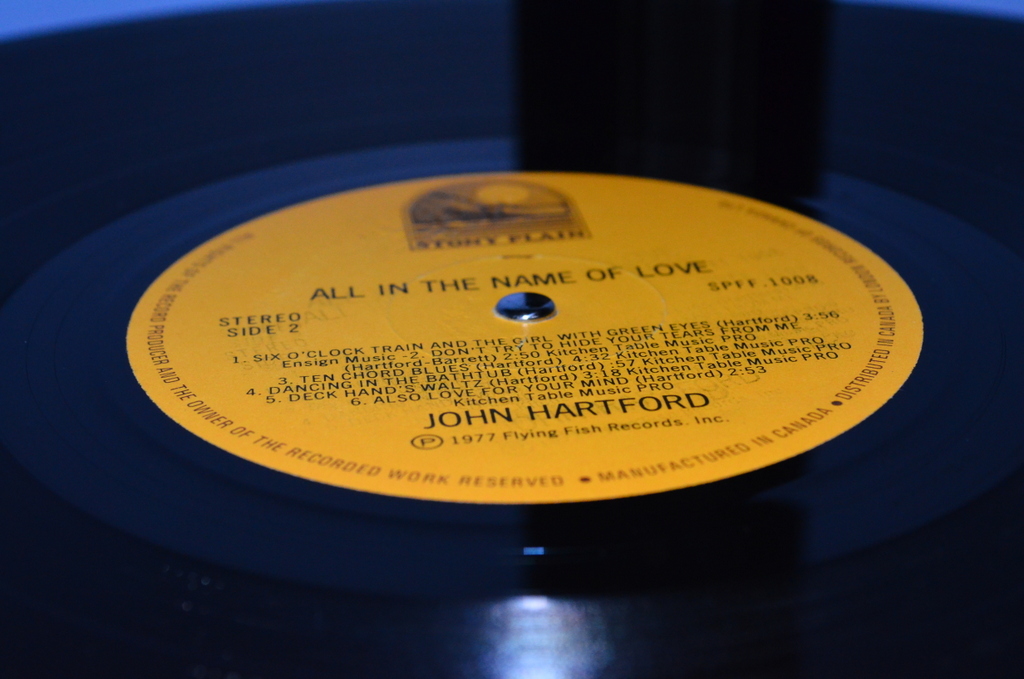

Just for giggles, here's the cork mat I made (think of it as a prototype).
I adjusted the cuing arm to work with it, but here's where I see a problem:
The spindle barely clears the record.
But it does good things for the VTA:
So now I have to decide whether to keep that mat (about 6.5mm thick) or change the arm board.
(Sorry Salas, I know this has nothing to do with the folded, but I have enjoyed using you as a sounding board while I work through this new setup.)
It has to do a lot with the thread because its main goal is we try to maximize our vinyl experience with simple but effective means we all can understand and create.
The axis of this adventure is the FSP that treads on that path but any added value in understanding its mating cartridges and TTs with practical examples and unfolding stories is most welcome. When we started this thread five+ years ago the category was stagnating, now its flourishing with many more threads and this is heartening about vinyl replay related diy.
We don't seem to get serious problems in executing the FSP builds right by now, so we also try make the various vinyl rigs and FSP builds serve in a manner best suitable to each builder. What we know about the many fine things decisive on picking and setting a vinyl system right we contribute and surely someone will benefit. Even if our TT is a humble stock form second hand one, a diy flop or a diy masterpiece, or a top notch latest commercial one.
Could you spray paint that cork mat black, or that would change its surface damping negatively? Anyone who knows? Having the arm board modded is the more elegant solution visually in your case, I will tend to agree with you.
Also, guys if anyone is planning on getting a new TT with integrated arm think well about the height of the cartridge in mind. VTA is not a mere detail. Many are fixed for arm height. If planning on a new arm see it to have VTA adjuster else its a nuisance. Or know and plan a practical way of modifying its resting board height. Grab a good digital scale for VTF also. Vinyl replay is about small details to make it tick right. We see that proven once again in this tread frequently.
Another way of tweaking VTA on a fixed arm is to use shims or spacers between cartridge and head shell. Not my favourite, but it works.

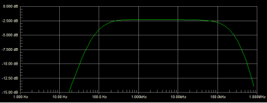

(for level setting)Here are the simulated frequency response effects if I got your query right. I only show the amps as output loads for simplicity since the extra 1M local terminations don't change the situation. High Out is from the 0.22uF & Low Out from the 2.2uF. High Out will affect your out of band low side crossover slope and phase. Has to be compensated in the scheme of things.
