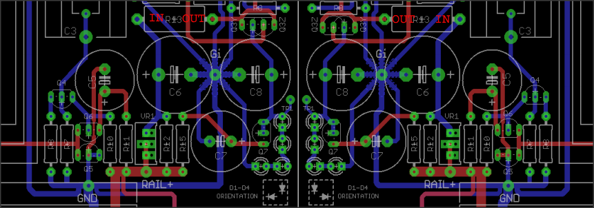

If it still bugs you, there is the active CCS path to follow. Not that complex a modification (for MC,LMC versions ONLY. MM,HMC do not care due to good Tempco high R2 control):
Use a Supertex DN2540 (TO-220 version) set it at 18mA for two 369s. Needs two resistors, one gate stopper 470R & one to find its exact value that programs IDSS on a breadboard 20VDC test for each different Vgs(OFF) DNMOS sample. A 100R trimmer in rheostat mode may help you define it. Make those three parts into a two legged in-out thing and solder it upright substituting R13. Revisit TP1-TP2 setting. Then the 369s will have the designed bias irrelevant to their positive Tempco from the moment you flick the "ON" switch. DNMOS give their own hiss contribution but you can judge if it will be audible in your system context and phono gain.
If you got RFI ingress in your installation, you can either use: A. Ferrite bead usually in a place like input cable PCB side hot, 369s gate legs. B. 1uH inductor in series with signal to a high impedance point (looks like a resistor). C. 10nF cap from input RCA ring direct to chassis within very short distance.
*All the discussed above solutions from active CCS bias to signal RFI countermeasures are additions that may prove also audible for the better or worse.

Those 369 JFETs add little Id with temp rise. The higher the Rs the more difficult for the Id to rise, the less gm is gained with temp. Thus LMC,MC are more susceptible since we keep R2,3 low for extra noise avoidance. Then the BJT cascode will translate enhanced gm=dId/dvgs after Tc settling through dId of Rd (R13) modulating its emitter bias to some little more AC voltage across R4. I.e. your somewhat louder impression after your LMC settling time has passed is correct.
