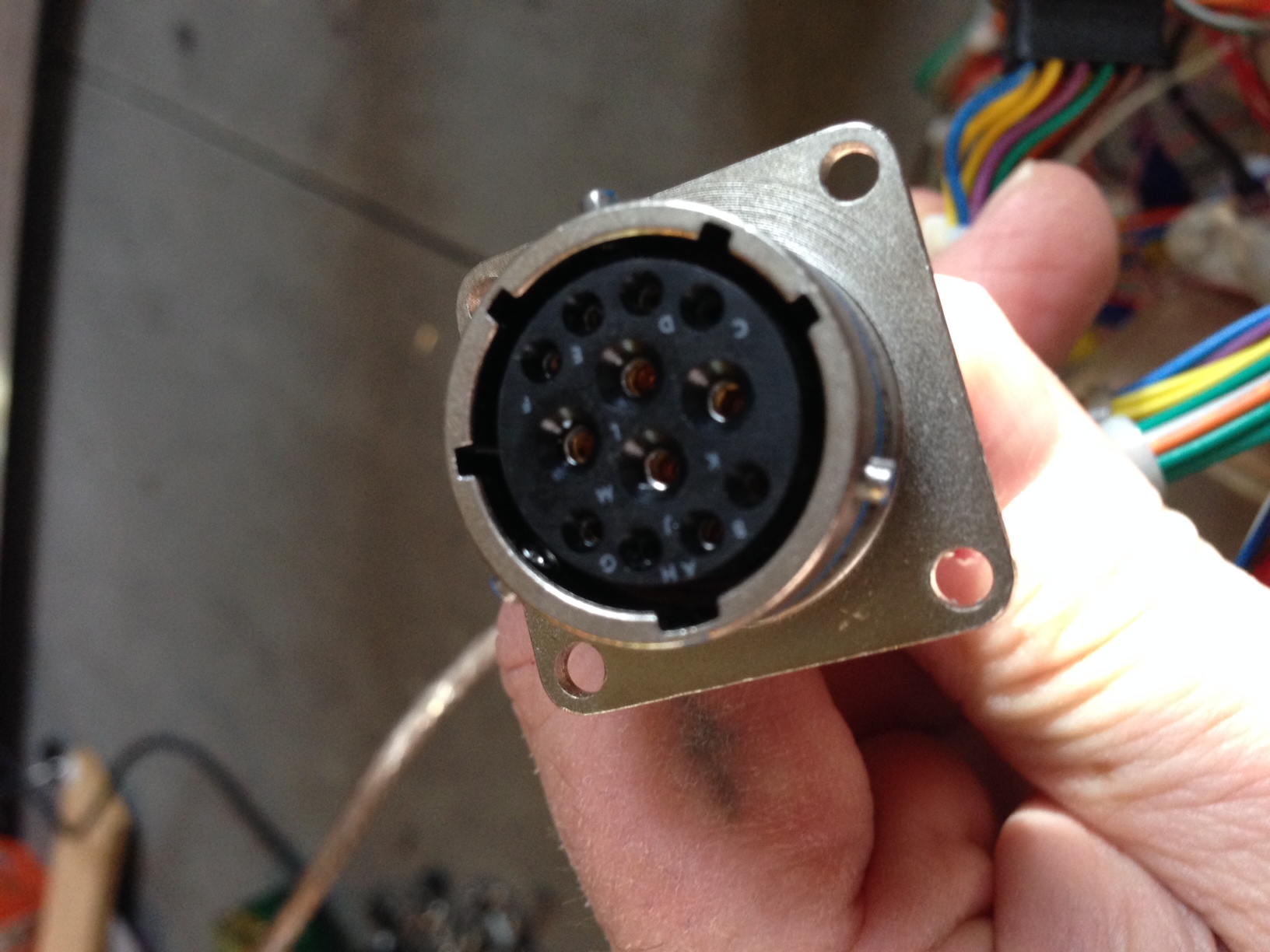

Hi Salas,
Thank you for detailed explanation.

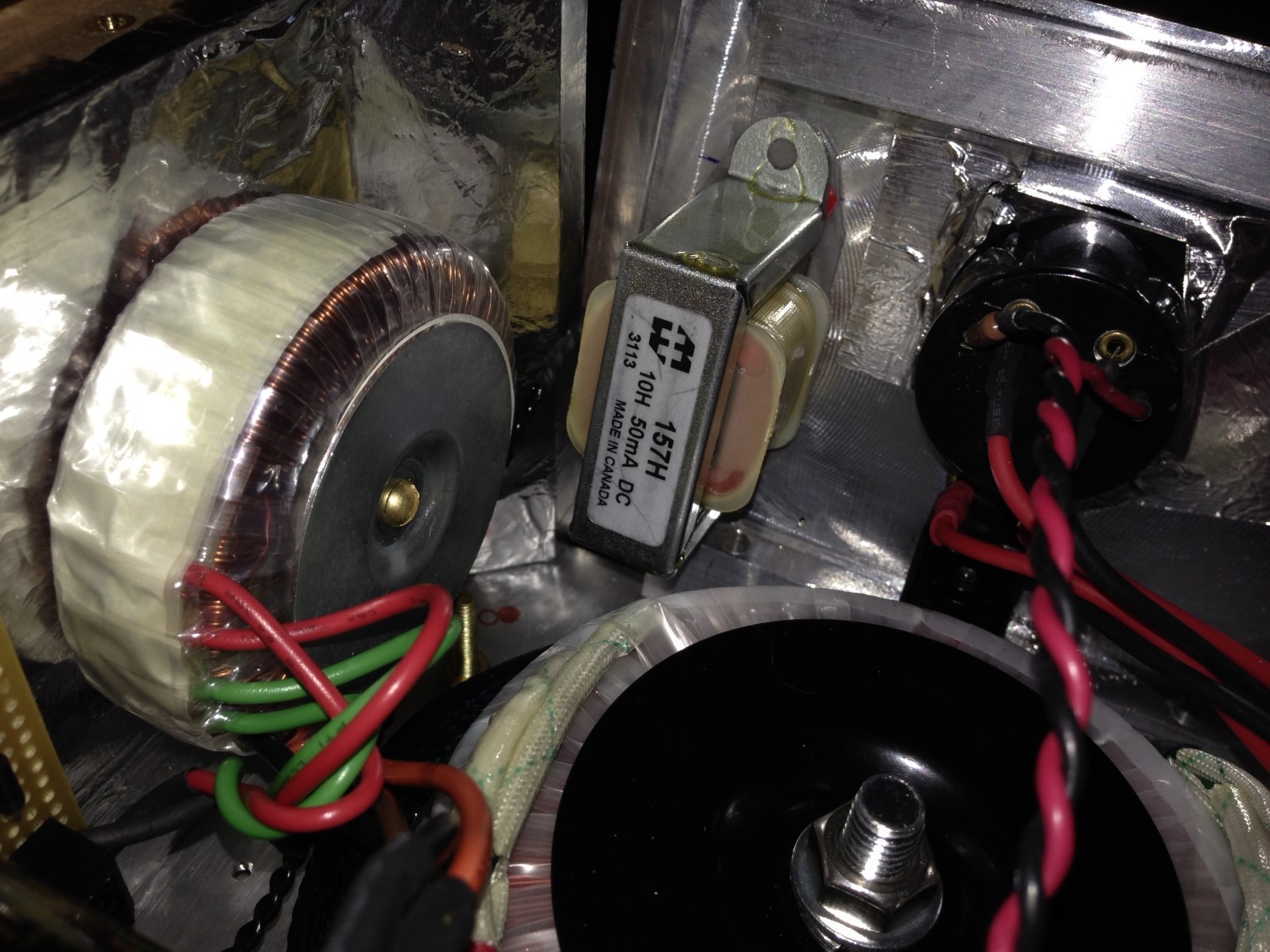

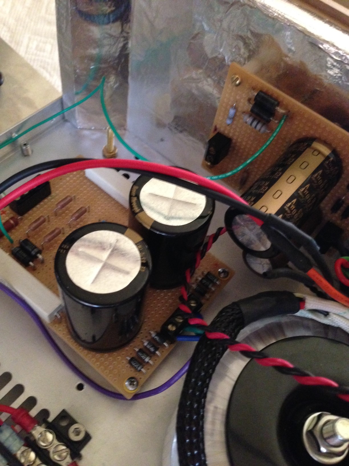

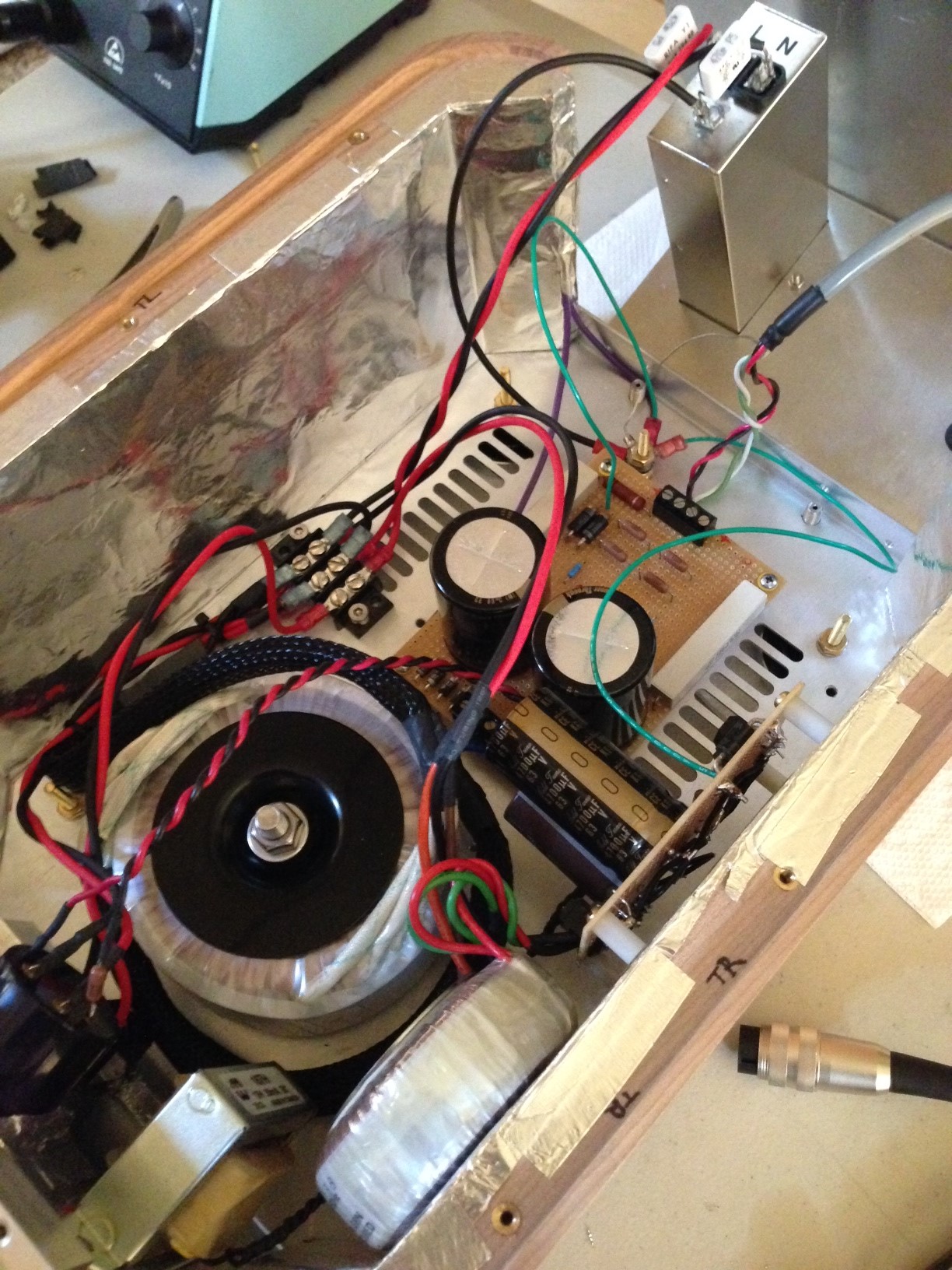

After reading your reply, I wend to my junk-yard and I found new small toroid (18v, 600mA) and built already additional Raw DC line. So, I'm not going to use Folded Raw DC input since I have VU circuit own-independent DC line. Please see attached picture.

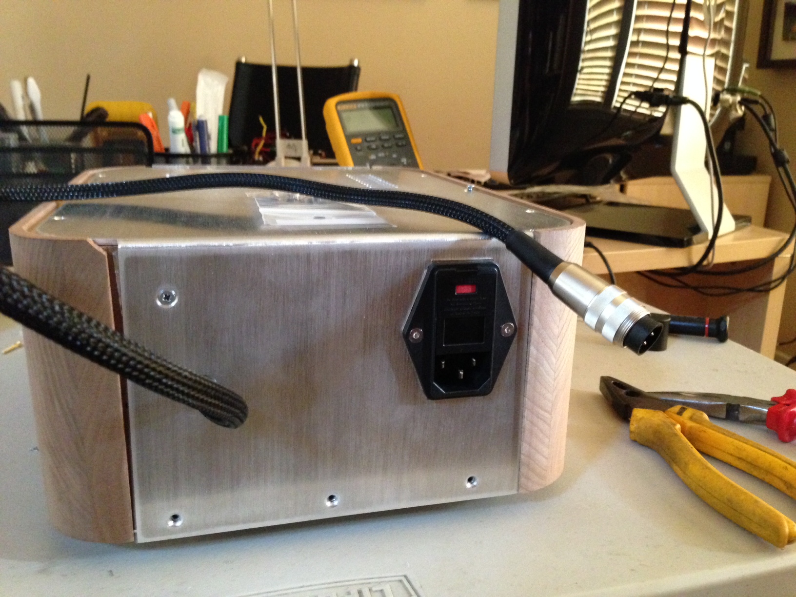

The current issue is the connector from Raw DC to Folded box IN. Till now, I used Lumberg connectors, but I do not have one with 6 lines. I have for 3 and 4 conductors. Do not want to use 2 cables either. I'm going to use more robust one made for military.

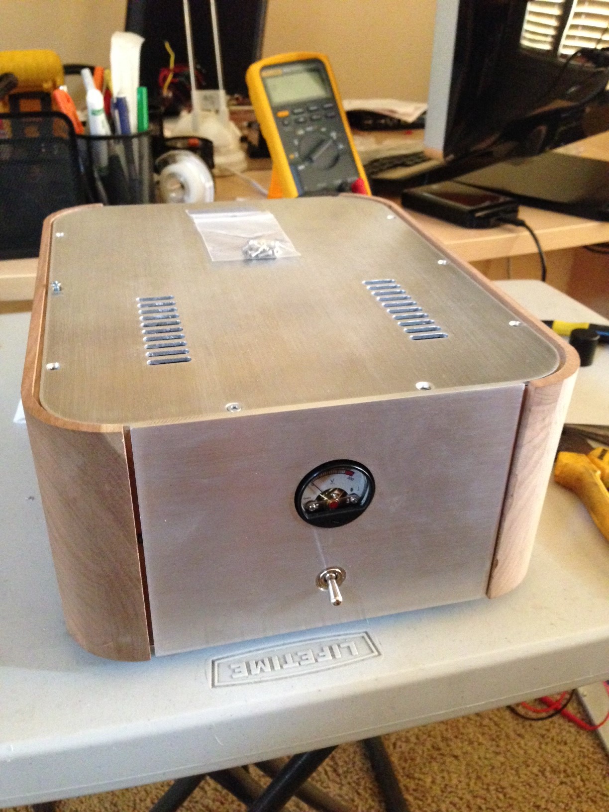

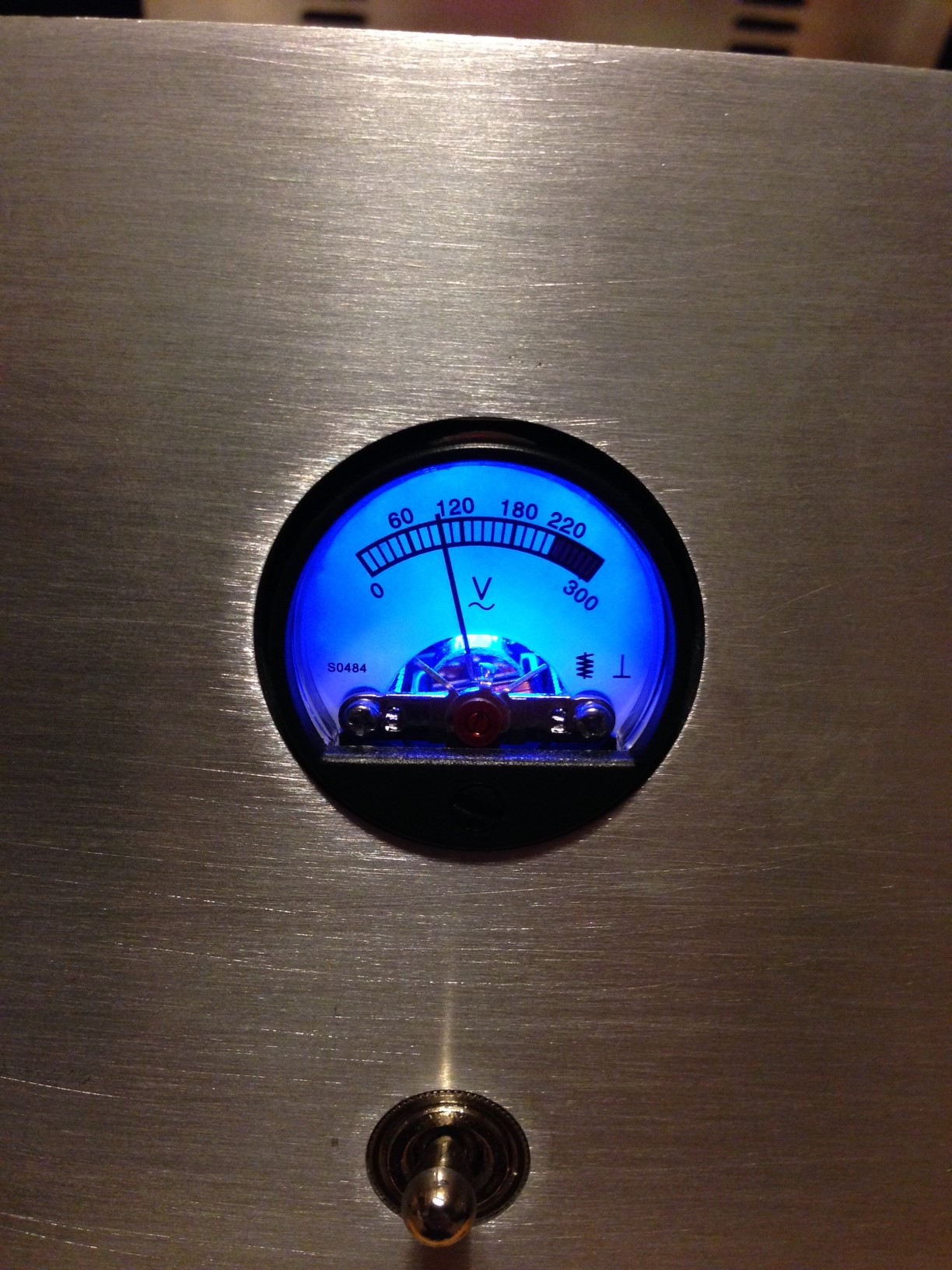

What do you monitor on the PSU's front panel meter? DC voltage or some current?
I monitor AC In. Just as Voltage In indicator.

Is it scaled in VAC or you just judge on some deflection position?
Yes, it is VAC for 300V max.
