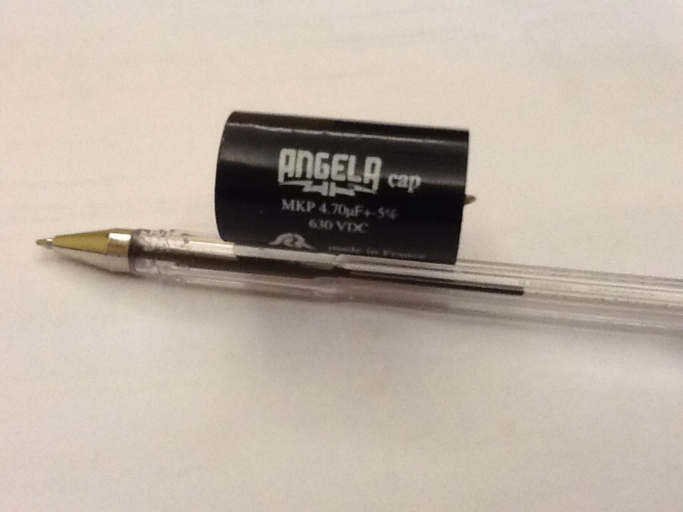

I used these for the 4.7uf caps
http://www.hificollective.co.uk/components/mundorf_mkp.html

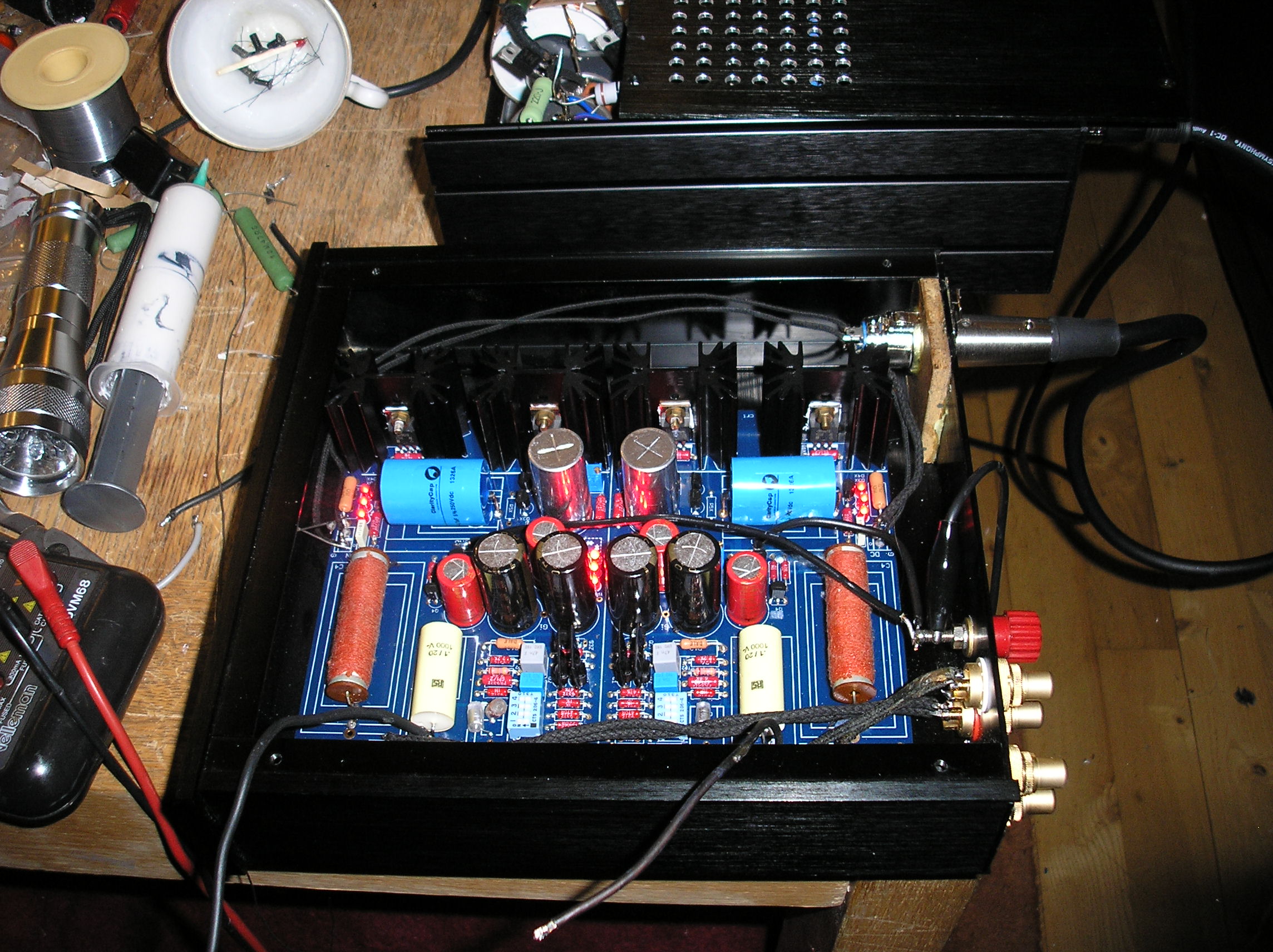

Here is my finnished Build using 2,2 uf 160 V Pept caps instead off the 22 uf.
Touching the box with cover on after 1,5 hour I can not feel it is hot at all. Adjusted to 4 v between. C3 in and Gnd. Adjustement do not change much after the first 5 minutes.
Voltage in is 46 Vdc
Now I am looking forward to hear it somewhere . I do not have a Turntable
