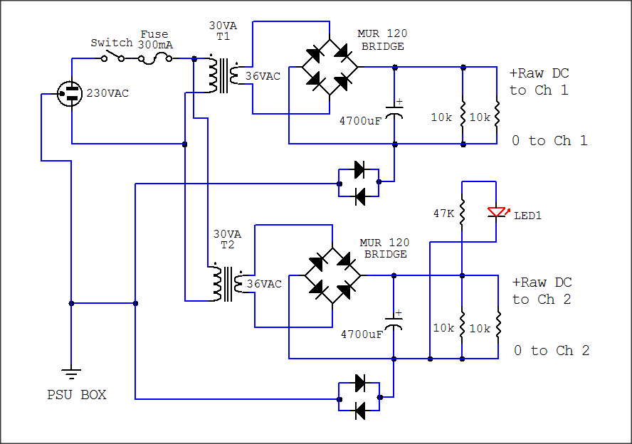

What are the recommended power transformer ratings (secondary voltage and current) for the Folded kit? (An E-I transformer will be ordered from a local transformers workshop).
It isn't for me, it's for a person I recommended to the kit. It may well be point to point I'll do the soldering of the Folded PCB and the PSU. Is there a PCB for the PSU?
I meant asking about the phono itself if p2p so to know the intention of using external regs of higher CCS or not VS the VA rating of the transformers.

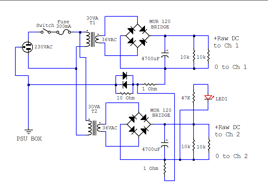

The PSU does not need a PCB. Its very basic. Its ground loop breaking scheme worked for no loops in my system. As in the guide and in the first picture here.
In case it does not in some other systems, then an alternative I can suggest is in the second picture. More I can not predict since the system grounding is a general matter that varies between installations and has not to do with the main phono build.
Thanks, Salas.
The Folded will be installed on the group buy PCB, with the included shunt regulators.
As for possible ground loops, they will be dealt with later, if and when they may come.
