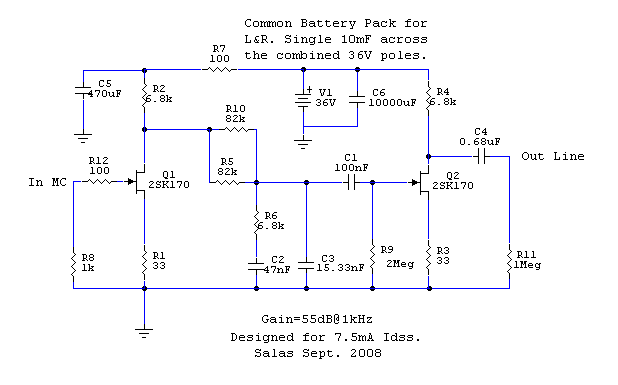

Currently under test
Plays very well with a finely tuned balance between full detail and no hardness at all. It is surprisingly dynamic even with low out MC (0.25mV). No noise. The local R-C decoupling of the first stage B+ for each channel is very audible. Focuses it. Batteries in general are good for noise but relatively Hi Z. Without the 10.000uF on their poles and the local JFET decoupling they create wide band interactions. I used 3X 12V 1.5Ah rechargeable batteries in series. I used Russian Silver Mica, Russian Polystyrene, Panasonic Electrolytics, & common metal film resistors. The 100R gate stoppers are Kiwame and optional. The output caps are Mundorf Supreme Silver/Oil. They were chosen as 0.68uF to create -10dB @ 5Hz to battle record warp. This is when they feed the 50K input resistance of the following Salas 6V6 line stage.
The black thing attached is the schematic. It will turn white when you click.
Tracking the trax
Listened for many hours with the stripped 0.25mV Ortofon. This RIAA sounds hideously correct. I have put a lot of effort in details that don't stick out when you see the schematic. Don't change it if you make it!
The 7.5mA Idss 2SK170BL is used in my modeling because I have seen that the majority of them is 7-8mA. They are matched per stage and side of course. See that you read roughly the same Voltages on JFET drains per stage. Trim the corresponding Rs if some Vd is off the median for a JFET. There is no NFB so that is your ticket to L-R balance. I used a Telarc Omnidisc and I measured the balance from cartridge to line out for L&R. OK.

Thanks nicoch46. I have to see what happens with the Steve Bench tube circuit and compare so to finally decide. Also to set up the Denon DL-160 too. As it is, there is good synergy for tone between parts. No nastiness anywhere. The good thing with the Russian capacitors is that they have great value for money. The polystyrene and mica of the Soviet army can really sing. Some can prove dodgy though. Ebay stuff, you know. I will keep the Salas RIAA of course and will be listening to it. If I decide its best maybe I will scrutinize parts. What is your experience so far? What parts are best for you in RIAA, coupling, PSU bypassing etc?

Cool and a good result.. For safety though I strongly recommend a fuse at the battery and before the 10,000uF cap in the event of an inadvertent short circuit. I don't think you want to see what will happen.. Wire melting so fast your head will spin, batteries venting, and plates buckling, worst case a burning battery.
(Yes I have seen this happen with SLA batteries.)
Your comments about battery impedance echo mine exactly, note also that batteries are not as quiet as many believe, although at the low operating currents of this pre-amplifier it is probably not an issue. Apparently the chemical reactions going on between the plates and electrolyte generate measurable LF noise. (Probably see it best with a very good 24 bit sound card and any of the extant FFT based audio analyzer software.)
Thanks Kevin. True, if not properly decoupled, they can even cycle pump the woofers! Good for no fields if in same box and nice sonics at low current consumption though. Yes I will fuse soon.
