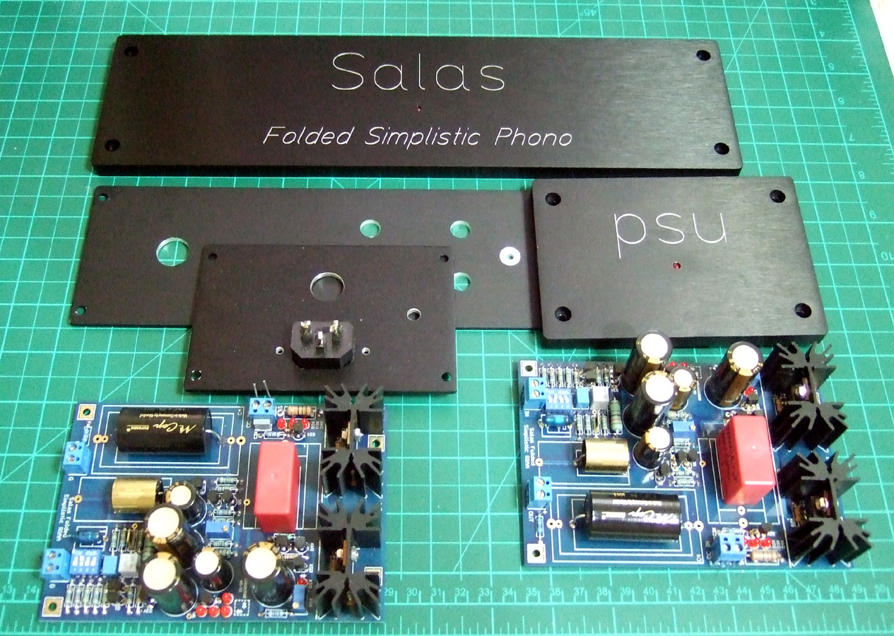

I have now made a rather ugly box for the riia to be shielded when I mount it in the turntable. Problem is that I have grounded and placed it so its really quiet already. And I got an ortofon rondo bronze. So I´m spending too much spare time buying records and listening. Shame. 🙂

First impressions with Diana Krall's the very best, less constrained than opamp pre (finally..), some 30cm wider & taller staging, improvement in depth as well. More weight on her voice. Need to solve, speed (Frim fram sauce..), bit more emphasis on details, and I think heard some clipping ;(.
in all very worthy build, another smiling client here Salas, thank you
any tips for improvements appreciated from you guys
best
Congrats. Listen to more records so to make sure if it was clipping or mistracking. If it was clipping, just get a 15+15V 30VA R-Core whenever you can so to wire its secondaries in series restoring to spec 28V B+ and have proper margin for the regulator. When the transformer and box will be final, shorten its wiring to minimum. Otherwise you got quite a small pcb space so to upgrade in interstage and output capacitor quality. If you like the tonal quality now don't touch those anyway.
thanks, I did intent to play with output & interstage caps, now using erofoli 4.7uF on output and 0.1uF wima mks. Does the quality on 47nF and 15.33nF matter much? quite a pain finding this value.

Changing your 0.1uF MKS interstage to MKP flm & foil like Vishay 1837 keeps small and may prove audible. Quality electrolytics too. But its also about synergistic tonal blend beyond resolution, sometimes lower quality parts can strike a fortunate tone with the rest and the system. If making partial exchanges keep subjective notes so to can revert. Start only after you are well familiar with what you got and its electrolytics have worked to reformation.
You read my mind, I did change wima to vishay 1837 as per your last PTP built🙂, audible it is, better clarity and nice extended decay. Still have bulky russian K75-10 for that position to try, it will wait until my riaa settles

-I have finished the PCB corrections with CRT and got the final file.
-The panels for my proto have been drilled for connectors a few days ago.
-I will build it soon so to watch it working in real conditions and maybe trim some value. I expect no problems, but you never know.
-Then I will write a smallest possible build instructions PDF with final notes.
-So it will be ready to be released for GB pretty soon.
