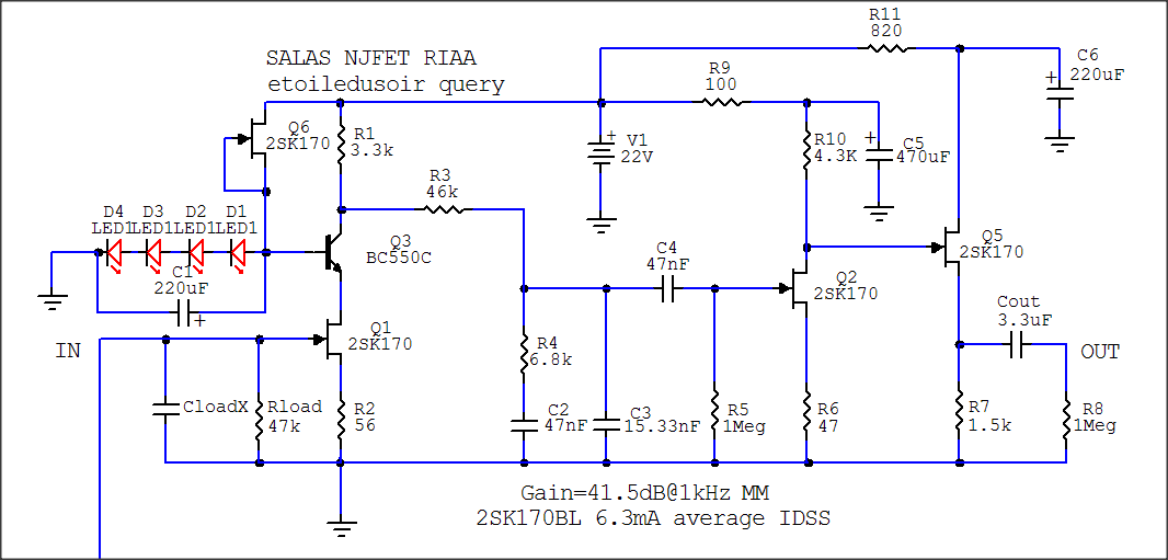

So here we have Rev2 calculator.
This one incorporates a simulator for the 1st stage of the folded cascode built with two K170 in the input.
If it passes the sieve, I can add a sheet with info for the 2SK369 buids.... just need some input on possible Idss / Vp data.
It is interesting to experiment with different Idss... if we choose an Idss higher than 8mA, the value on the trimmer becomes negative, indicating we must increase Vdd or slightly lower R13.

Am i right that the current through that branch is limited in that is proportional to the total resistance. If limited to 10ma through the branch, and youhav a jfet taking up 8-9mA, then you do not have enough left to drop a voltage across the collector of the bjt, as it is getting eaten up by the Jfets, the Jfets Rs, and the forward drop of the bjt base. Increasing the B+ voltage increases the total available current in proportion with the increase in voltage/resitance.
reading that again, it makes no sense, but i think its close
Its nice if some of you grasp the works and can predict/tune for different biasing semis but in general for the most builders try stick to the given IDSS and B+ region as in the recommended circuits, and they will work right up.

Should be following reality for gain quite well this revision. Try verify on your builds too.
Grasp might be a bit strong, but then again, grasping does seem to define what i do most days here, pretty well🙂 Building my second will be strictly by the book, as it is so much easier when you follow directions. Plus, I have a feeling that you have put a lot of time into getting it ready, and that includes tweaking it to a happy medium, sound wise. The calculator by Rcruz will be a nice and handy tool . On the second build, I am adding a selector switch to be able to tune the input resistor. Easier than resoldering smd over and over again.
You are right.... if you follow the pdf, you can be sure to get the most out of it.

Salas, or anyone. I am trying to add a selection section for the load resistor on my board and was having trouble finding the vertical pin connectors that allow you to bridge two with a square sleeve. Any ideas on a number from mouser. I don't know what they are called or how to find them.
Its cut off male pin header strip bits and mating jumpers like those on motherboards I used once in a build asking for that facility.

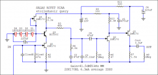

I'm refering to the shematic in the wiki:
Salas Simplistic NJFET Riaa Schematics - diyAudio
Sorry for the ambiguity. Maybe i'll be more clear if I describe what I really want to do.
I'm using for now the shure m97 cartdrige and I have a bunch of 2sk170 matched at 6-6.5 ma that I want to use.
All Jfet drain pins are looking north towards B+. Good luck and let us know.
