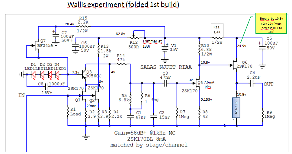

I am in the bermuda triangle here.
Top of BF245 12V
Base and emitter of BF245 - 8.1V
Used pot to get emitter of bc560 to 8.1V
Nothing on collector.
Jfets have 31mV acorss 3.9R source resistor.
Output gain fet has 4.7V across drain. Same thing at output, as the cap and pull down resistor are not added yet.
16V at top of the buffer.
R5/6 sitting at 6.71K
This thing should be working.
Gonna try the other channel. Just does not make sense.
diyAudio Chief Moderator
Joined 2002
Yes. You should have half the BC560's emitter to ground voltage on its collector to ground after trimming, ~10V across second stage's Jfet drain to ground, for 35V to ground B+. Also the BF245 looks like drawing much. Either isn't an A type (lower IDSS rank) or its a short.

Here you have my measurements... appart from output buffer, it is the same as yours.
