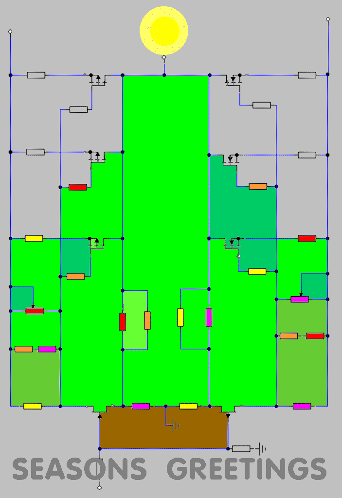

That's a 3.5mV cartridge so use the HighMC/MM from post #4945 pdf guide with an R2 value of 47R for 41.5dB gain. Folded version in this circuit is not optimal for MM level due to various technical reasons.
Seasons Greetings
