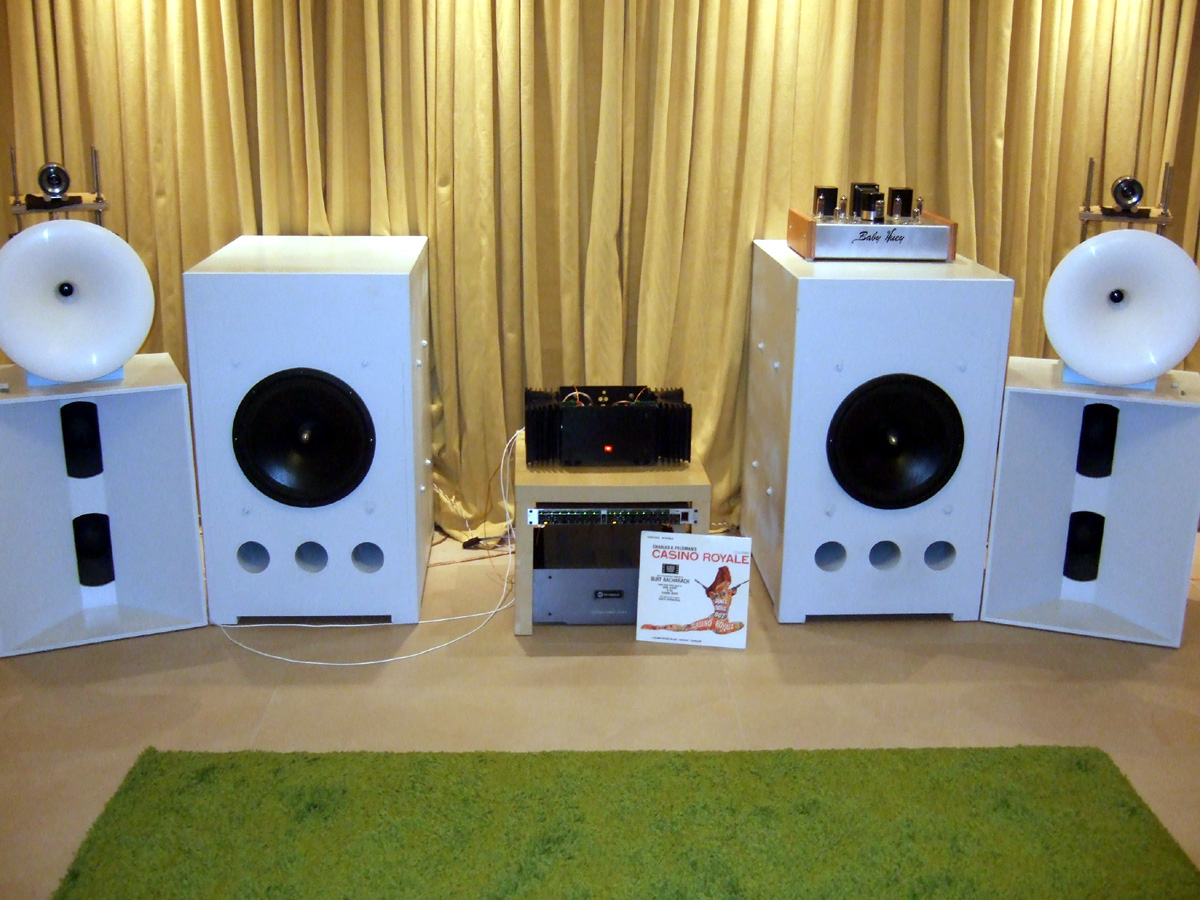

Hi all!

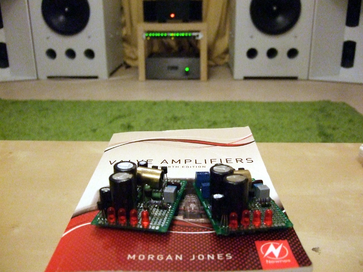

As promised, here is the report of the folded simplistic proto build, evaluation & more.
To make a favorite better and not to detract something is a careful job. And it takes tools to evaluate correctly. Some inspected and able tools. The tool in this case is member's Vgeorge system at near Athens island of Poros where he resides. There was a standard simplistic operating there for comparison, lots of vinyl, a dedicated audio room, and a modular horn loudspeaker system with active subwoofers based on Lynn Olson's Beyond The Ariel thread general norms. Also a Baby Huey EL84 symmetrical amp, plus a newly put together TSSA V1.6 current feedback Mosfet Class A DC coupled symmetrical amp, made from Sito audio PCBs.
Since I had also designed the crossovers for those speakers and had familiarized myself during an older visit, George and I thought it would be a nice test environment to make and subjectively evaluate the Folded Simplistic.
We arrived on Wednesday. We relaxed a bit, then a whole system test, tune, and subjective clues refresh strategy was put into practice.
Step1. Check with my calibrated mic for reference. A ribbon tweeter was used for that.
Step2. After house curve measurements and tweaks to even out the active subwoofers and midbass horns power response in the room to the best of our estimation and agreement, some lengthy sonic familiarization session took place firstly. Baby Huey was doing the drive duties for now.

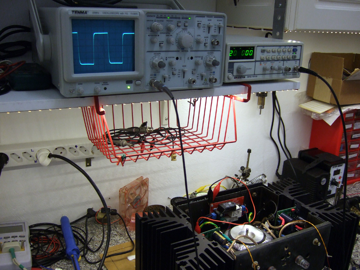

Step3. Alignment of George's scope for vertical and horizontal, checks and evaluation of the new TSSA V1.6 amp. So to decide which amp gave the most resolution and tone for comparing the simplistics to best ability later.
Bias, offset, and 200kHz square wave tests for TSSA V1.6. That amp proved wide, did 2.5MHZ -3dB. Took its place for evaluation in the system.
Wow! It gave such a resolution uplift in complete tone smoothness, musicality, and dynamic poise, a gift to our Riaa preamps careful comparison intentions. Much auditioning followed to grasp the new level of subjective parameters till late in the night.
Next day the weather was windier and moodier, a nice day for starting the Folded Simplistic proto build.
The system was left on and warm all the time, the standard simplistic to be freshly re-listened before any substitution was waiting too.

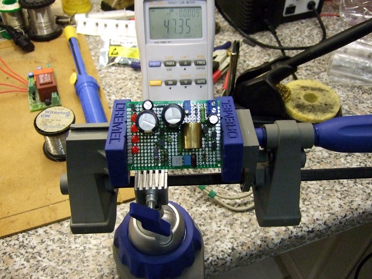

Step4. We retreated to the small DIY room, radio silence was ordered for ears to relax, until we would be ready with a proto Folded p2p channels pair to evaluate.
We opted for two small boards double mono plan for layout compactness. George had already prepared matched JFETs and passive components, I decided the placements, then the building went on and on in good team work. After 2-3 hours and some connections verification, some DC levels and AC signal checks, voila! 7x5cm proto
P2P replication for next channel
Step5. Fresh listening session with a handful of chosen records on the standard simplistic while the folded boards were waiting for their turn patiently. They wait...

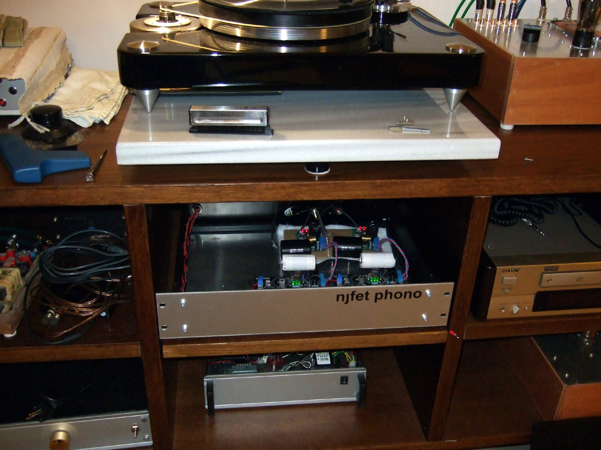

Step6. Housing in the existing phono box so to have the same PSUS and general config. Some step down of the SSLV1.1s Vout to 35VDC, first stage centering of the folded DCV bias.
Installation and initial listening was time to begin.
Hey! Something very nice was happening! Instant agreement that we were onto something really good. Background noise went down sharply on the already quiet 100dB+ horn system, no hum or buzz without the lid on even, bass detail and slam came forth, focus & resolution boosted drastically without any loss of the simplistic identity. We listened till 4AM...

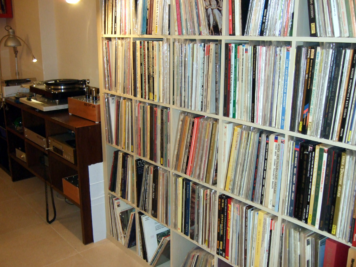

We decided to dedicate the next day to more listening with more records, ranging from Norah Jones to full symphonic so we would nail it well. Enough vinyl supply...
Weather was sunny again, was Saturday morning already. After coffee we started in good spirits, fresh and not tired from building like in the night before.
Confirmation & agreement, disc after disc. It was obvious to the best of our judging ability that we really liked the sucker. Nothing to tweak. Tone was perfect, not a trace of harshness. No Riaa cap value tweaks no output buffer design changes. True, that system was on particularly good amplification and general alignment by now, but it ought to be, that is why we bothered preparing it so much. So to make no false compensation in the Riaa preamp regarding shortcomings in the system. Thus I consider the circuit I include in a small PDF with basic instructions as final, with values that are officially recommended.
Step6. Success cigar was in order.😀
Step7. Some tour of Poros, good food and departure late in the evening thanking Vgeorge for his great hospitality, gear, hobby fellowship, and input. We will meet again some sunny day.🙂
Poros city harbor view
End of report folks! Thanks for reading.

Splendid "reportage" Salas
"Hey! Something very nice was happening! Instant agreement that we were onto something really good. Background noise went down sharply on the already quiet 100dB+ horn system, not a trace of hum without the lid on even, bass detail and slam came forth, focus & resolution boosted drastically without any loss of the simplistic identity. We listened till 4AM..."
Now you know what I have here 🙂
I only count three transistors in the second stage... so you dropped second stage cascode right ?
Did you try the "old style" k170 loner buffer ? Or you liked the k170 ccs in the buffer ?
PS:
JG is cooking the TS... we need your help there also 🙂
PS:
I dropped the second stage cascode to keep same tone to the old was an earlier decision anyway as you know, but the "new" buffer remains. No hyper detail, only power. Granted this is the 2SK369 input original proposition and the system was smooth as butter and resolute as a starry night. In other systems or with K170s input stage your mileage may vary, but based on what we heard in Poros this one we tested goes down official. I put much thought in ways of evolution to arrive to the principle of what you have there, your early adoption and faith to put time and work into it is appreciated. Still I had to do final thorough own subjective test of course. You know I avoid to recommend anything before I fully verify and tune down to my own ears. Your early impressions proved in line nonetheless. Enjoy.
