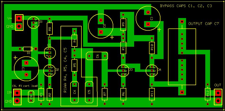

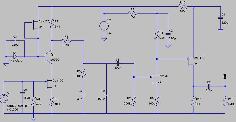

Well, guys, I think I might be ready for the phono pcb. Any suggestions/opinions welcome.
And here are the files needed to print from expresspcb to create a board.
The way I create a board is by printing on a laser printer onto glossy inkjet paper. I'll outline the procedure, might be useful to someone.
1) add a printer in Printers & Faxes, setup for darkest possible printing (under printer preferences)
2) add another printer, also on darkest setting, but change the preferences to Mirror, so that you can also print the silk layer on top of the pcb
3) load the .pcb file in expresspcb, print the bottom layer on the printer setup in 1)
4) then print the silk layer and text on the Mirror printer setup in 2)
5) clean up the copper side of the board with alcohol, or acetone, and then place the printout on the copper, on top of it a clean sheet of paper, and heat up the iron a little lower than the cotton setting. Iron the printout carefully for about two minutes, making sure that you press pretty hard, especially with the edge of the iron across the entire board. Also, make sure the iron is not set on steam.
6) let the board cool completely, and then carefully remove the stuck printout; I do it under water, and rub out with my hand as much as possible of the paper, making sure that anywhere I want the board to be etched, it should be clean of any paper.
7) etch the board in etchant
8) clean up the laser toner printout from the board with varnish thinner
You can get professional looking boards this way.

Layouts
ikoflexer,
This really great for idiots like myself.
Is it possible you can save those two layouts you have done in bitmap and post them up. Then I can just go over them removing the parts and print the tracks off with my laser printer and iron them on to the boards.
Thanks for doing this layout
Brett

for ground route good pratice are
connect direct the in&out RCA gnd
connect in gnd RCA to pcb gnd
use the out gnd pcb only for screen without connect the wire on RCA out gnd
if you want do this are better put the pcb in the parralell to back side of box ,for very short wire....(RCA for pcb ?)
inportant are put the trafo in separate box ,if you do, use EI split coil ,cheaps and are good filter for dirty AC.....
box better alu , hammond diecast are cheaps and good for RFI

If you want thermal tracking then instant glue the faces together and bind around the pair with three turns of thick copper wire.
I recommend that all pairs of transistors in LTPs and Mirrors be thermally coupled and that care is taken to ensure each half of the pair pass identical currents.
Re: Layouts
Brett, I can post bitmap files, sure, but I found it looses size information when printing. Nevertheless, I'll post those files a little later.
guys, about the thermal tracking, do you mean J1 from left and right channel be bound together, J2 from L and R channel be bound together, etc.? Do you really think it's worth the pcb yoga to accomplish this?

How about pdf? The thing to be careful about when printing the image, is that there is no shrinking of the image, or otherwise fitting it to the page in any way. The size should be left like that.

nicoch46 said:HI Salas
Is important to put the jfet face to face for a sort of thermal traking...???
Not in our phono. There is no dif amp.
ikoflexer said:Here's the silkscreen.
Bravo Iko! Good sharing work! 🙂
P.S. There is already a 46dB version based on that schematic posted for high out MC 1mV for RCruz back in the thread. If someone needs another gain, let me know.

ikoflexer
Sweeeeeeeeeeeet as,
I'll print these off and see which one measures up correctly
Thanks for putting the 1cm on.
Brett.
Probably the same pcb can be used, just with different part values?
