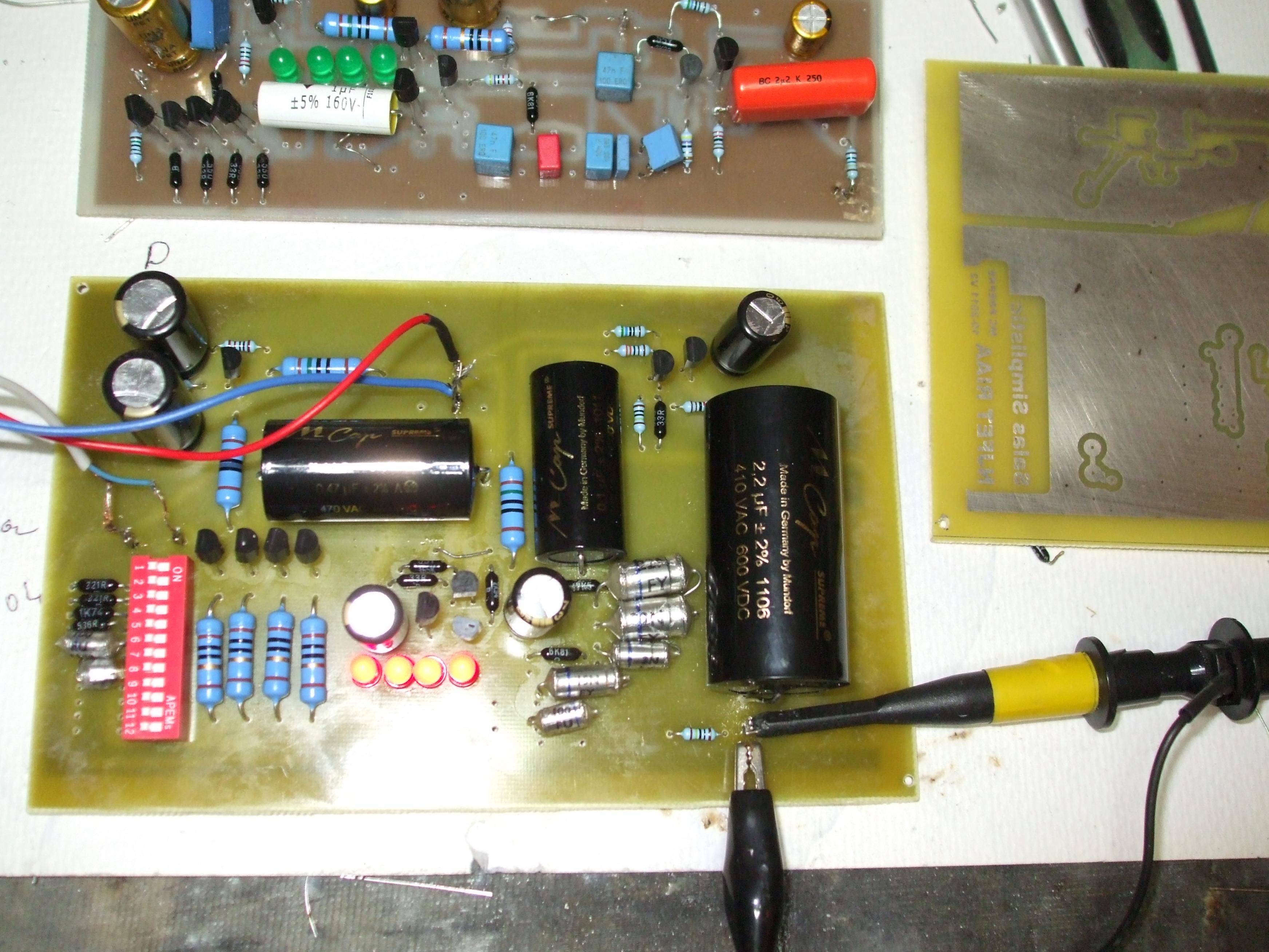

Hi, the input cascode voltages are OK from those you measured, but your next stages are squashed for voltages. In all cases we debugged in the course of this thread it was always a matter of wrong connections not following the schematic lines correctly, excess solder making unwanted shorting, rarely a wrong resistor value or a dead fet due to overheating in assembly. Examine thoroughly all of the above. Good news is they all worked in the end bar none.

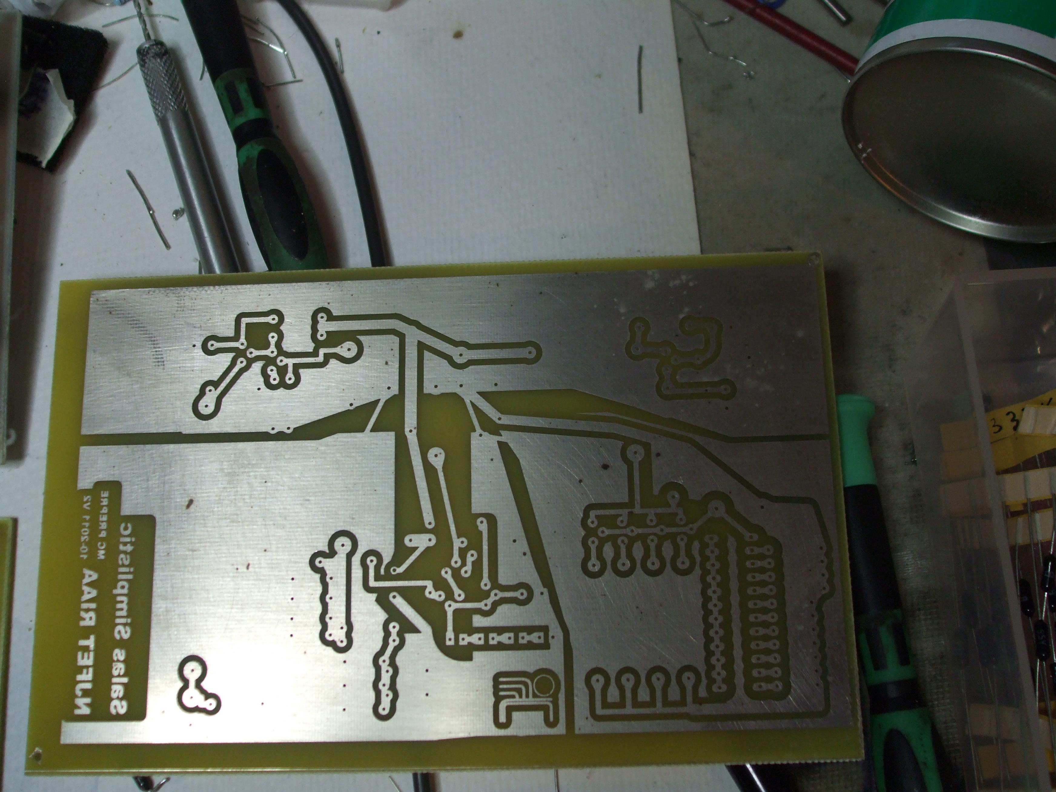

I got the Reflektor board etching away and the second PCB todrill and stuff.
Main thing that realy amzed me ....
It woked straight away

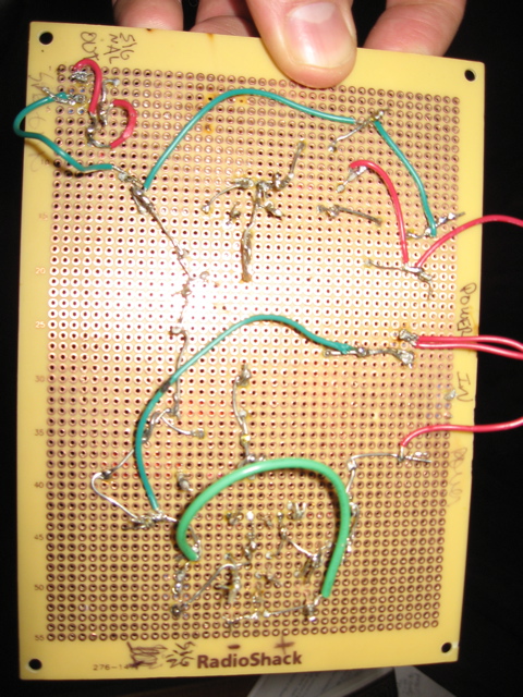

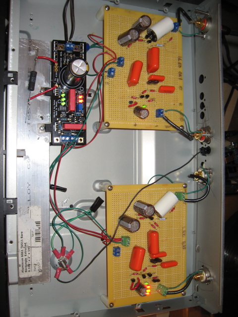

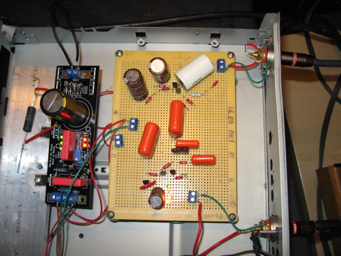

I am attaching some pics of the amp and the one channel.
I am trying to build Salas Version 1.0 MM Version for my Sonographe SG-3 with a Shure M97x cartridge. I have also been using the wiring layouts provided in the 1.0 pdf files.

On initial power up and testing, I got no sound. I rechecked my wiring and looked at both the schematic and Ricardo's drawing and saw that I miswired R8 1m. I fixed this and tried again but no sound.
I read some posts where you mentioned measuring the drain to ground voltages so I measured those. You told me that q2 and q5 had problems. So I unsoldered, reconnected and resoldered the connections and then I got the correct voltages. This is my problem on the other channel. I tried the phono amp again and got no sound.
I rewired some of the ground connections, rca jacks and power connections. I reconnected the amp to my stereo and put on led zeppelin 2 and heard sound very faintly if I put my ear next to the speaker. If I turn the volume all the way up, I can hear from a few feet away.
I read some more posts where you mention using a 1k test signal. I am not certain if this and a DMM can help identify the problem. I should add that I used a DMM to test continuity throughout all this.
I think the problem is my soldering skills. This is my first attempt at p2p besides the simple lightspeed. I have only worked with pcbs for the bugle, tubelab simple se and salas bibs previously.

OK. In your shoes I would try the simplest of tests. To attach the DMM on input RCA and read the load resistor for instance. Or on the output and read the output resistor to ground. Else maybe a short in cabling. Another one, can there be a muting to ground along the way by accident? Can there be some wrong resistor value? The fact that you worked some connections and got right voltages, points to practical matters. Review those links against the schematic. Not against some board from the first pdf. Just try to follow the lines with the continuity probing.
