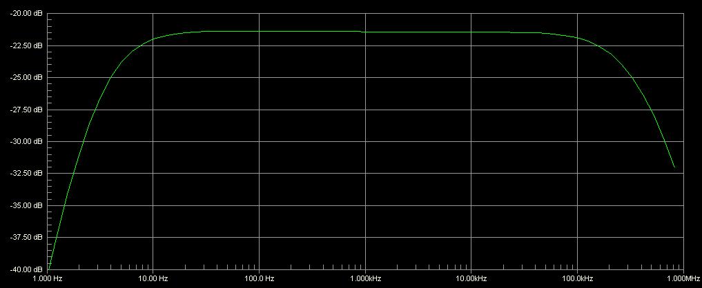

The VLF roll-off is largely pre-determined by the inter-stage cap's value to 2nd stage's input impedance. The output capacitor to next in the chain impedance will aid further. In phono, rumble is a problem. 2Hz -3dB argued in that link can be nice in line stages, plus it sells bigger boutique cap$. Your CCT along with 2.2uF output cap to 27K input Z line pre or amp, is simulated. It gives a shape as shown attached, when fed from textbook Lipschitz inverse Riaa. Measurements in previous builds showed that the modeling is largely valid. I think you mentioned you could already follow the beyond 100kHz roll-off on your scope even.
Yes Salas
I can see now that using a bigger capacitor would have been a mistake.
I take that as we are dealing with Jfets (hi impedance in) those are mostly set by R1 47K and R5 1 M and in my case with prepre 220K

Its good you got gain. Hope it can do enough SPL for you on F5 alone even. Just decide an adequate capacitor good for rumble for your next stage most likely to be used. See that the bass is enough and male voices are full when no woofer cones are pumping much by records eccentricity etc. and you will be well set. That minimum value will up detail and leave dow for better quality when ordering your better one. Most important than parts, make its shunt PSU.
