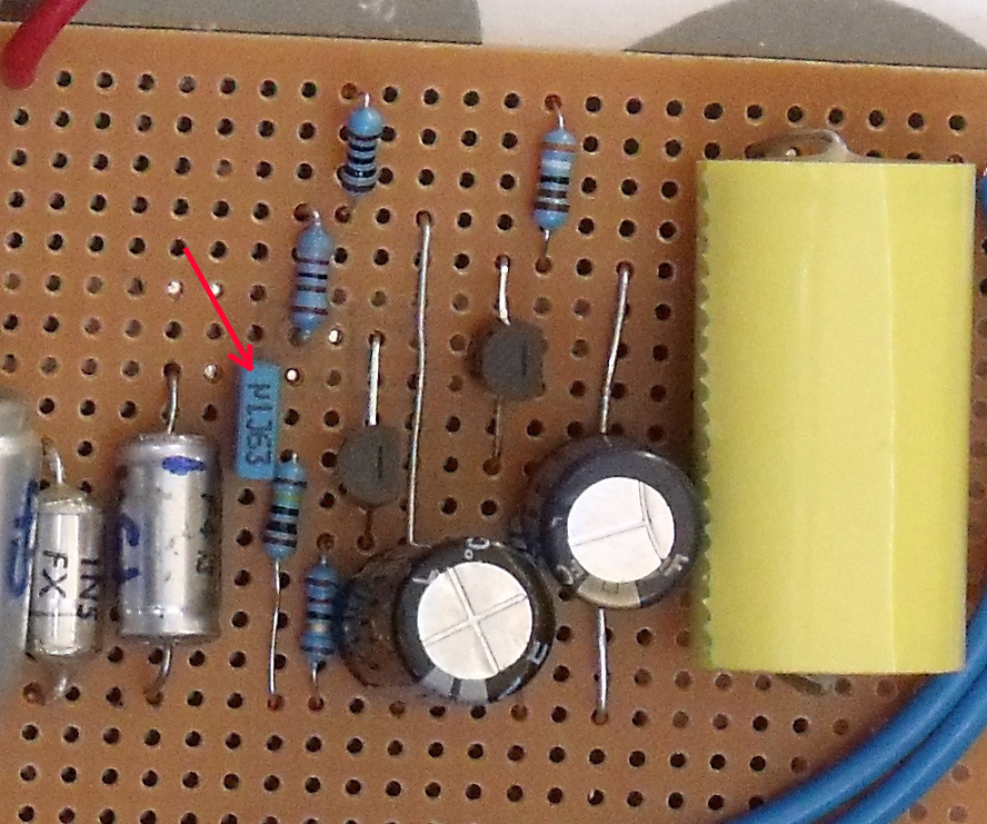

Hi Salas, it was a 100nF MKT initally, I've replaced them with a 100nF polystyrene now.
Yes I agree it does sound very analytical, I think this is a trait of all AT cartridges. I also have a Denon DL-304, an Entre EC-1 and a Dynavector DV 23RS which I will be getting rebuilt. All of these are more evenly balanced than the AT (but the AT worked really well with my old phono stage)
How is it on your TDL speakers? Is it well tonally balanced, has good projection, bloom, detail, in right proportions? If yes, don't try other parts.
P.S. Just saw your edit about carts available. If you can get a couple of cheap 0.1u K40-Y ebay Russian paper in oil to try for interstage, they could possibly mellow out the AT & polysterenes combination a bit. Alternatively you can add one or two 100pF caps parallel to your Riaa HF cap (15n) step by step and see if it rounds a bit just before getting out of proper HF balance.
I'm currently using my Kef Reference 103/4 that I've re-foamed and upgraded the crossovers, the TDL's are in storage. Power amp is a dual mono HackerNAP (NCC200/Naim circuit with front-end regulation and optimised layout), Yes it is all tonally there, it is just so much cleaner than any other phono stage I have used.

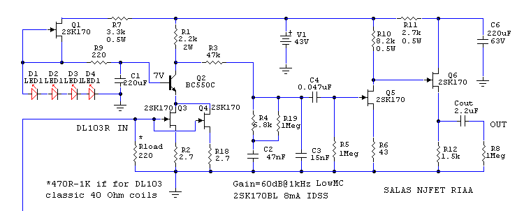

Thanks Salas
Salas: so can I go on with this last scheme?...

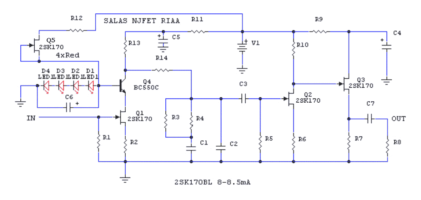

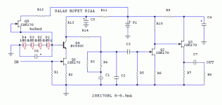

the pics attached to the last two posts display differently.
post6795 replaces the DIYaudio window to display an out of focus 26kB view, whereas post6796 expands the pic over part of the DIYaudio page and allows the pic to be moved around to enable the post to be read. This pic is only 8kB and yet the detail is crisp and legible.
Because of this difference in display it is more difficult to compare the two schematics.
How can this "replace DIYaudio page" be avoided?

Yes do that. Its one piece, easier for you. df_genius had very good gain with Entre EC-1 0.2mV with a one piece 60dB, also very low hiss in as much we could understand from his .wav files.

Was embedded, got it out 4U.
