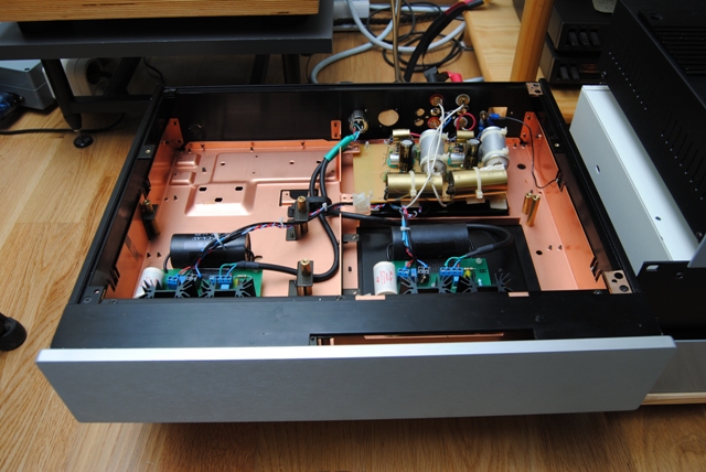

That RC Its not used in the pdf guide circuits as well. That ''prone'' to hum smells you had oscillations in those 1.2s. Making such regs P2P without oscilloscope is Russian roulette. You are quite adventurous to had done all those builds without scope and FFT I must admit.🙂
Well, if you remenber, I had big trouble with the "Optimae" version and V12 initial builds.
Some of them whistled and produced hum.
After various atempts, I figured a way to tame the circuit by placing a star GND near the EL output (-) leg, very close to the mosfet.
It can only be done p2p, otherwise you would need a severall layer pcb 🙂
I already built 10 of those with great success.

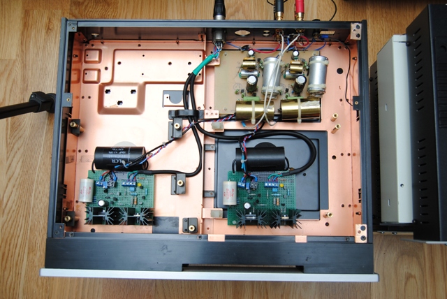

I did not try a ground plane.... I just made 20 or so layouts until I found the best working one. I implemented a "flying" star GND very close to output mosfet Drain.... I also experimented a lot on output caps placement until I got it working allright. Now I am sure I can do it repeatedly with success.
PS:
Just for fun, my latest implementation... I used an RIP DENON3300 CDP Case to place the benz riaa.
It uses 15.7nF FT-1 and V12R shunts.
The case is HEAVY... it even has two black plates (just to add weight) that were placed under the CDP PCB´s.
Sound is amazing.
Sound is amazing.
