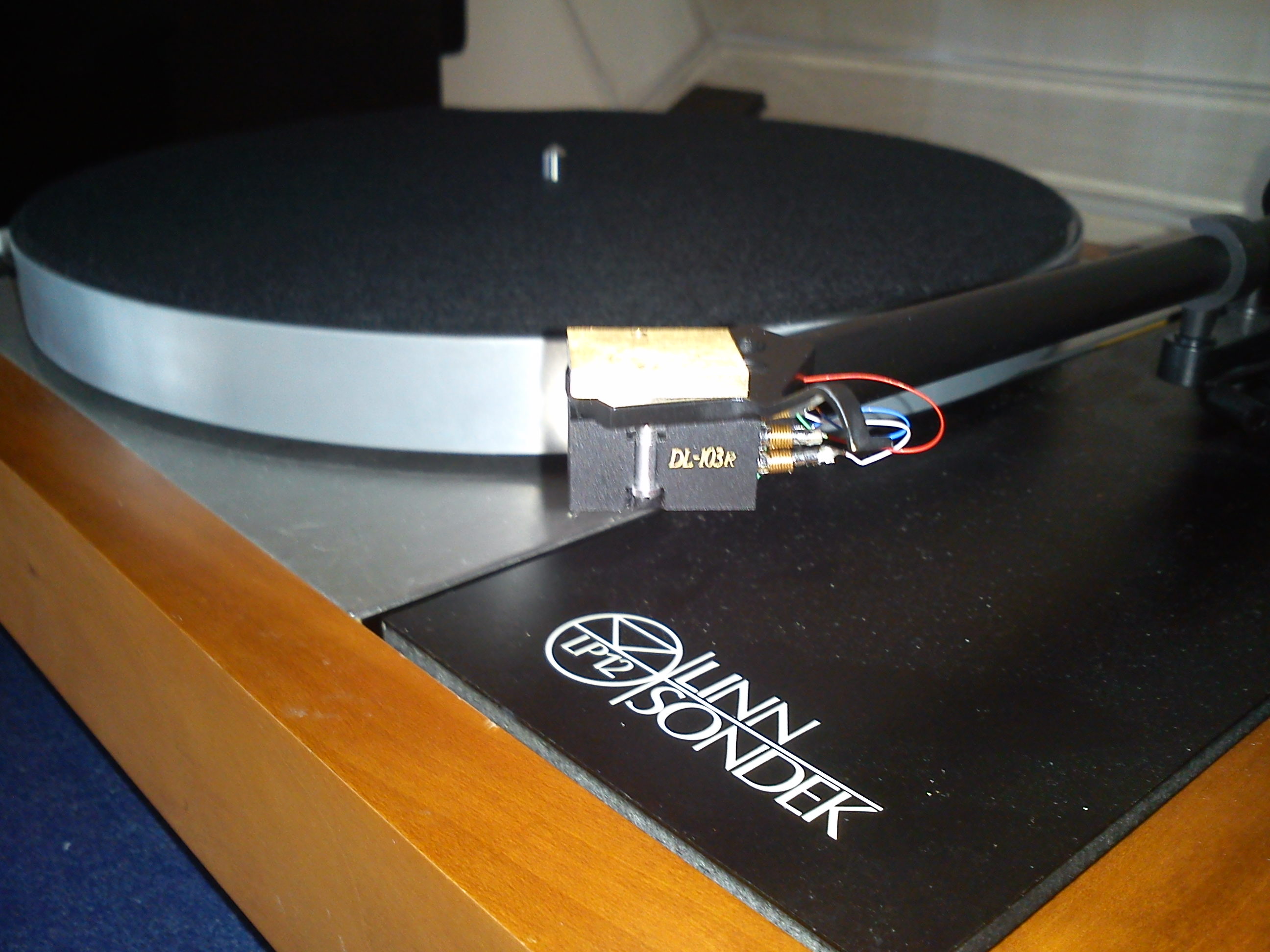

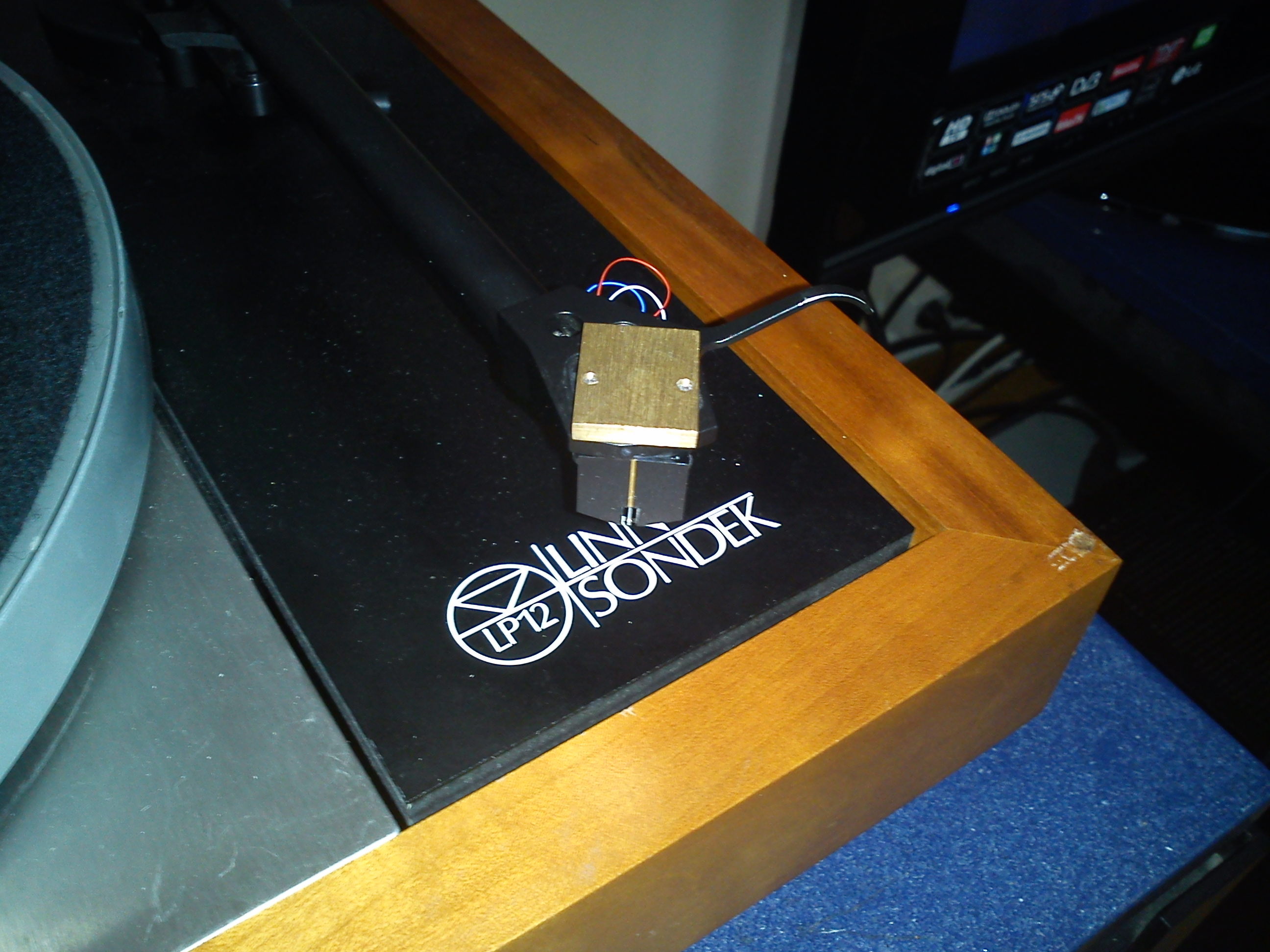

Mounted & adjusted ready to play

All our fun is thanks to your Simplistic NJFET RIAA:D, I recommend you to increase your effective tonearm mass with isokinetik 8gr brass (If I remember well your tonearm is like my Linn Ekos with mid effective mass) or 3gr don't need to be glued or to adjust VTA tonearm if you do like my pic & you will arrive to Olympos:D
diyAudio Chief Moderator
Joined 2002
I have a Mission 774 actually (John Bicht of Versa Dynamics fame sold that design to Mission back then, could be made by Jelco, many British arms of that era were OEMed in Japan). Problem is if I will increase the mass that far away from the pivot point, the counterweight will not suffice. Its already unwound a lot. If it takes some lathe work for reinforcing it with a brass bit, then a front end flat thingy will be easy to diy also. What is your total mass now including cart?
Fortunately my Ekos counterweight is suffice, another idea it's work without counterweight;)
Tonearm 11.5gr
Cart 8.5gr
Isokinetick brass 8gr
Screws & fasteners 0.5gr
Total 28.5gr
The Denon DL103R compliance rating: 5x10-6 cm/dyne (at 100 hz) at 10 - 11 hz has been calculated to be approximately 11x10-6cm/dyne so now I have a tonearm resonant frecuency of aprox. 9Hz:)
Isokinetick do another to added only 3gr

Did you determine true DL103r compliance using a test record ?
I believe it was proven to be much higher than that.
Tested the real cartridge/arm vertical resonance with Hi-Fi New Analogue Test LP result: in the middle between 7-9Hz so I assume 8Hz aprox. (not to far my calculations), doing again calculations I calculated for 8 Hz a real compliance cart of 13.5 (not 11 as The Analog Depot & not 17.5 my previous calculations you linked)
See here: http://www.theanalogdept.com/denon_dl-103r.htm
