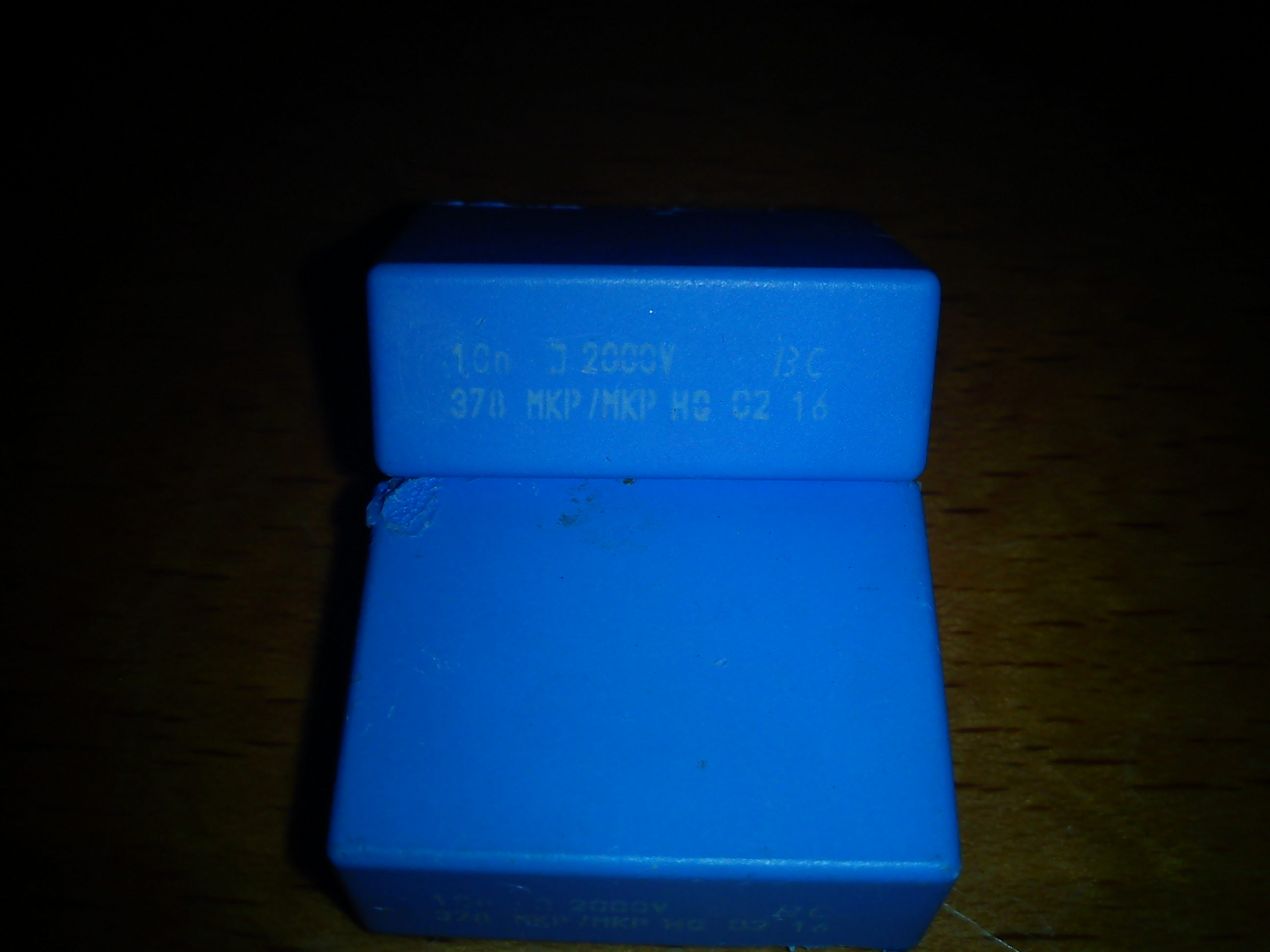

Of course, I experimented with 100n, 47n, 33n, 10n, 1n, 470p, 120p, 40p, 25p, 10p.
I found that the bigger the cap, the more influence it makes in the mids.
In one build I have 10n because It lacked mids.
In the other build I have 10p because I only needed more highs.
The effect also depends on the type of cap. For more presence in the mids I found a good MKP is best. For highs a SM or Teflon is the best.
Fortunately I found these 10nF 2000V:)

Caps pic

Those might be good to bypass the shunt´s output zobel cap (only bypass the cap ... not the zobel)
Of course you use much better film caps there than myself so it might not sound the same... In my case a 10nF // 4u7 on the output zobel enhances mids and highs.
10pF // 4u7 only affects the extreme high freq.
