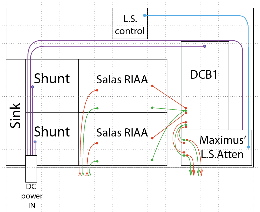

As I've been gathering parts, I thought I should start to do a block layout of the whole RIAA system so I can find a chassis.
Seeing Tea-Bag posting here got me thinking...
To cap-couple to my Lightspeed attenuator (Maximus implementation), I'm going to need some pretty large caps. 2x 5.7uF worth Obbligato's run ~ $60 (1+4.7uF)... getting pricey and will be a major influence in sound.
Well... I do have these DCB1 Hypnotize boards.....! 😀
I could use them in place of the buffers on the Salas, correct?
Attached is a basic block layout. As the DCB1 and LS attenuator were not designed in unison, the signal connections (red and green) look long & a bit messy and could invite ground loops.
I could use the Hypnotize board just as a power supply, and put the DCB1 buffer on the RIAA boards, correct? How do I implement this, just transfer the DCBI buffer circuit to the RIAA?
All AC components will be in a remote chassis. With the RIAA 40v, the LS attenuator 15V and Hypnotize +-10V, thats three supplies I have to remotely route.. Getting a wee bit complex.
Anyway, it's just an idea at this point. Thought I'd post it. I'd love to hear back your comments.

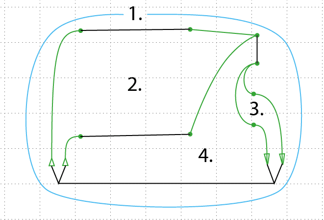

connect the returns on the input together using an external two channel interconnect.
Do the same on the output. Connect both returns together externally with an interconnect.
Now examine only the ground lines. Remove the chassis and PCB outlines and remove all the signals.
How many ground loops are now in your grounding scheme?
Now apply a 50Hz hum field to those loops. It will generate a hum current in the loops.
Does that hum current affect the voltages on any of the audio circuits?

I count 4, correct? See attached. Yes, it would effect the audio circuits. I could eliminate 2 be removing the DCB1, as it's grounds are tied together. Or use 2 bipolar shunts so the grounds are separated.
I can't see how to eliminate the other two...

star grounding gets part way there.
But the separated screens/returns of the interconnects must be very close coupled.
Pity they don't sell figure of 8 screened pairs. The screens in electrical contact from plugs to plugs.
