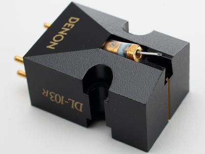

It has been more than a few days, but I finally remembered that I had the cartridge in my briefacse to weigh.
Stock Mounting hardware = 0.6741g
Denon 103R = 8.7520g
measured on a NIST traceable Mettler Lab Scale.
8.5g their advertised net weight spec. At least this one is close. Thanks a lot. Mass figures noted.

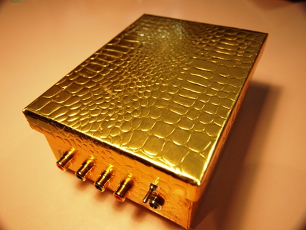

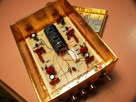

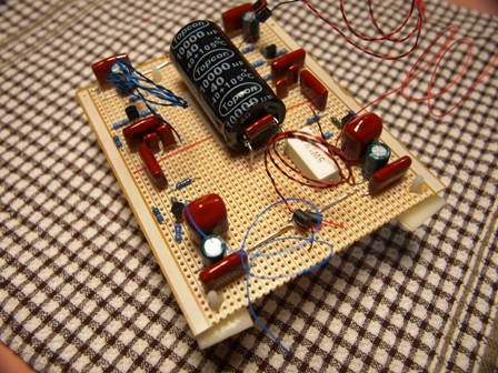

Boozhoundlabs - Le Pacific
I built this because I though the JAN6418 and OPAMP based phono preamps I was using were not giving me the best. This is a huge improvement over the other two.
Constructed on vero-brd. (strip brd.) with all polypropelene capacitors and metal film Rs. Low ESR storage caps (snubbed) and a 10,000uf cap (also snubbed) across the PS fed from a 1ohm 5W R.
Silver solder and wirewrap wire for hookup wire with ferrite beads on all input wires and PS leads. Housed in an embossed gold chocolate box with bitumanised Al foil lining. Currently powered from 3 X 9V lithiums. And sounds absoluty excellent.
This is the boozhoundlabs version of Le Pacific. I like the way he de-couples the PS V+ rail with 10ohm Rs and (in my build) 220uf low ESR caps (snubbed) at each end of the de-coupled rail.
