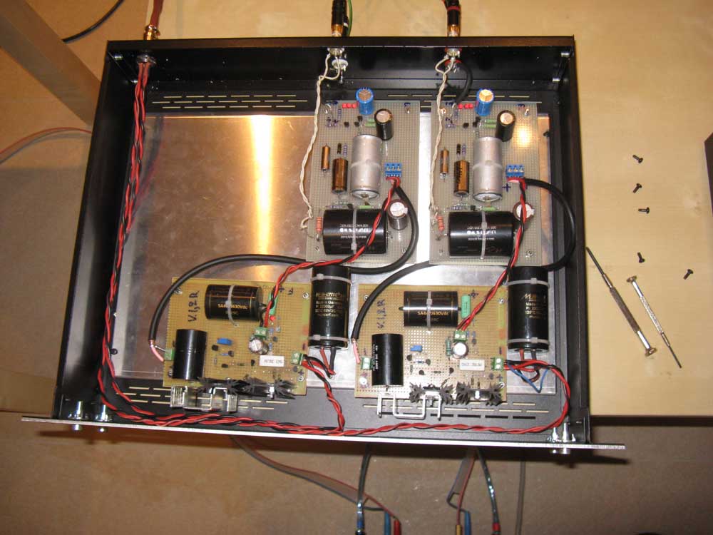

Going well I see, but decouple those long incoming DC twisted pair wires right at the regs input connectors with some 0.1-1uF film cap each, also. I think its good practice. Or you are going to connect the M-Lytics for that?
I will connect the M-Lytics first and see if a film cap makes a difference later.
Ok, I connected everyting and initially both channels were working fine. But after a couple of minutes one channel the leds stoped working. Also DS voltage on Q1 stated to rise. Could you please help? Maybe problem with Q5?

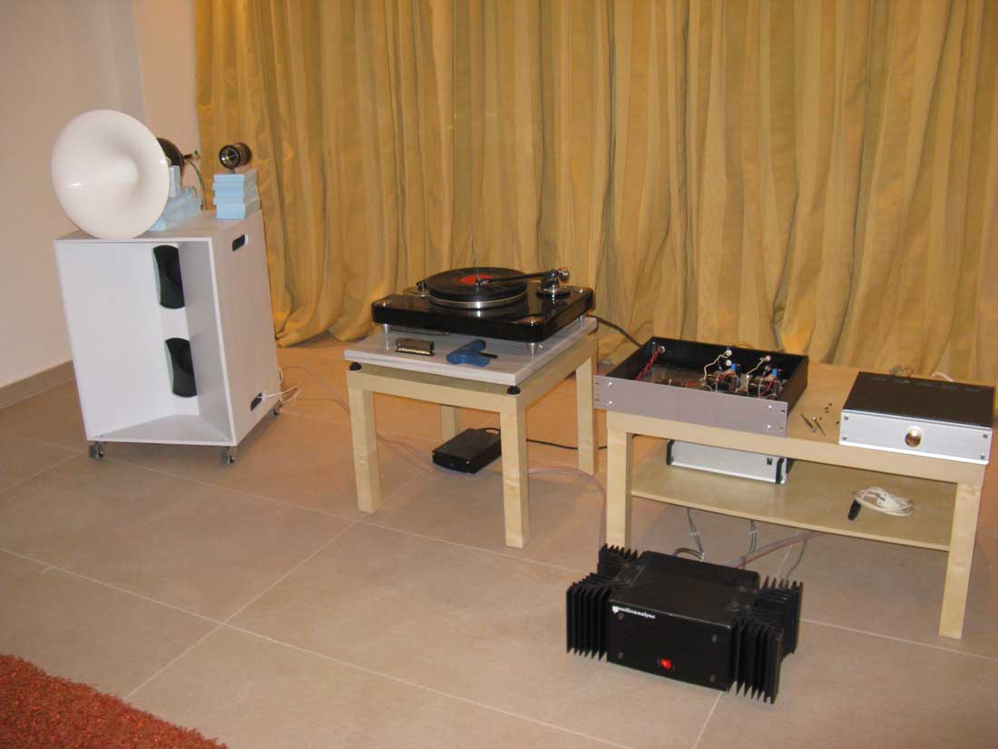

Rest of the system now is VPI Aries1, Shelter 901, RB300 modified, DBC1 to F5 and my speakers GPA 288 with AH4525 horns, Fostex 925 tweeter and dual Eminence 1512 for bass. Estimated sensitivity around 104-105 db. It doesn' t do very low bass though. Also building now a #26 pre.
Thanks Salas for everything!
