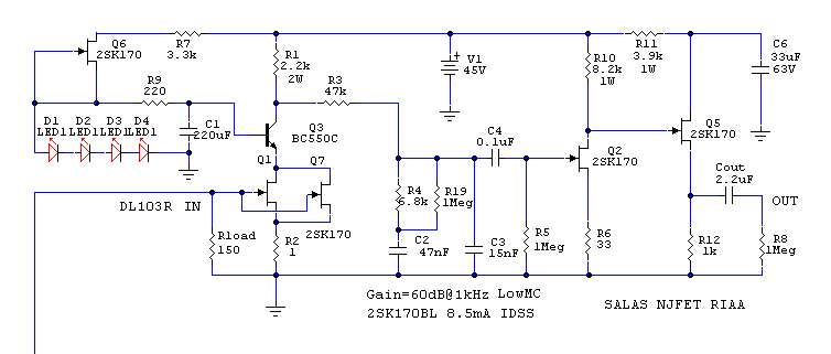

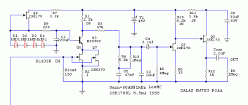

In your schematic, those silmics serve what purpose ?
Like you loved red caps🙂
You better remind your circuit to people too so to can see where your bias measurements apply.😉
I am happy, seems that the balanced RIAA is going on well at first attempt, the set up measurements are in attached Word archive.
Are your Q5s stronger than 8.5mA IDSS? They run 9.2-10mA current. Or Q2 less? You must bring Q2 to GND at 8V. Now its over biasing the output.

8.51, 8.52, 8.53 & 8.54 for 2nd stage for buffer max. 8.49
Since the Jfets are measured OK for IDSS as you say, I can't see another way than to arrange proper R6 changes for all channels to match at 8V Q2 drain to earth, so to work right.
