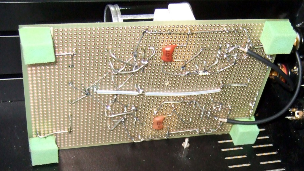

And...do you have a picture of PCB downside from Picture at Posting 4628?

Photo from a doubled Jfet 58dB (4628). The little caps and one resistor are to bring some values to 100% nominal & matching. The whole phono is 100% matched everywhere. Active & passive parts, plus THD, Riaa curves and gain. Much work, crazy left over volume for Jfets and Riaa caps.
