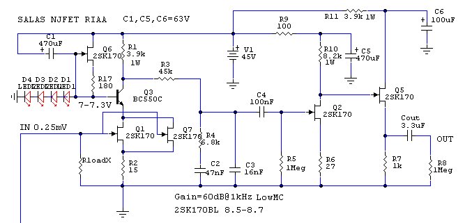

First of all thanks all of you about this topic!
I'd like to try build this riaa and I have couple of questions.

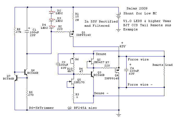

I use MM cartridge so what's the newest schematic for MM riaa and newest shunt psu?
I'm on page 211 and is found some schematics, to MM riaa page 182 and shunt page 25.
Is the r6 mod now on the shunt psu schematic?
I'm trying to understand what I have read, but I'm beginner on these..
Thanks!
-Jake

Don't worry Jake, simply follows all the Salas advices & you do it like me.
propably have to start thinking about buying denon dl-103.. there's so much talk about that one.. what's the schemathic for that?
1st one on page 182 you linked, same reg as above but with 3k3 R10, 35V in, trim for 25V out.
Is it too much to ask if you are able to draw it? so that I don't mess it up. :/
sorry for trouble..
sorry for trouble..
Exactly like the reg in post #3655 above. Only 35V DC instead of 55V DC input, Q5 7-8mA IDSS 2SK170, R10=3.3k or 2k7. You start the trimmer at its lowest and turn until 25V Out. Q2 can also be a 2SK170 for just 25V reg. There is nothing to redraw.
