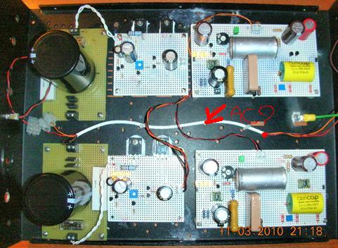

Ok let me arrange to operate only with one regulator an I will post the photo. Salas again many thanks for your kind & friendly help.

As promised a photo with one Salas Super-Shunt regulator feeding two Salas Phono RIAA.
Which Xfrm did you order from Mouser? 229D40?
Yes like tese two:
Workable for now, nice clean build with very good components in general. Of course shorter cables later when with two shunts operating will be better, and then remote sensing of course. How did you kill one tx by the way? If you experience any hum from GND loops, or from the AC cabling running across meanwhile don't pay much attention before you would have the final arrangemend to debug anyway. Have a happy initial listening. Good job.

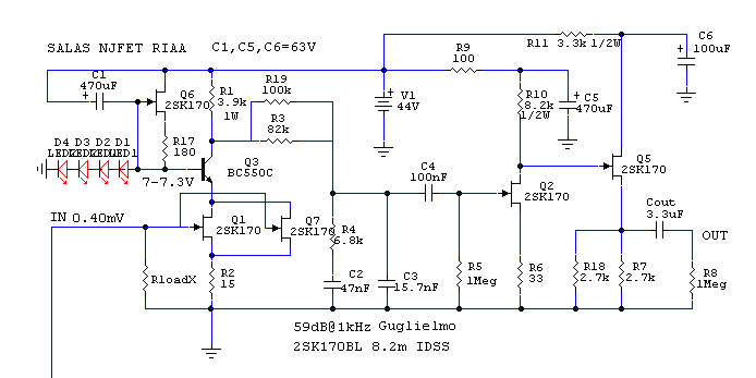

Hello Salas,
I've selected the 2sk170 for the circuit of the post 2795 and they are from 8,1 to 8,3 mA selected in pairs plus one quad for the first stage Q1 Q7.
My input is 0,4mV and i don't use C10.
How I must modificate the resistors of the schematic for the correct gain?
Thanks a lot

Thanks, I have no room in Tx boox to mount the PS, the idea is in one box the regs. & phono & in other box the Tx & PS. I kill the Tx due to a wrong connection (are dual: primary 115-230 & secondary 20V/2.4A-40V/1.2A so I wired wrong) & when connected the Tx do a lot of noise. Tomorrow I will hear.

but as you use two box ,why put the AC on signal box ?

Thks, it's provisional, I don't have room in the Tx boox, mine idea is 2 boxes, one for regs. & phono & the other for PS & Tx as usually do.
can arrange the rectification/cap filter boards in the external box with the transformers latter on i guess.
yes.

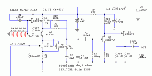

Hello Salas,
Thanks a lot
Guglielmo
Here you are, for your special situation.
