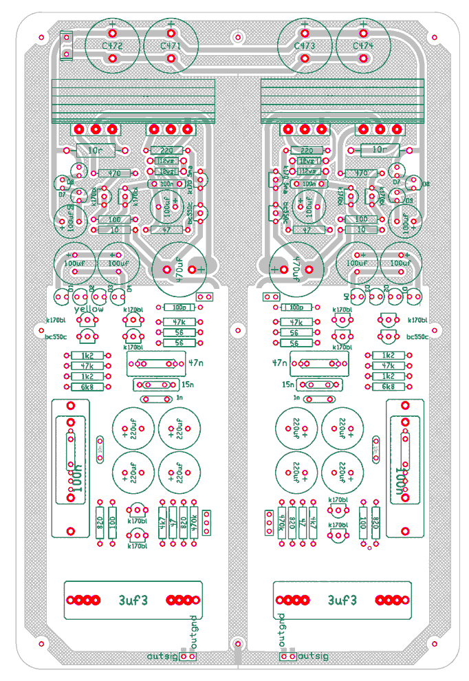

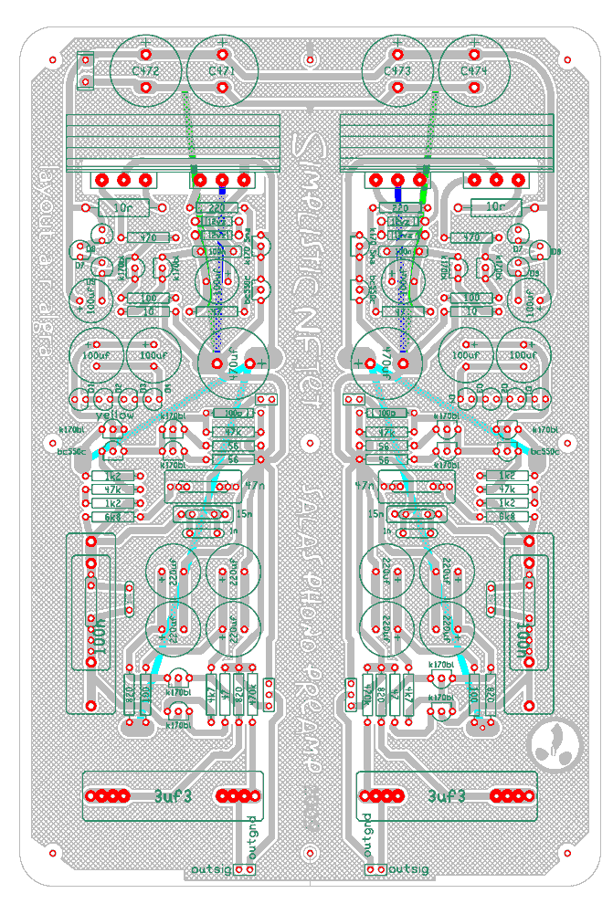

Hi Salas an d everbody else.
Ive made to new pcblayouts I think it will be a great improvement over the previous one. Probably there are people who want the regulator further from the circuit but on my experience with building my akidopreamp I liked it when the regulator is as close to the audiocircuit as possible, nice fast transients.
Ive anybody has some ideas to improve let me know.
Roy
Roy
I also made an version for people who want to hardwire the the audiocircuit with say silverwire. Its the same concept I used on my akido. And its works fine. This layout is at the monent just to give you an quick impression. I want to make pads very small so when you drill the holes the copper will vanish. And there will be a large pad for grounding. I will let you know.
How many people out there etch ther own pcb"s. Its really quite simpel.
Roy

Hi Royroy algra said:on my experience with building my akidopreamp I liked it when the regulator is as close to the audiocircuit as possible, nice fast transients.
I fully agree with your oppinion... the reg near the circuit improves transient behaviour.
Have you already built this circuit ?
Ricardo
Hi Ricardo,
Well no,
I want to buid it next week, I have to wait for some components I ordered and I want to make a small layout for the filters jaap suggested so It will be possible to etch it together on one board.
With regards, Roy
PS.The newlayoutdesigns will be incorparated in the rapidsharefile made by Psqr.
Well no,
With regards, Roy

hi,
@ Roy - Is this your final PCB layout ?
Can you also give the dimensions and lead spacing for the capacitors.
Pete
Pete
