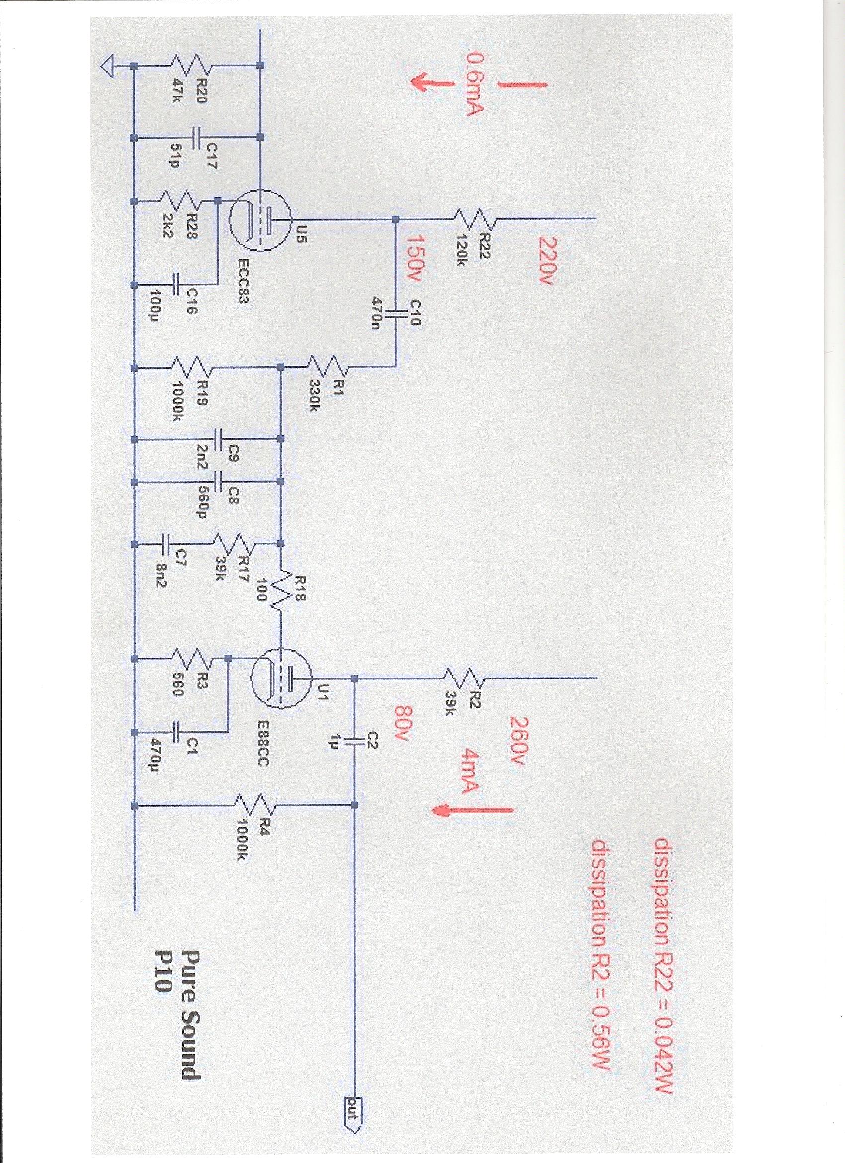

Why don't work the HV shunt with this phono Puresound P10
Just curious, the manufacturer said that works with tube shunt regulators

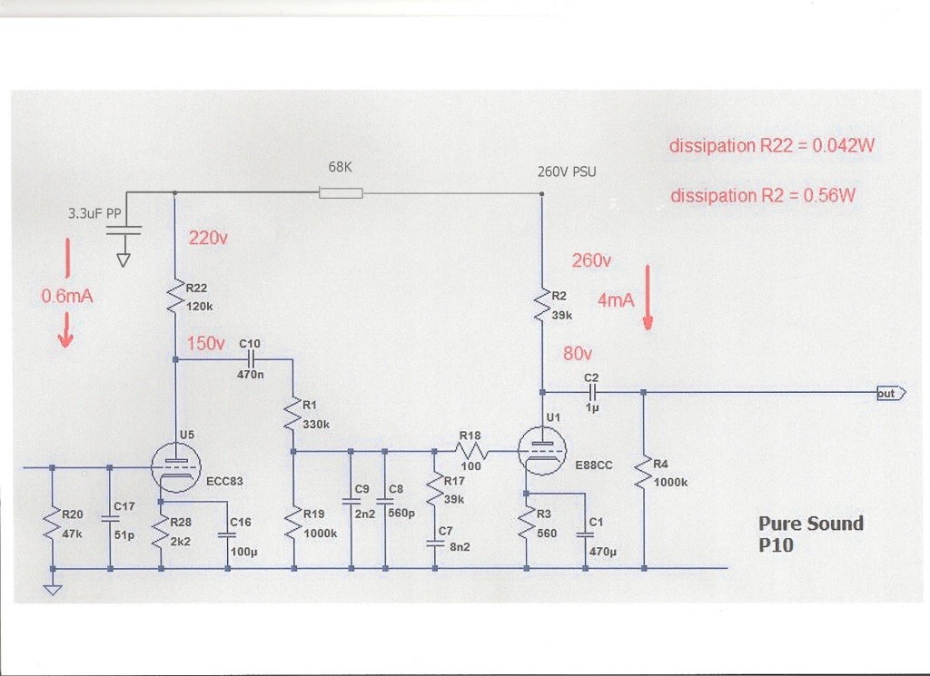

What do you mean it does not work with it? I see a normal common cathode with resistive anode load 2 stage circuit. Can't imagine what would exclude any regulator feeding it. Just assemble your circuit as it is drawn and use PSU voltage values exactly as written on it.
I used your schematic so I added 68K & 4.7uF instead 3.3uF to drop till 220V but the voltages measurements are:
CCS 260V both channels
ECC83
between 120K & 68K must be 220V and I have
L 206V
R 206V
between 120K & C10 must be 150V and I have
L 129V
R 133V
ECC88
between 39K & C2 must be 80V and I have
L 100V
R 102V
Of course I don't have sound so don't works.

did you wire that point to point?
measure your plate voltage, reading from plate to cathode....
Yes wired point to point, plate-cathode measurements:
ECC88
L 99V
R 101V
ECC83
L 139V
R 143V

your tube sections seems to be even.....you should have sound, maybe a break in connections somewhere...please recheck your wiring's and/or have someone look at your work, sometimes he will see soemthing you might have missed...

Beyond that the noted currents are not exact, leading to different DC drops, biasing looks like working.
Sorry for my ignorance, wich pin heater is the positive & negative for ECC83 because original Puresound as soldered togheter pin 4 & 5 to one heater & pin 9 to the other heater, I mind positive heater is 4 & 5 togheter?
