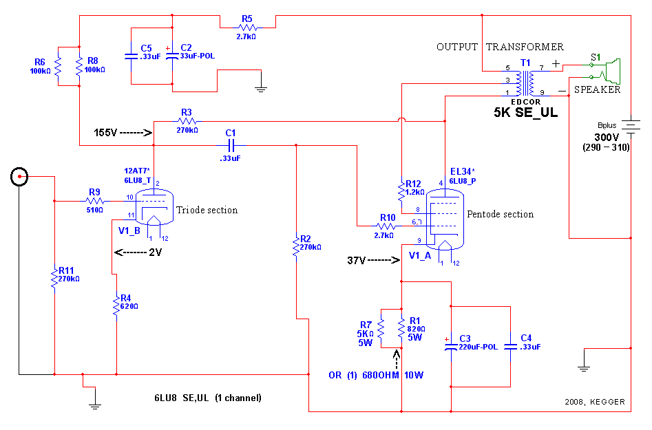

Here's the schematic.
I haven't measured the current draw in a while, but I think it's around 120mA total, for the amp.
As for the jfet under the driver bjt, are you referring to R4 in this schematic?
Yes, I have replaced R4 with a jfet, but since the thing didn't work properly, I reverted to a resistor until I see it walk, then we can make it fly with a jfet 🙂

Aha, so this is a proper low power SE amp that you use for headphones. Grado? With 120mA class A load, I would set the shunt at 200mA with 350V input after CRC or CLC prefilter, 300V out. We are talking 60W constant consumption for the tarfo, 10W dissipation on the IRFP and 24W on the 840 with load attached. 200VA trafo at least. I know, the sound will be awesome with a power amp fully shunt regulated. But economically and environmentally...Kyoto protocol issued to Iko. 😀
ikoflexer said:As for the jfet under the driver bjt, are you referring to R4 in this schematic?
Yes, its R4 in all schematics. The schematics are the same basically, the R values or proper voltage PNP BJT type change due to different voltage or consumption scaling for individual needs.
I'm very happy with my sony mdr-v6 headphones. A friend has a pair of good Grados and we compared; I saw no reason to move. Yes, other people use this amp with the edcor OTs and speakers. I modified the amp slightly to accommodate a couple of 250V-6V power trafos (tested for frequency response) which proved a great match for the sony headphones (impedance around 60R). The amp is not on the sweet and syrupy side, rather sounds detailed, fast, and furious 😀
