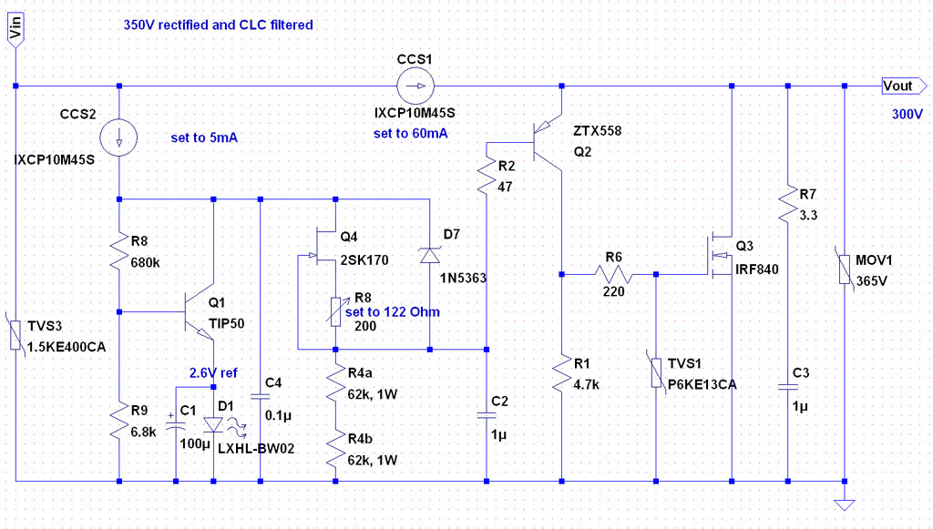

Why don't you just lift Vbe with a bypassed resistor if engulfing the FET in higher VDS is your goal, and keep a single common CCS? That example in the pic could give you 7-8V for instance. Saves you a great deal of headaches and its lower parts count.
Have tried your suggestion and have also used low impedance capacitor as you suggested. Here is my observation: Vout took forever to stabilize after energization; ripple content worsen under actual dynamic loading condition; the Aikido pre-amp that being fed by this reg setup sounded very lay back and unusually slow. Basically the reg seem imposted too much of its own character onto the load (the Aikido pre-amp), interesting. This is not my first time using Aikido pre-amp, by the way.
Because of that I reverted to my previous circuit setup but with additional enhancement as shown in the attachment. The result was a very satisfactory one. I didn't know how the original design sounded like as I didn't have the necessary parts to build one but this one is good enough for me. At least, I don't need to worry about any power component may fail on me for no apparent reason as the CCS is fully rated and the gate of Q3 is protected. I bet the original design would have sounded even better given sheer amount of compliment and positive reviews posted in this thread.
Thanks again for your inspiration and comments all along, Salas.
Since that experiment with the capacitor and resistor lift you examined worsened the results, obviously you did well to revert to your double CCS version. I keep the result of the Vbe lift as a no good option, not to be considered for changing the standard design. Thanks for the feedback. Enjoy your system, since its nicely sounding & steady with your reg as it is configured.

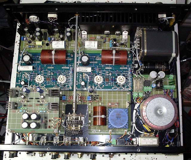

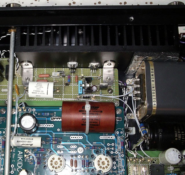

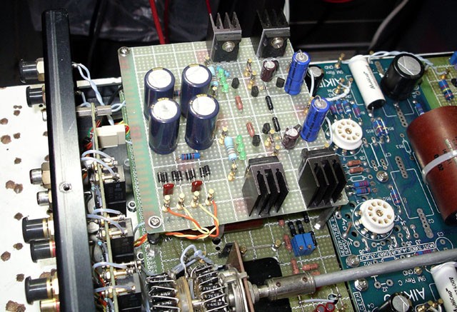

Attached is the result of the whole project. The one on the left is the HV Shunt Reg, and the middle one is the Bipolar LV Shunt Reg.
